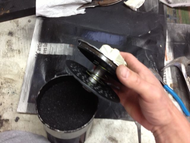

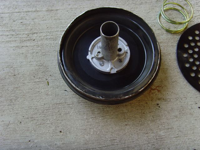

The process -
Grind the rim off the canister to grain inside access
Pop it open
Drill a ~1/4" hole on the tank side where you see the ball
Dump the ball out and make sure the passage is clear
Replace the active carbon inside
Reassemble the canister
Press the top in place and tack weld close
Paint the cut line to keep everything pretty
Never worry about your canister again.

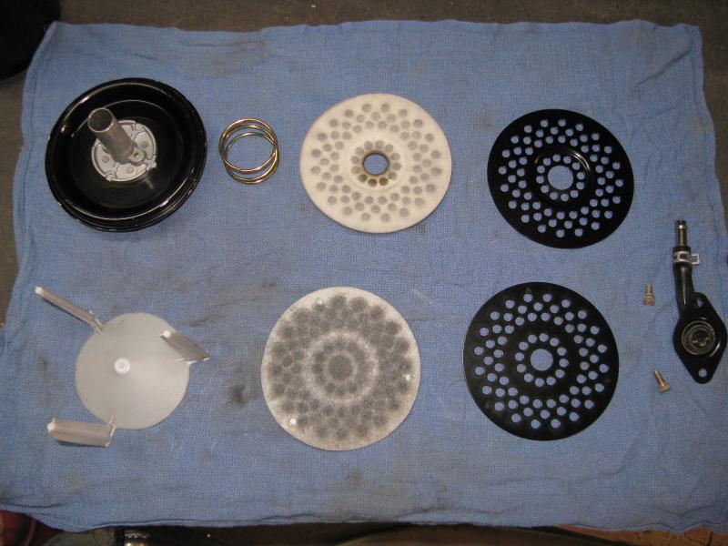

I used a few drops of Oil Eater in each port and let it soak for 5 mins at first Then took a few q-tips and ran them in and out of the ports. Then repeated 3 or 4 times extending the soak time each time, trying to listen for or feel thru the q-tip the ball bearing. I'd intended to keep the liquid out of the can by orienting the ports to the ground for the soaking bit. This worked mostly, except once i got too exhuberant with the dropper and ran some oil eater through it. It wasn't much...but it flowed straight through and out the bottom port IIRC. Let the can sit with ports open to the air overnight and put it all back together. Haven't had the issue since, over a year ago (OEM can, guessing vintage '93 but don't know for sure, 285kmi).
edit:'Smitty' is not a DD, so YMMV. And this certainly isn't an alternative to drilling method. Prob just a band-aid at most.
Open the oem can, remove and replace charcoal, clean check valves. Simple, and it solved my problem of gas fume smells, hissing at fill up, and most importantly the spewing forth of multiple gallons of gasoline from the filler neck during the summer after large elevation gains....
