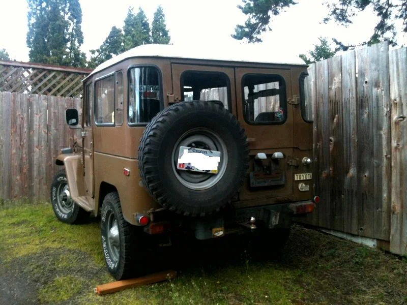

1978 FJ40 I believe all pretty much original and a 2 owner truck. Runs amazing for 169K and drives great. The rust is not as bad as others I looked at and needs some cosmetic stuff done.
Any suggestions would be gladly taken and anything I should know or do as well.

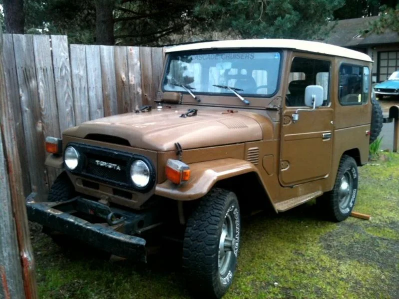

It has disc brakes in the front but the brakes are tough to push down and don't stop as great as other trucks I drove. PO said something about power assist????
Better pics to come.
Looks great.:D I bet the color would even out with a good wax job:hillbilly:
The most likely issue with the brakes is the vacuum booster. The diaphragm or seal is likely leaking. There are many options for replacement... I can't comment the newer options. I replaced mine with a newer 40 one about 17 years ago.
Waxing this weekend and thanks for the booster advice. Is the bezel supposed to be black or a different color?
Nice looking cruiser. For brake power assist, first check the vacuum to the brake booster and make sure you are getting good vaccum there. If not, fix clean carbon out of vaccum fitting on engine side. More likely problem is with booster leaking, but I've seen carboned up fittings on later 2F engines that kept the brakes from working as they should.

Rear wheel cylinders may be frozen and might not be helping the stopping at all. Try to adjust your rear brakes and if you can't turn the adjusters from behind the backing plate they're probably frozen and will need to be replaced or upgraded to discs.

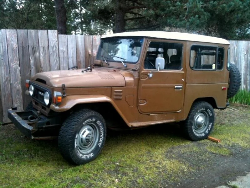

Looks like there's been some touch-up painting going on. The quarter in that very first photo looks like unwaxed 653 to me. The rest of the brown looks - too brown. Did you check the tub for a paint code? And the hood looks like something else again.
