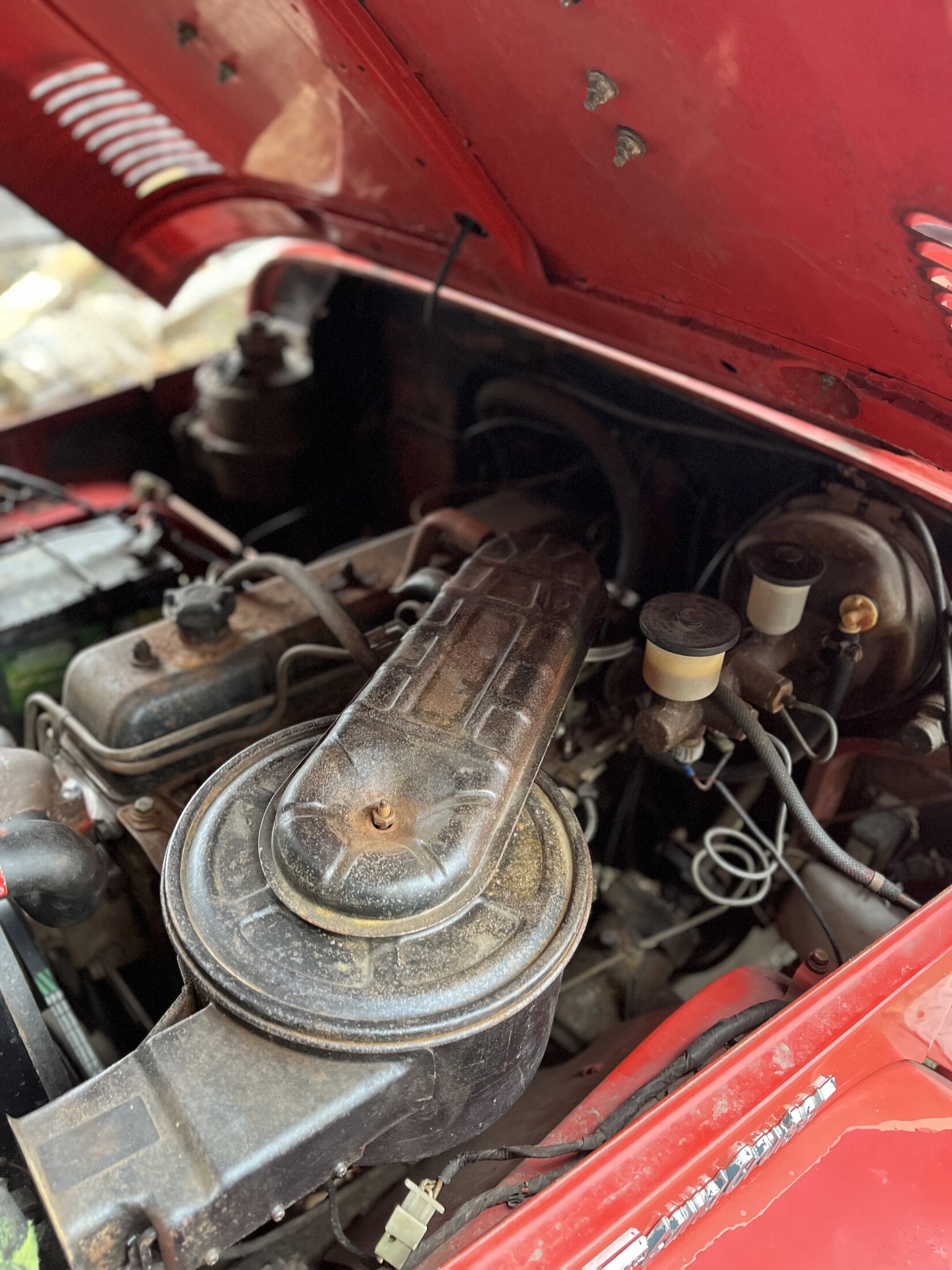

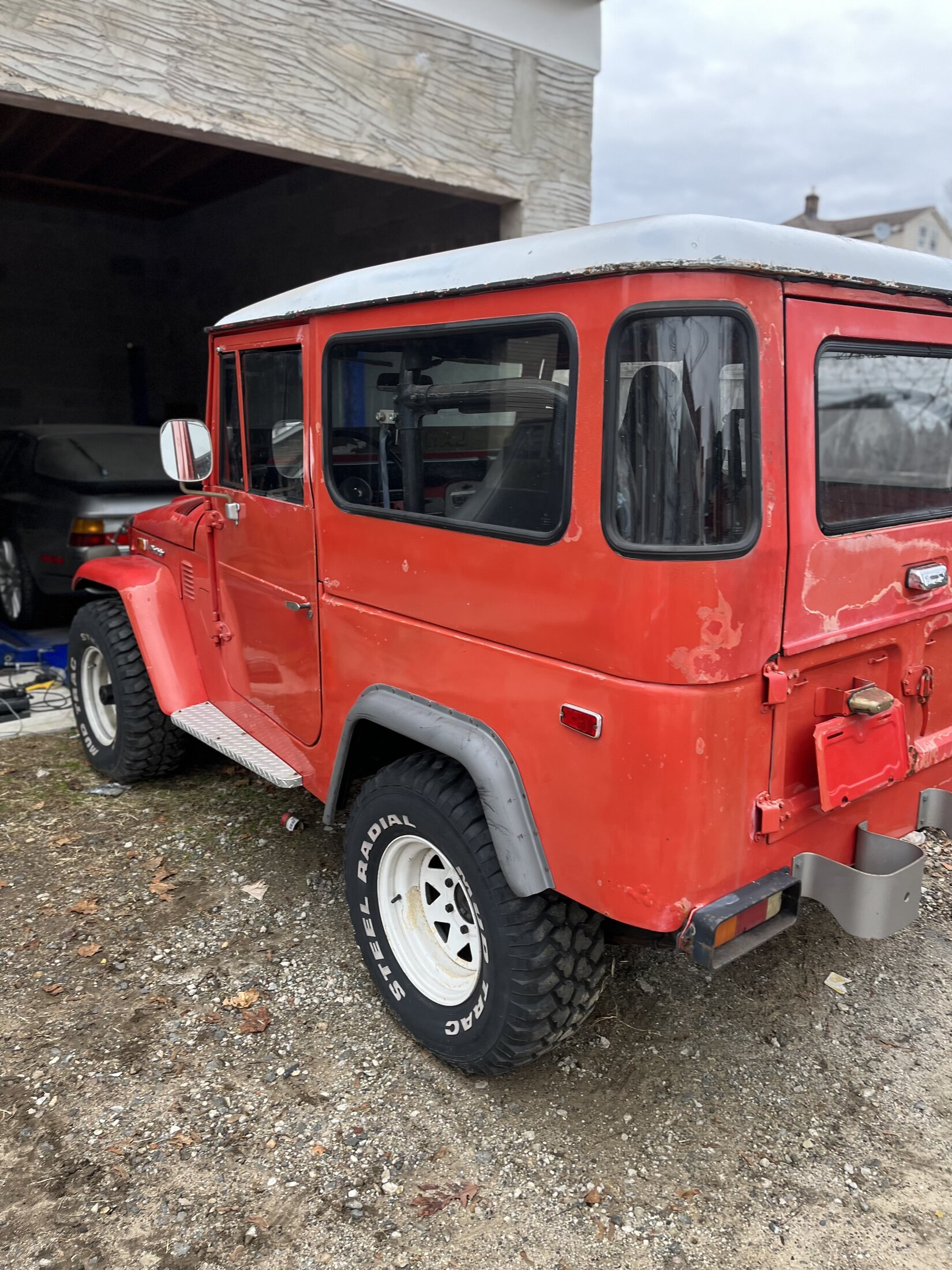

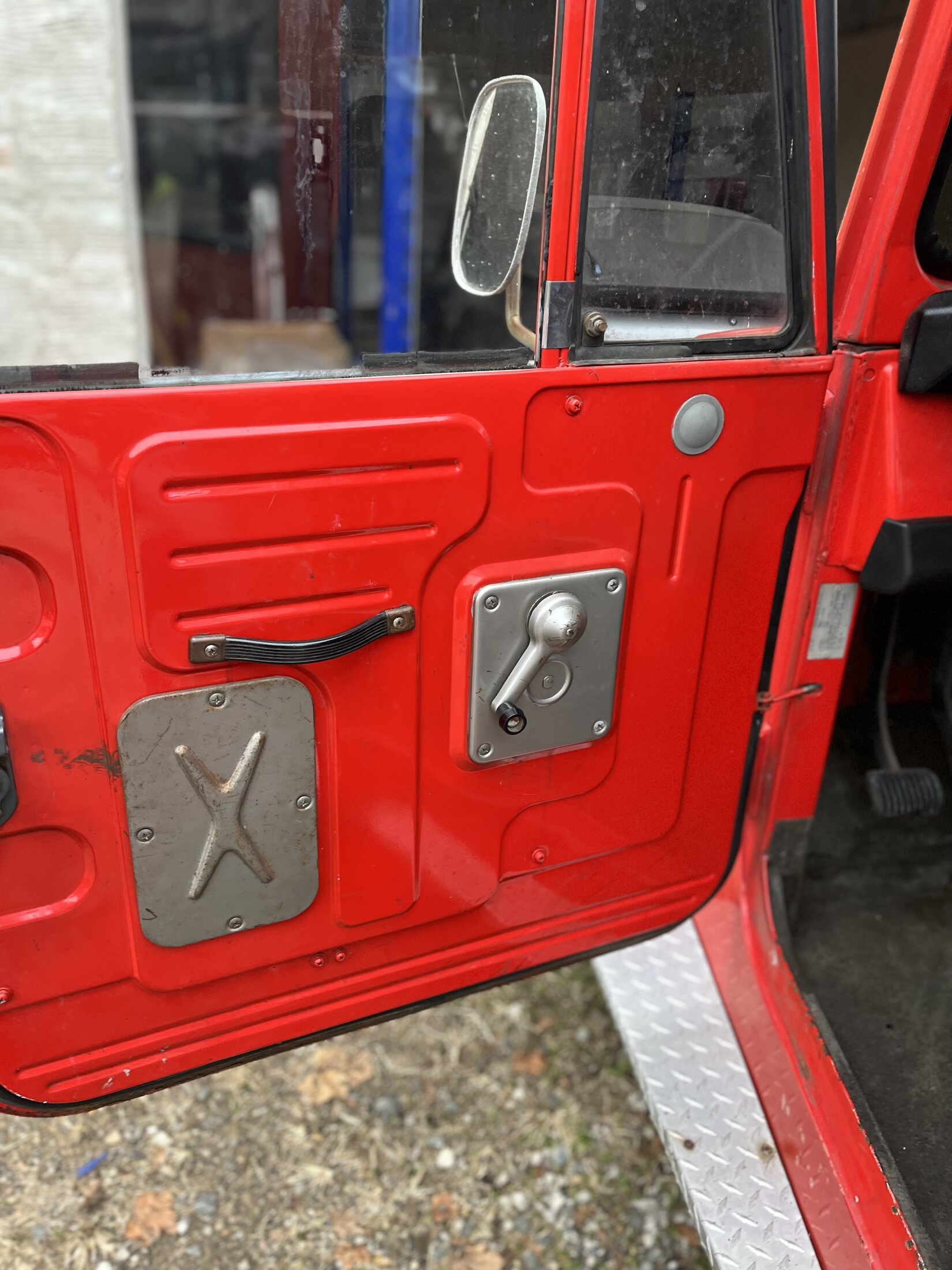

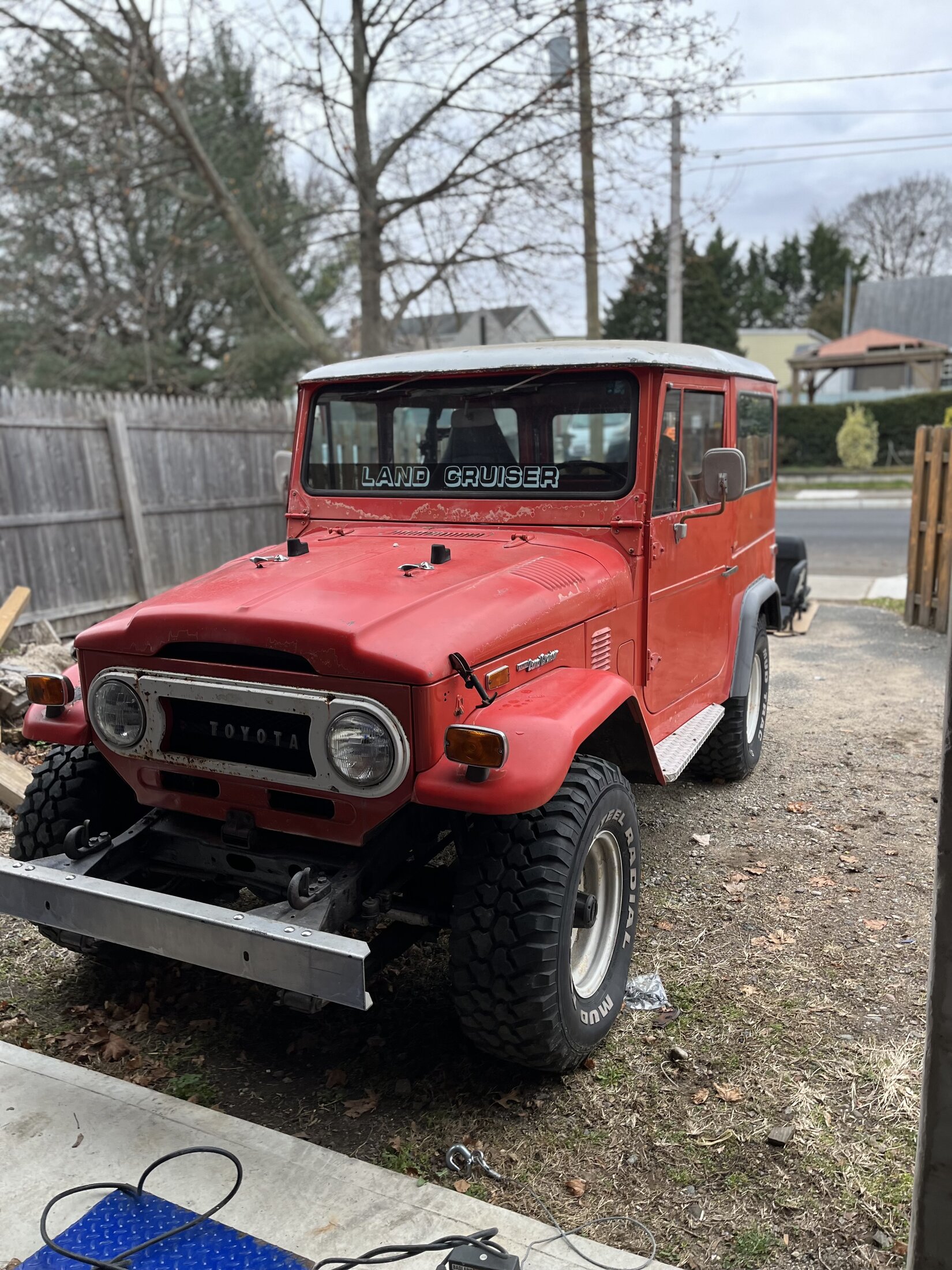

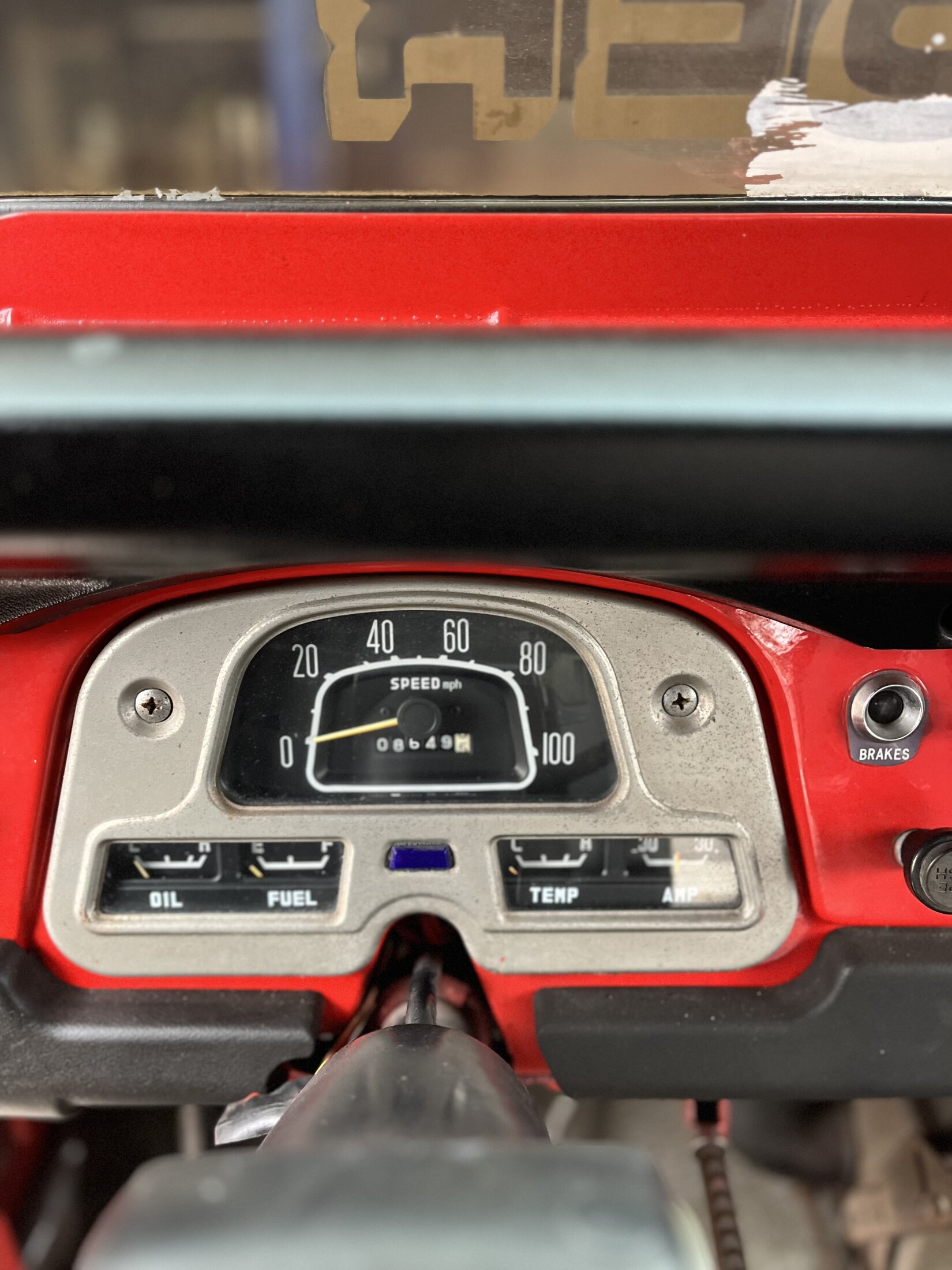

Been looking for years and came across this one. Seems like a decent rig. Paint needs work. Looking for any obvious problems or issues. It's about 5 hours away so I'm going off the pics/video but price seems reasonable $25k. Any thoughts are greatly appreciated.

More than I would pay, but it could be a steal. So what year >75 by the doors. 3 or 4 speed? Front brake master is low and has been for a long time. There is rust blisters at the back - could be tons of bondo everywhere. Take a magnet with you when you go look. Test every gear and the brakes both forward and reverse. Test the fans, lights, wipers. A dry and then a wet compression test would be nice.

It’s far from original. $25k to me implies some above average condition or strict originality. Front and rear doors, fender marker lights and engine place it 72-73 I think, but apron emblems are later than that, 75 and post. Tail lights are 74 and later. I guess it could be a 74. Still seems like an assemblage.

The rear sill is totally whacko - sheet metal where the frame should be! Not the worst I've seen, but nowhere near worth 25K.

I think 8k is probably low also, but it's close. That thing has had multiple repaints, the rear wheel openings have been cut with fender flairs. As mentioned weird sheet metal covering the rear crossmember, it has an extra radio slot cut in the dash. Aluminum running boards. There's no telling what it's hiding.

With that body work, I don’t think there is a reasonable price. It’s not just correcting what is seen in the photos, you also need to fix what was really wrong 10 years ago that lead someone to do what you see here. There’s an easy 10-15k in body work hiding on that one. Maybe more. And probably some frame work too.
You’d be better off with a good body roller, and 10-15k shop time to fix it up mechanically.
