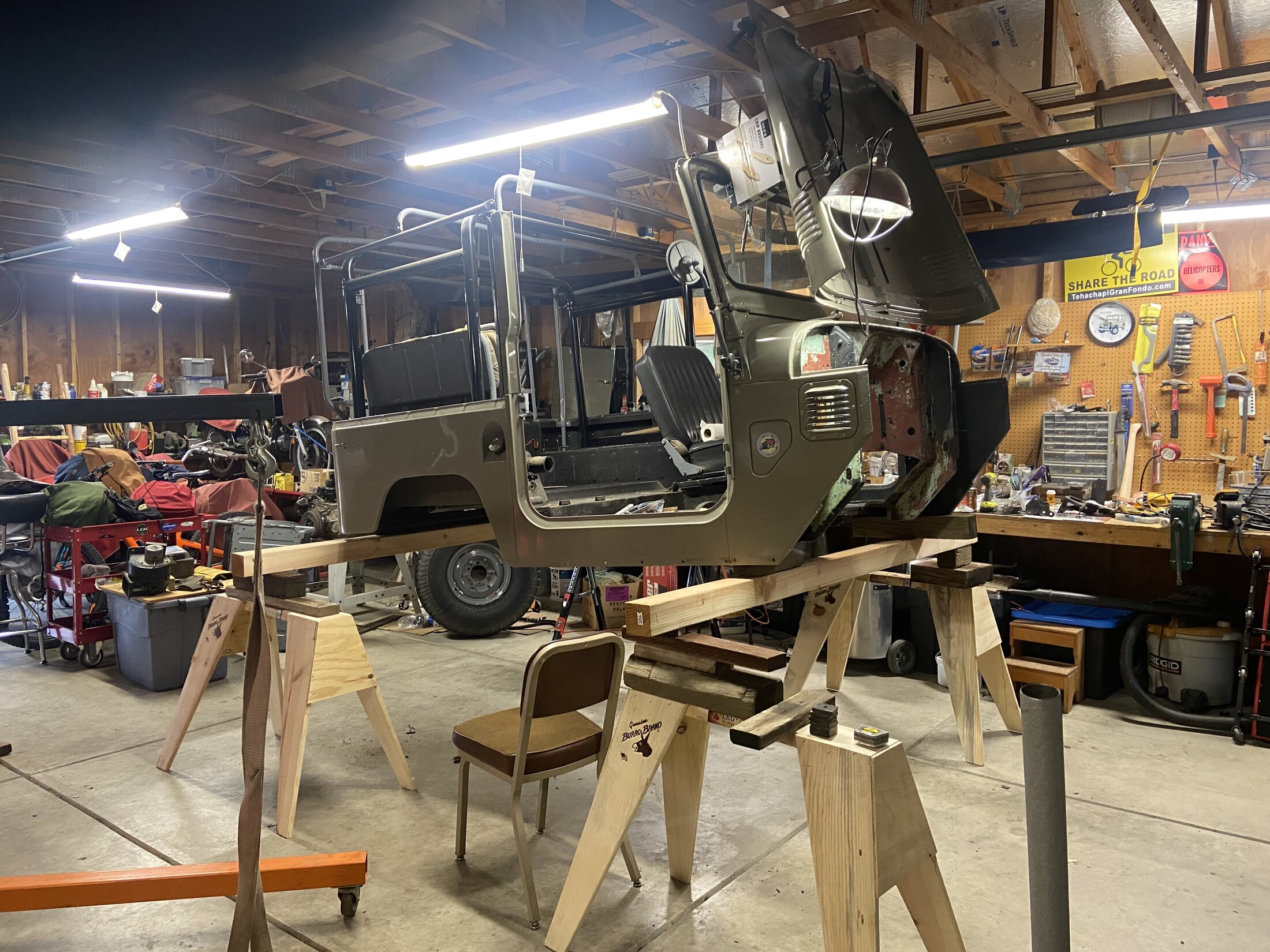

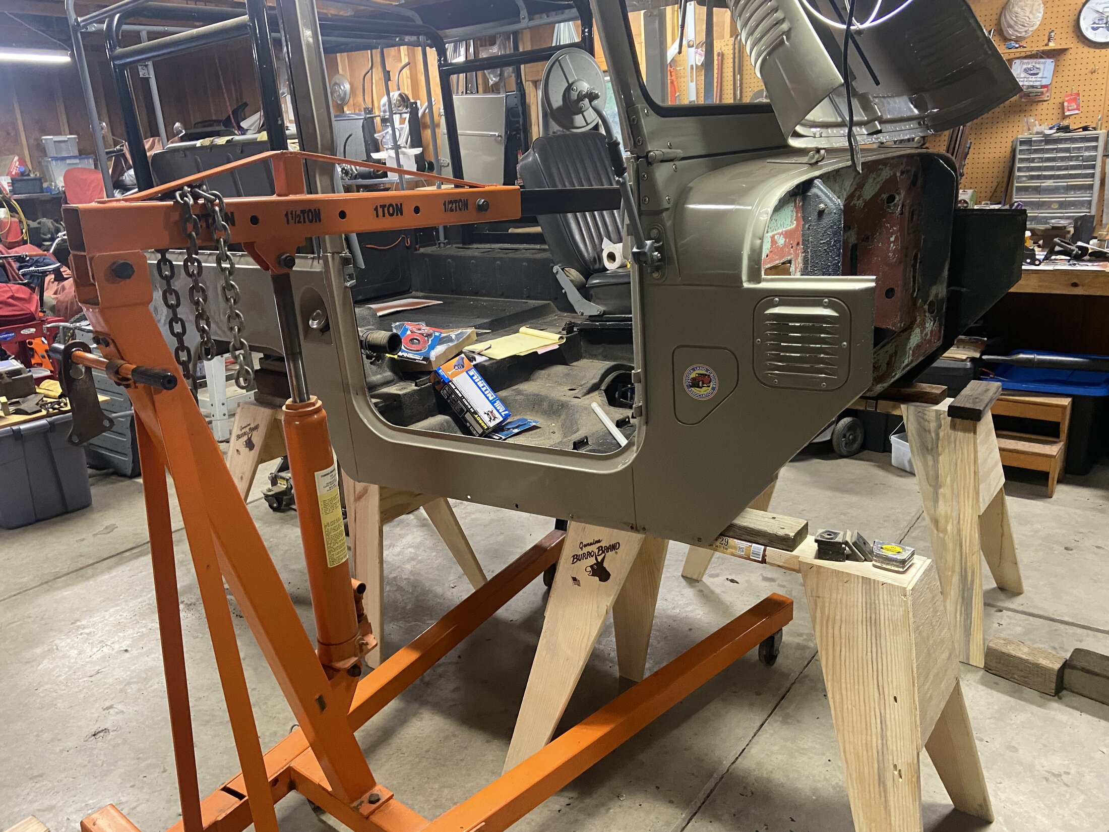

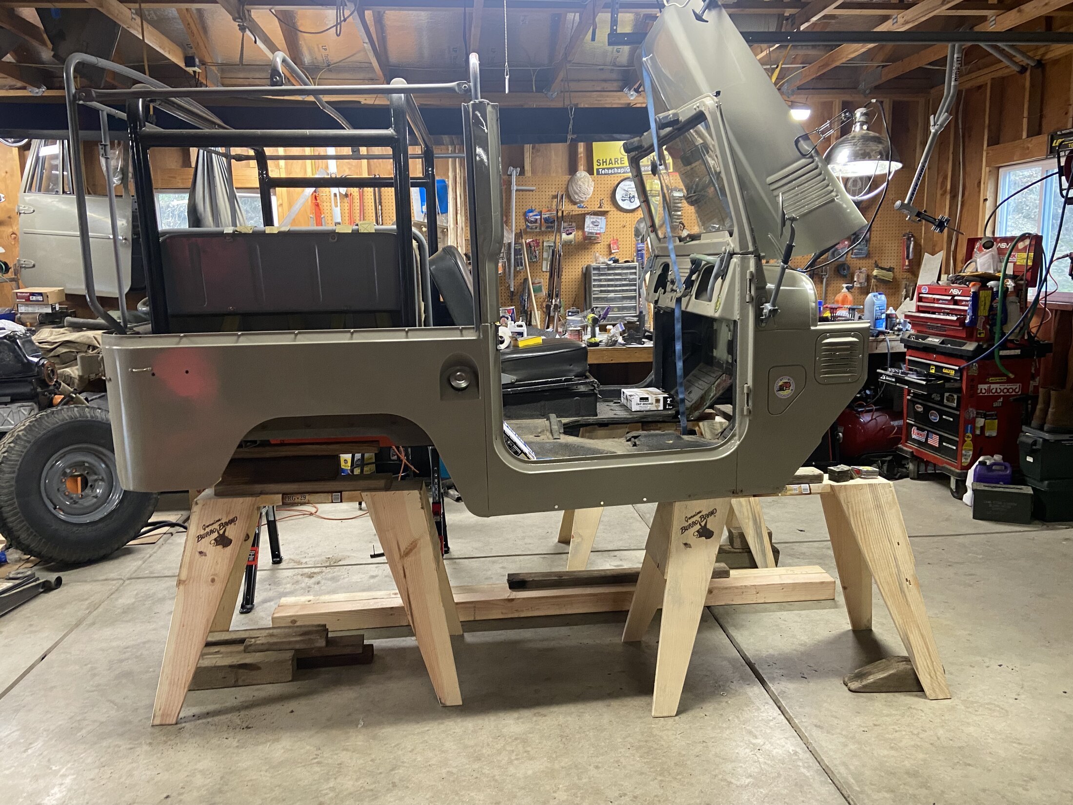

I didn’t either. I used 4x4’s, an engine lift,
a floor jack and saw horses to lift it. Hardest part was clearing the 33” tall tires. I figured if the Egyptians could build a pyramid, I could lift a tub. Once I had the frame rolled out I slid the saw horses in and worked on the tub.
If it looks a bit sketchy….it was.
Would have been easier if I stripped it down a little more.
I didn’t either. I used 4x4’s, an engine lift, View attachment 3750894a floor jack and saw horses to lift it. Hardest part was clearing the 33” tall tires. I figured if the Egyptians could build a pyramid, I could lift a tub. Once I had the frame rolled out I slid the saw horses in and worked on the tub.View attachment 3750896
