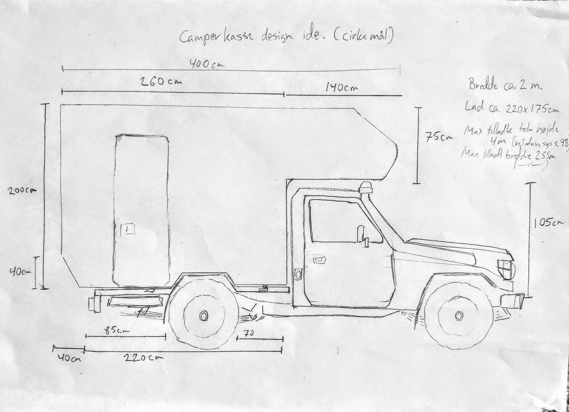

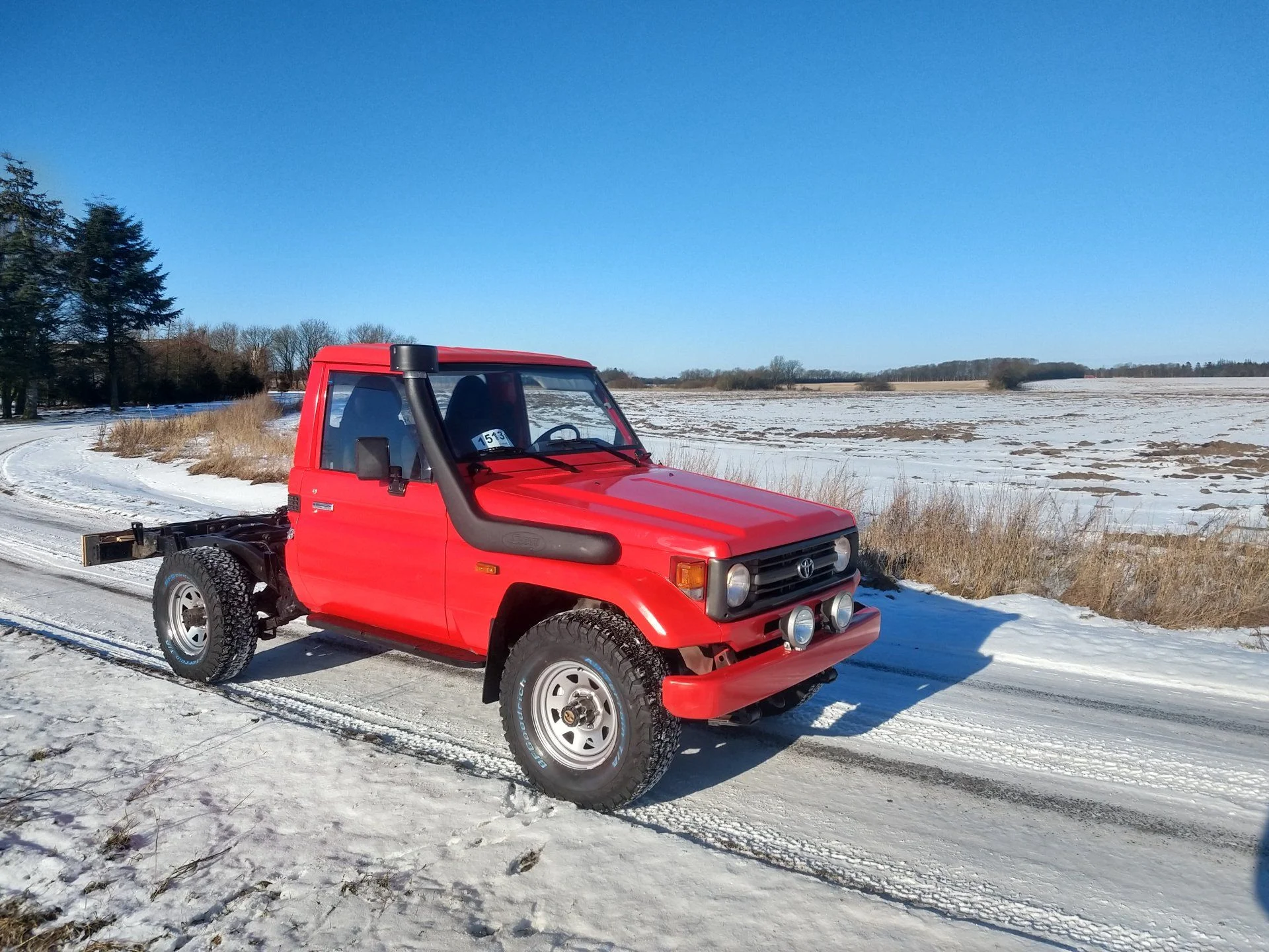

I am building an overland camper on the base of a 1994 HZJ75 pickup.
The camper box will be demountable, so I will also be using the truck without the heavy camper box.
I just weighed my truck and it is 2100kg unloaded, but with the camper box it will be more like 3000kg

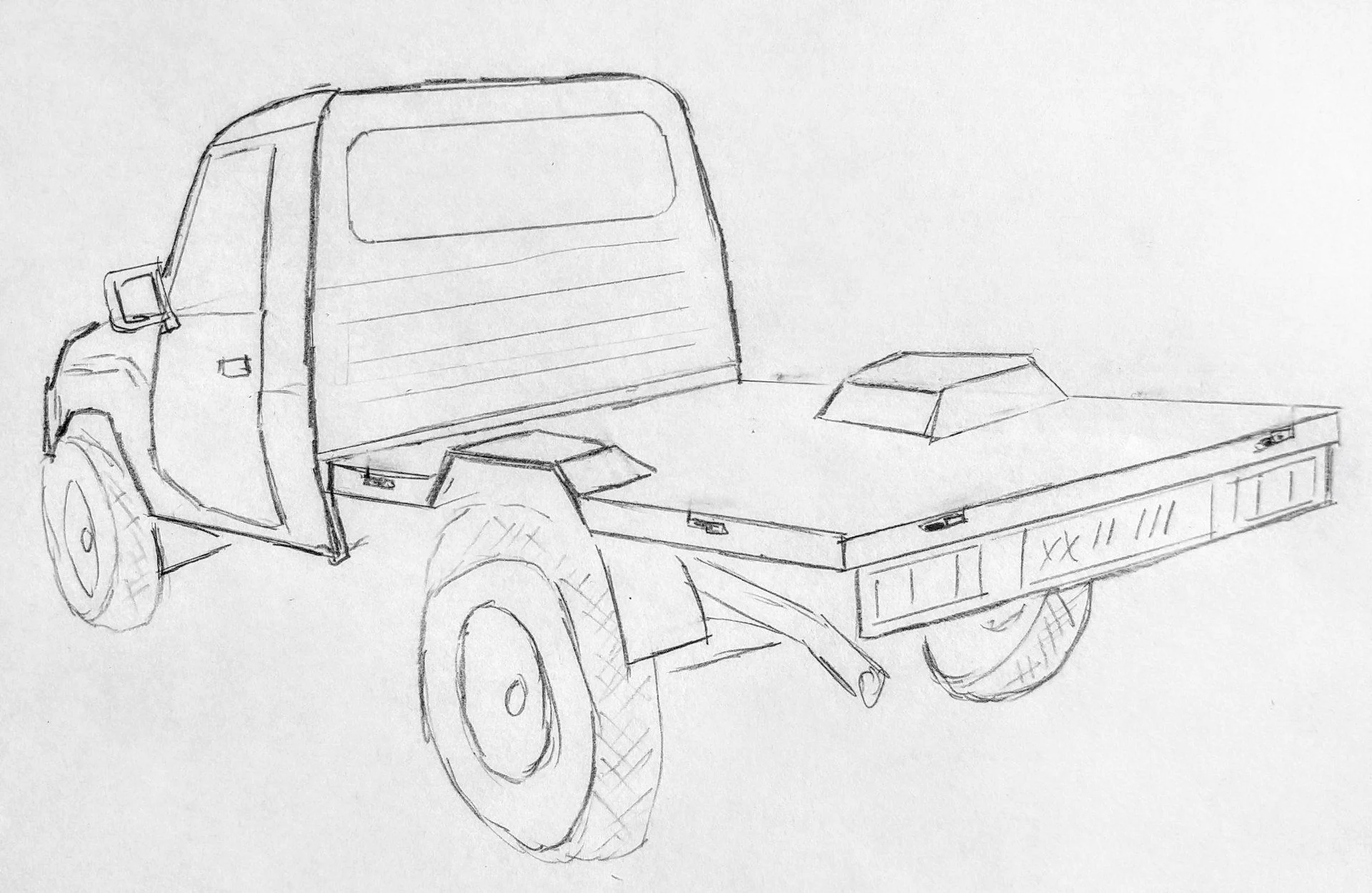

From the pictures your truck appears to have the 10 leaf setup. Yes, it is harsh, but it handles loads such as a camper very well. There is an 8 leaf setup, if I remember correctly, but there is not much difference.
