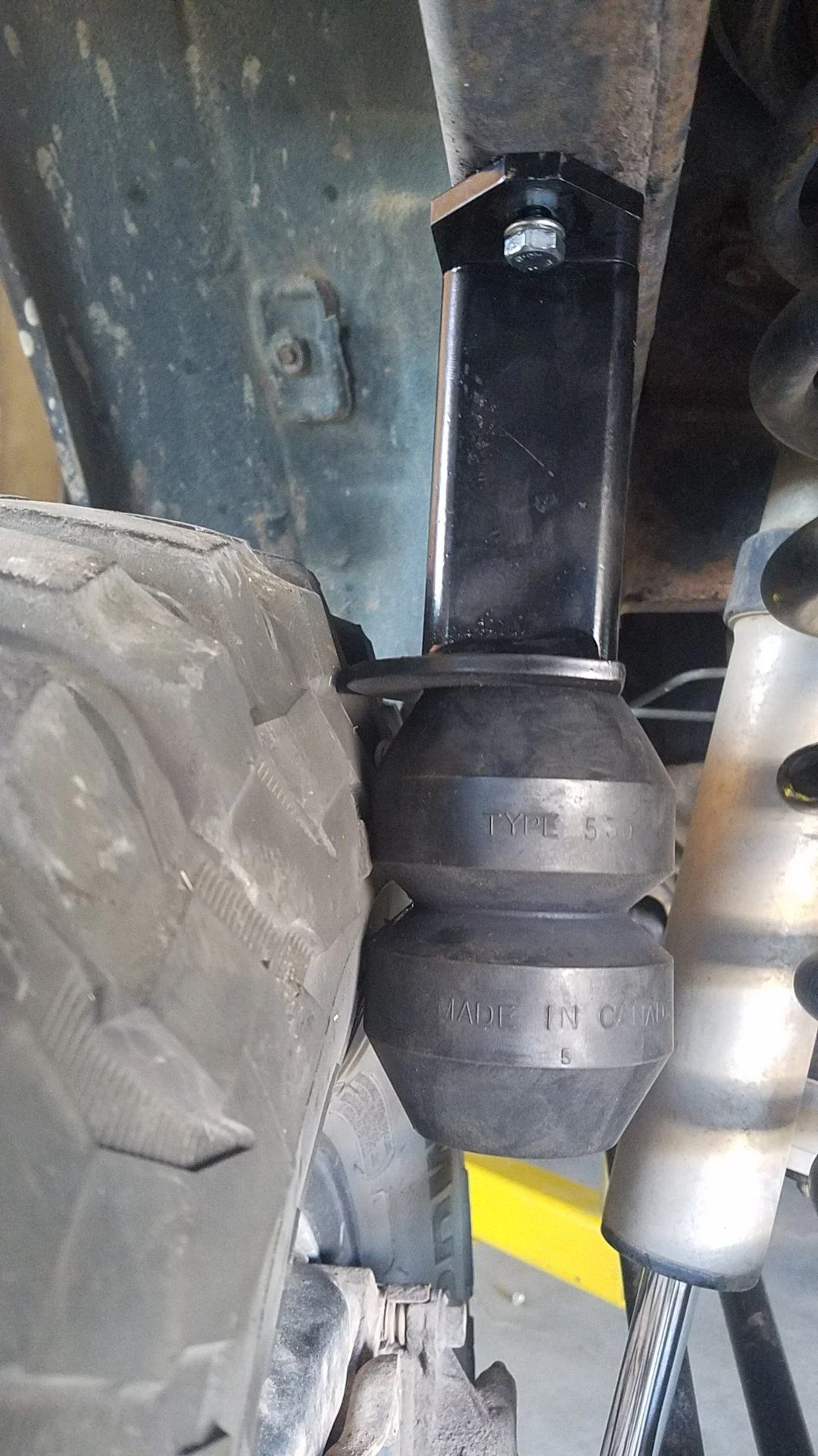

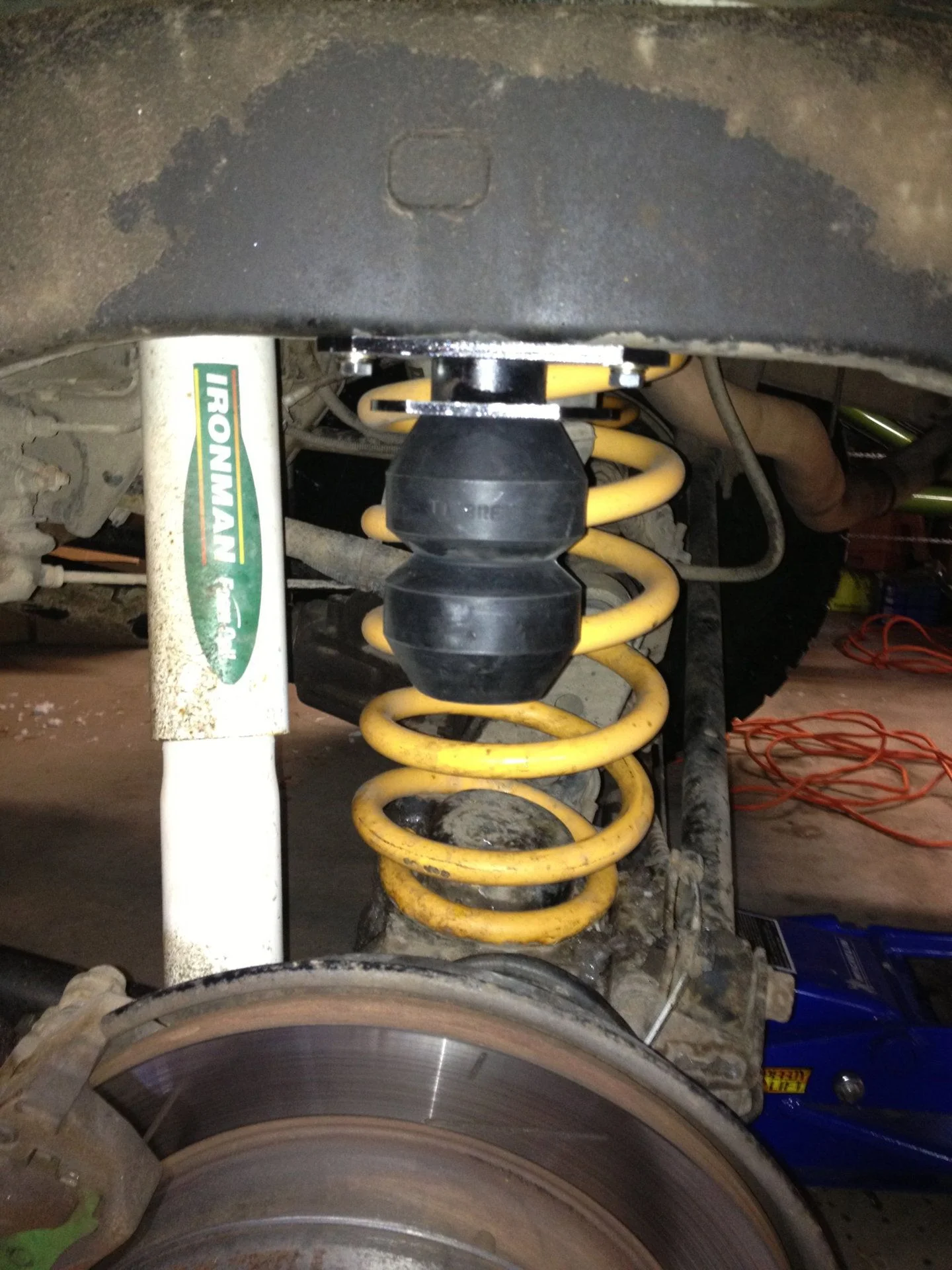

Any pics of your rears installed? Ordered up a set...with the suspension drooped, the passenger side contacts the spring, and the drivers side is solid into the tire (ie: can't even install). Curious to the height of the mount plate too, the ones I received seem like the bump will be in contact with the axle at daily ride height (no gear loaded)
N/M, saw your earlier photo...those are MUCH shorter than how they arrive from Timbren...time to break out the plasma I guess...
Yah. I went through a couple phone calls to Timbren to get what I really needed. The original kit they sent me would not even fit between the frame and axle housing. Even with my 2" lift at the time. I don't know how anyone could run what I got the first time with a stock truck. I later received a softer bump and much shorter steel spacer than the original "overload" kit. Its been 6 years since my install but I seem to remember clearancing the bracket with the angle grinder a little to prevent spring contact.
Pic for everyone else so they don't have to search.

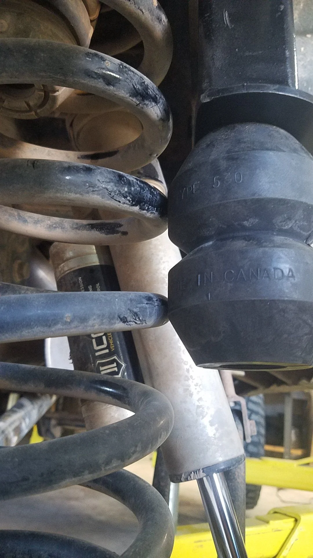

Here are mine from Sundays test fit...will be modding soon re: Corbets pic
Suspension at full droop
