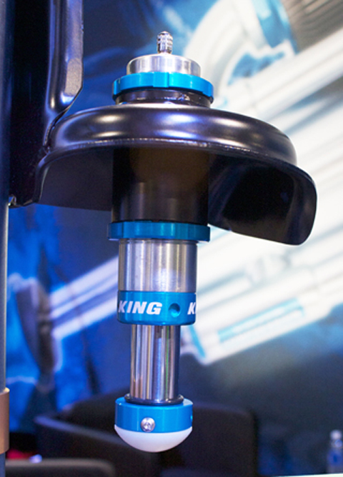

Most of the bumpstops, from the big names, break down into two categories. Most units are basically a nitrogen emulsion shock. They use an oil and nitrogen mix. Pressure is adjustable, oil volume, and valving are basically adjustable. There are a few examples that have some externally adjusted valving, but all the examples I have seen are still an emulsion based shock. Both Fox and King now have a IFP version. This allows the separation of the oil from the gas charge. This makes them slightly more consistent and allows slightly finer tuning of a few things. Price goes up accordingly.
My thoughts were the short Kings in the top of the coil towers. I have seen it done on heeps.
