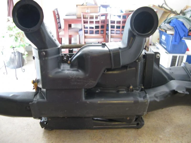

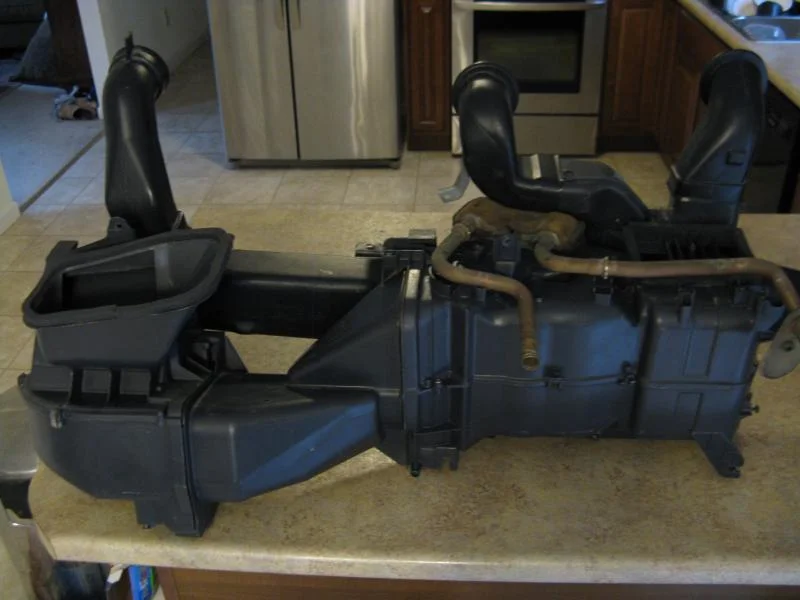

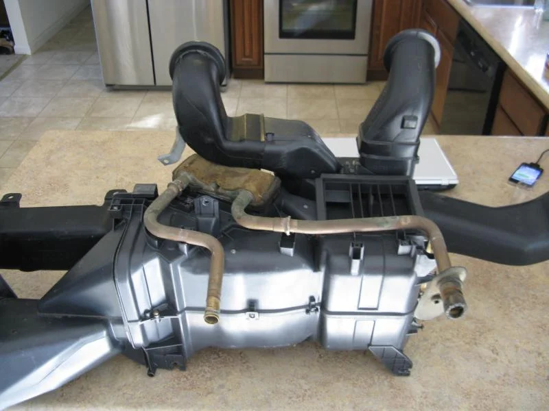

Getting ready to re-install the heater. I took everything apart and cleaned 25 plus years of dust out of the heater. I also replaced all the foam that seals everything. After 25 years the foam was pretty dried out and would flake off at the slightest touch. I did not replace the heater core as it looked to be in good shape. I gave it a good flush and hope this will be sufficient.
