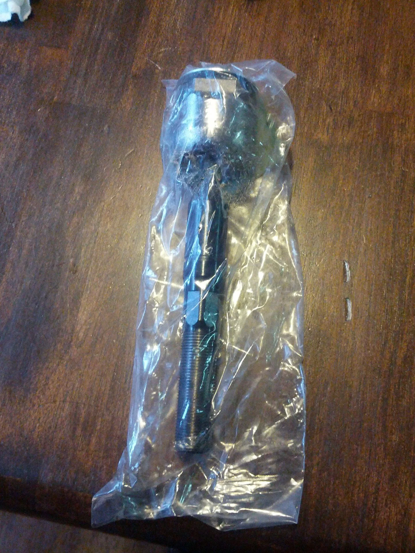

I haven't actually done it yet, but looks doable. PN 45503-69015 is pretty expensive from toyo, so I bought a Moog with same part number and made in Japan.
