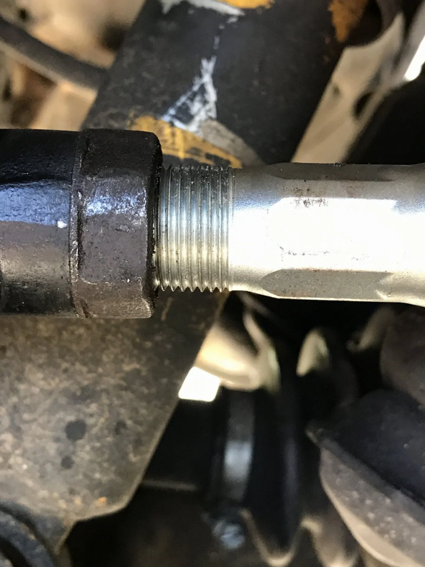

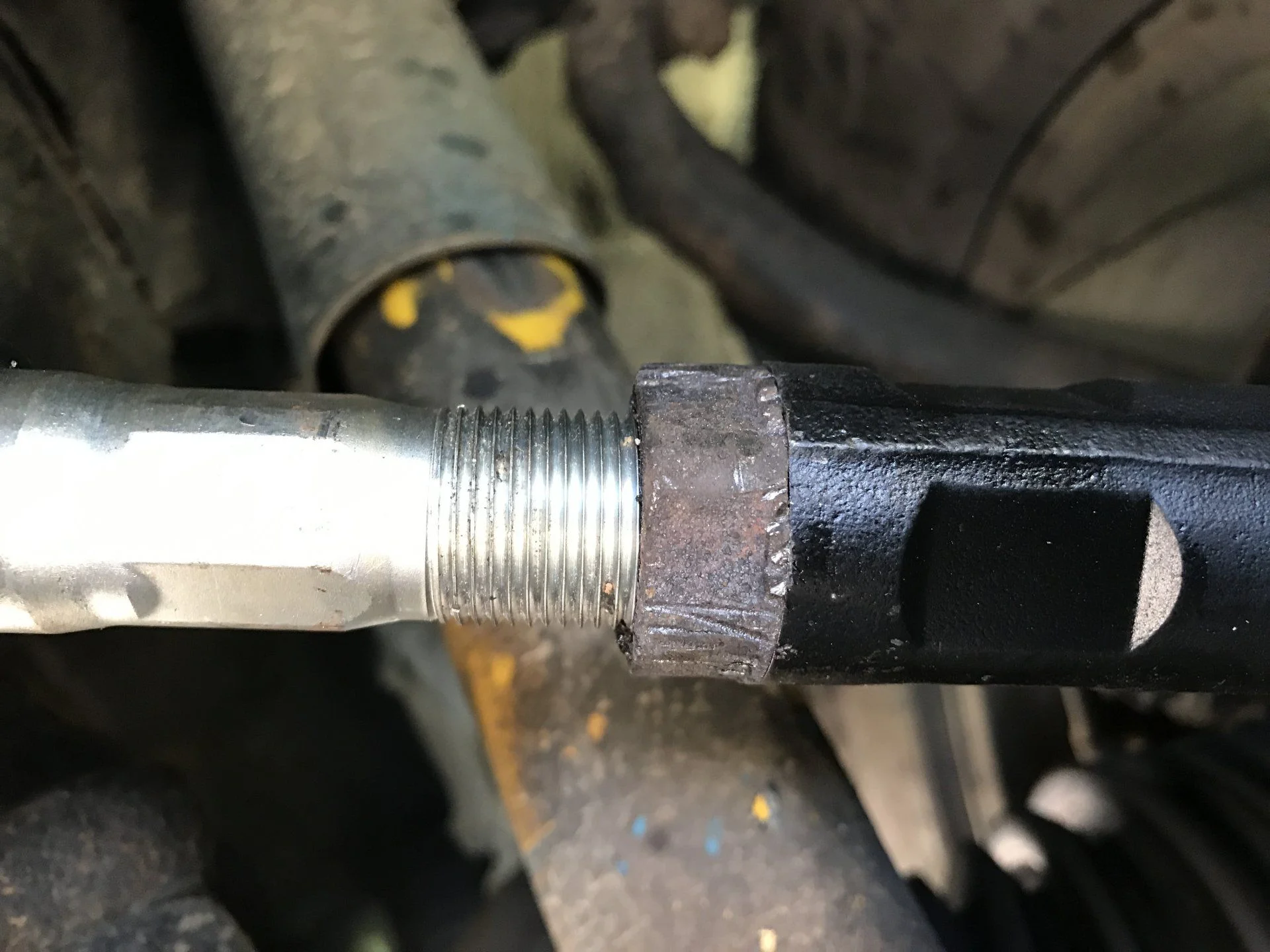

I get the truck back and of course my OCD has me inspect their work. Low and behold the TRE on the drivers side has 5 more threads showing than the passenger side! So I did a lock to lock test and sure enough I can turn the wheel 2 rotations one way and 1.75 rotations the other way. The truck also pulls slightly to the right.
So I call the shop and they say, they're not going to be equal cuz that's how they set the toe! They also appear to not own any wrenches as my TREs are all chewed up from channel locks.

Sounds like they got off one spline on the steering linkage. It's probably a difference that won't make a difference. I'd have to correct it, but that's just me :) If the toe is set correctly there should be no pull. Are you sure it's not the road crown causing the rig to veer to the right?
I'd be more upset over the chewed up TREs. It's not any harder to grab the appropriate wrench versus the channel locks or monkey wrench.
The steering rack isn't centered. It took me three tries at Toyota for them to get it right. You should be able to turn the wheel equal amounts each way. Up to you if it bothers you too much

Alright I met with the owner/mechanic and explained to him what I thought was going on. Specifically about the steering shaft spline being off and the tie rod ends being unequal to compensate for that. I think the light went on and he finally understood what was going on. Anyway, The Hundy is going back for the third time next week.

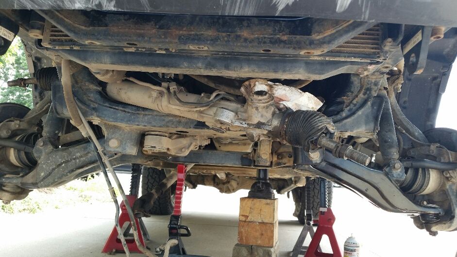

My take on this is that it's pretty easy other than the steering shaft disconnect and re-install. I say this because mine was originally a Michigan truck so the first removal of anything generally sucks bad. I tried to remove this a few years back when I did DT headers but ended up leaving it alone and working around it due to how stiff it was. Obviously there was no working around it and I fought and fought with it but the lower joint was NOT happening after hours of effort (I was not going to flame a rubber sealed universal joint if I could avoid it). I found the post above by @rohitash who had the same problem and I decided to try removing the rack and shaft together. The upper joint separated in only an hour of cursing and then as rohitash described, I removed the rack and universal shaft together. I actually got it to come out from the front after shifting it full passenger. It took about an hour or two on the bench to ultimately separate the rusty steering shaft from the old rack... but it cleaned up nice enough and went back in.
Thanks all who contributed to this thread, I don't usually follow write ups but several points here made this job a lot more straight forward. @ENGINE er Thanks for the initial write up and giving me a name to take in vain as knuckles were busted. @5Cruiser Thanks for the engine lift idea, that is the real key. @rohitash Thanks for letting me know the sucker would come out with the steering shaft attached, saved my day.
-If you struggle with the lower steering shaft connection definitely move to the upper as rohitash and I did, it makes it a lot easier to deal with. It will come out the front with the shaft still attached and the engine lifted about 1". Pay no attention to the front drive shaft, unrelated work.

Looks like you turned your rack off center to get it out? Do you think you could have left it centered and gotten it out the front?
