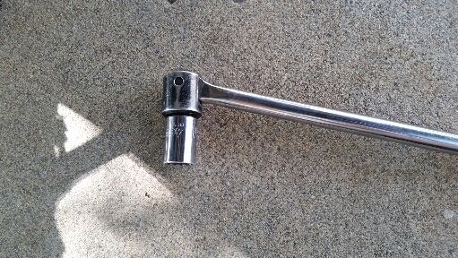

-A flex head breaker bar makes the passenger side mounts on the early trucks a piece of cake.
