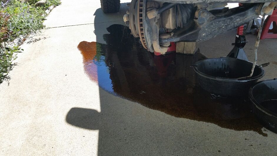

-Wind sucks, work inside if you can... or put a rock in your pan!
