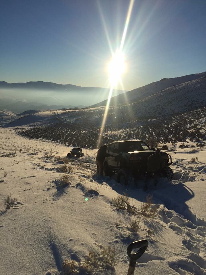

That's rad, it looks like it's deep in the first picture
It was reasonably deep for 40s. Deep snow is all about flotation - thats why tracks work well, way more surface area. So if you don’t want to go to a bigger tire then airing down lower is your only other option and beadlocks help with that. And of course max trax etc help consideray to get unstuck. Check out the Kelowna Snow Wheelers for some wild snow wheeling.

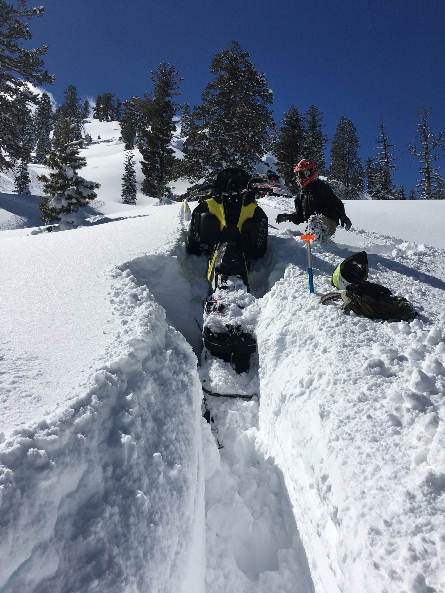

Also here are some unsolicited stuck pictures on dedicated snow toys, getting stuck is part of deep snow - therefore tools to get you unstuck are probably just as important or more so.
