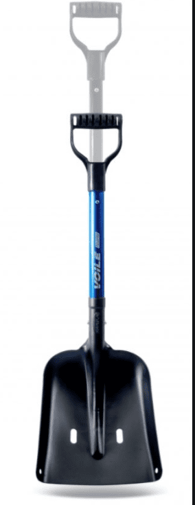

I've had one of these Voile mountain shovels for about 20 years and it works well. It stays in the car and goes on mountain hiking trips etc....its not not as good as a big shovel but its very strong and does move snow well enough to help with extraction.
Same. They work well.
I third this. I've been using a $20 aluminum snow shovel at the beach for 5+ years. It's been great and while the edge is really starting to wear down, it has taken all the abuse like a champ. I would not hesitate to get another one for tossing in the Cruiser for snow.

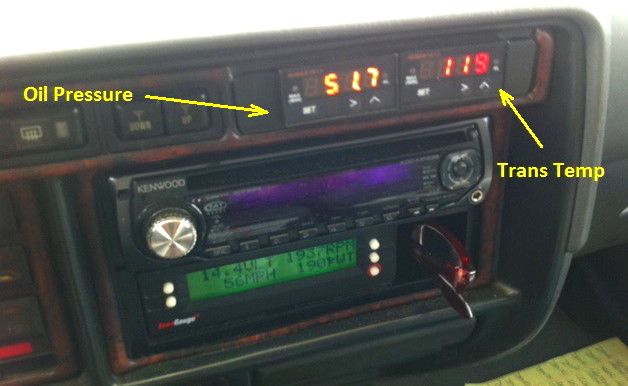

Many miles of fording through snow 12” plus deep and always impressed with how cool the A442f stays according to the auto meter gauge I plugged into the trans oil pan. In fact, whether goofing around in snow above the rocker panels or crawling rocks in 90 degrees or scooting down the highway over mountain passes, my 1993 trans temps very rarely get up to 170 and 140-160 is the normal when working. These transmissions run cool.
Low range is your transmissions friend.

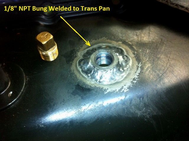

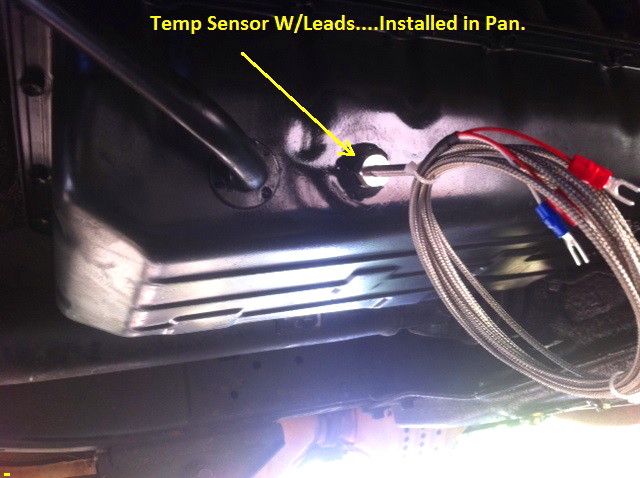

Exact numbers on my A343F. My trans gauge turned out to be a pretty 'boring' system to monitor, but that's a good thing I suppose.
Welded a bung onto my trans pan and installed the sensor there.
Yes boring but better safe than sorry. The pan temp gives us a good look at average core temps once the gears have been lubed. The fluid can be much hotter right out of the converter as it’s routed toward the cooling system but that would be reflected in a pan monitored system and not as much of a concern as the constant core temp. I once pushed my gauge up to 180 but it took Rubicon crawling with A/C on in 90 plus degree summer heat. I’m very happy with the fact that this is just one more thing I don’t need to worry about while enjoying the Landcruiser.
