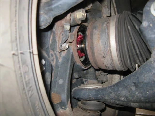

What it does do is makes sure the grease comes in contact with the whole spindle. With your needle setup you have no way of knowing how far the grease has traveled into the spindle bushing.
attachment.php
Based on the above picture, how do you know how much grease got to the roller bearing that is inboard of the brass portion of the bushing? When we grease it, we will actually see the exact same thing as you, except that we know the grease has traveled past the roller bearing to get to that point.
Toyota designed the bushing to pull grease into the bushing and bearing years ago. You are wrong to say Toyotas design does not work and needs your tool. I have 150K miles of using my method to prove that Toyota's long time design still works.
There are 100 of threads on cone washer removal due to the difficultly to the average home do it yourself. My method does not require cone washer removal or require a hub socket to remove the spindle nut to use your tool. My method is not said to be better just a much easier alternative for the 100 DIY guys that does not have the tools or skills to use your tool.
