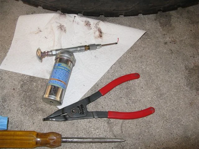

The LandCruiserPhil spindle bushing greasing method...
Pros
·10 min. a side, 5 min. is you have an assistant
· Know you are in fact getting grease to where you want it
· Know exactly how much grease is being applied
· No need for special tool - Sorry vender's:o
· No mess
· Ability to see condition of the shaft and bushing
· A 1 :banana: job even a caveman can do it
Cons
Flame on
Procedure
Remove wheel cap
Remove dust cap
Remove snap ring
Have your assistant push in axle stub or use a ghetto system like pictured
Squirt grease around the bushing
Reverse steps
Picture #1 - Tools required - very little disassembly required

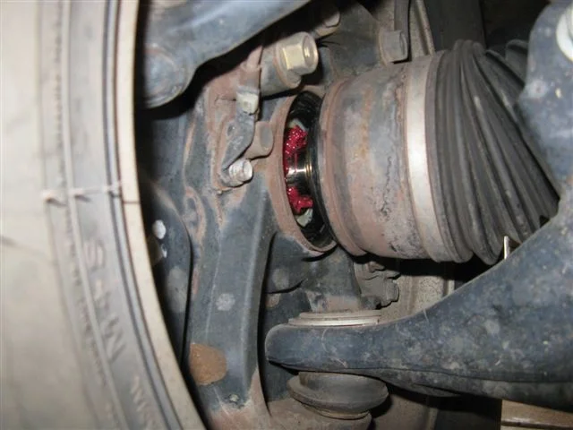

Picture #2 - Apply grease to brass bushing - Bushing is factory designed to direct grease to needle bearing

Yes. Its the needle bearing that is pressed into the steering knuckle that supports the CV shaft at the inside portion of the knuckle. Its often, by home garage mechanics and maybe even some pros, overlooked bearing apart of any axle/hub bearing PM work. But it will let you know if you forget to grease it ;)

Phil, that is certainly one way to do it. Catch is that the bearing and needle bearing is probably about 2" long. I can see how you get grease on the side of the bearing in your method, but I am not sure how much you are going to get into the needle bearing which is further into the spindle.
Our tool will ensure the grease is pushed in from the other side, all the way through the bushing and bearing until you can see it on the area that you how you have greased.
