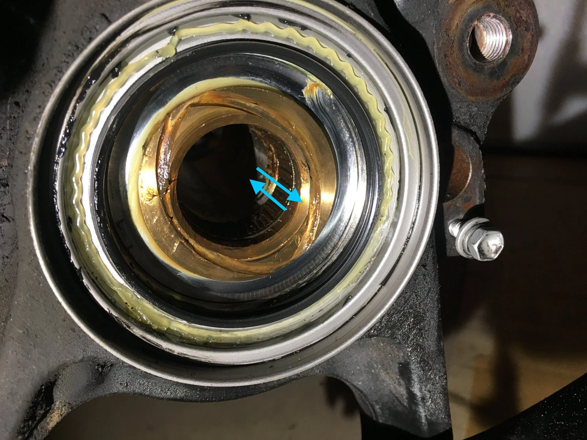

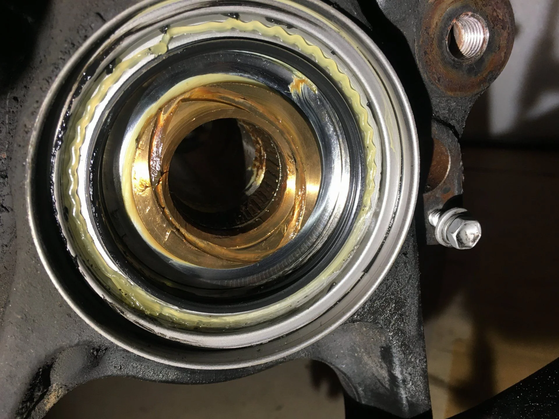

How does one check if a spindle bearing is worn out or not? And if it is, what can happen if not replaced? The grease in there looks a little dirty red, dunno if that's caused by moisture? I'm also wondering upon reassembly if I can just lather everything (knuckle and CV) with a simple Lucas Red n tacky grease? I have everything apart right now replacing a drive shaft bearing so I would love to make life for my future self easier if possible.

Also, I have slight bearing play inboard and outboard if I drag my finger parallel to the spindles, don't know if that's just how they are or if grease will tighten them up

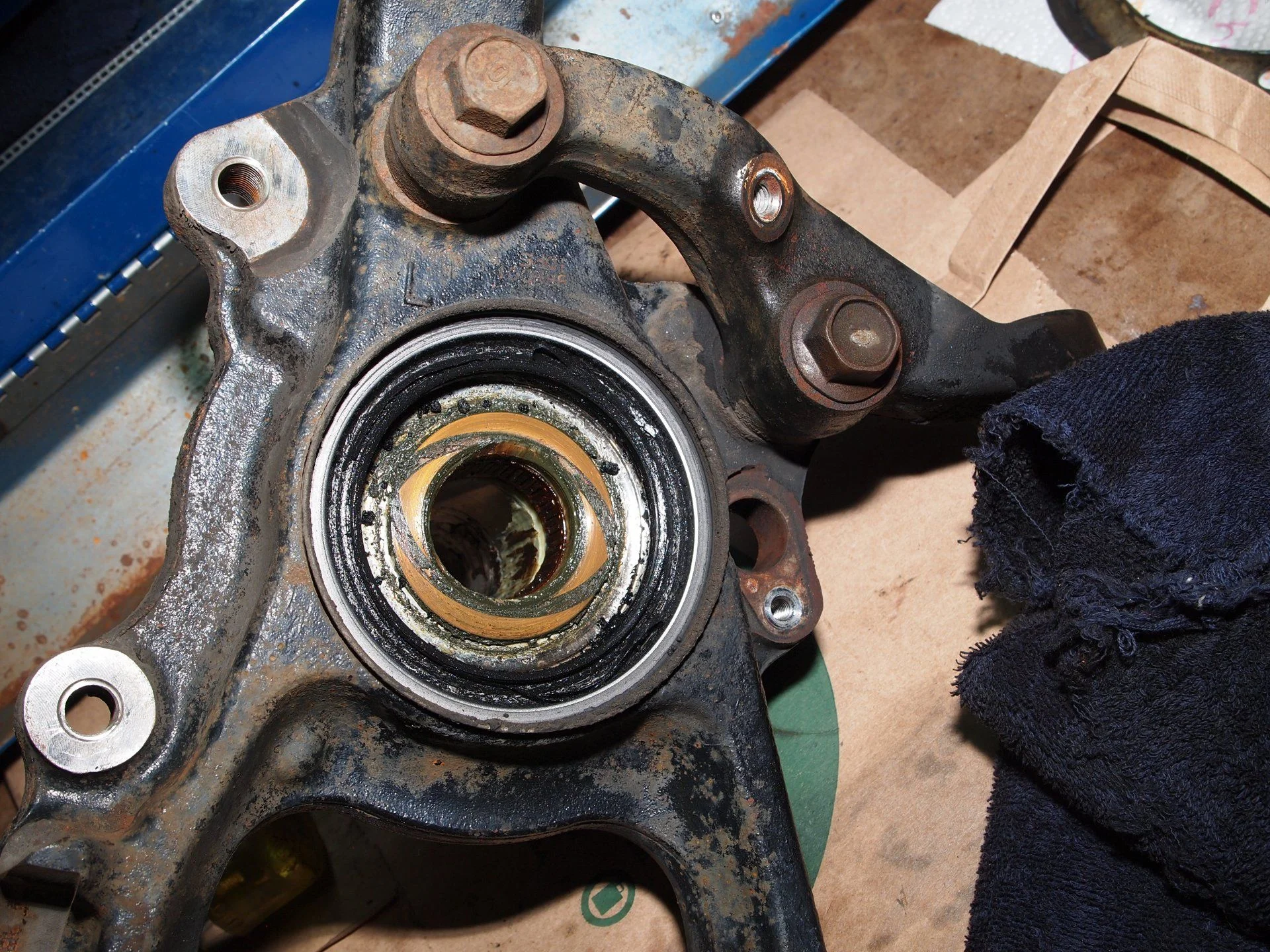

I always clean the needle bearings, brass bushing and knuckle really good. I do this after removing old seal and before installing new seal. I'll spend 1/3 of my time cleaning & inspecting ever "first time" service. Once clean I inspect visually under 10X power magnifying glass or by zooming in on a picture. From what I see in your pictures they're good, but hard to tell with old grease on it.
Your play is ok! What your looking for is damage, pitting or scoring on needle bearing.

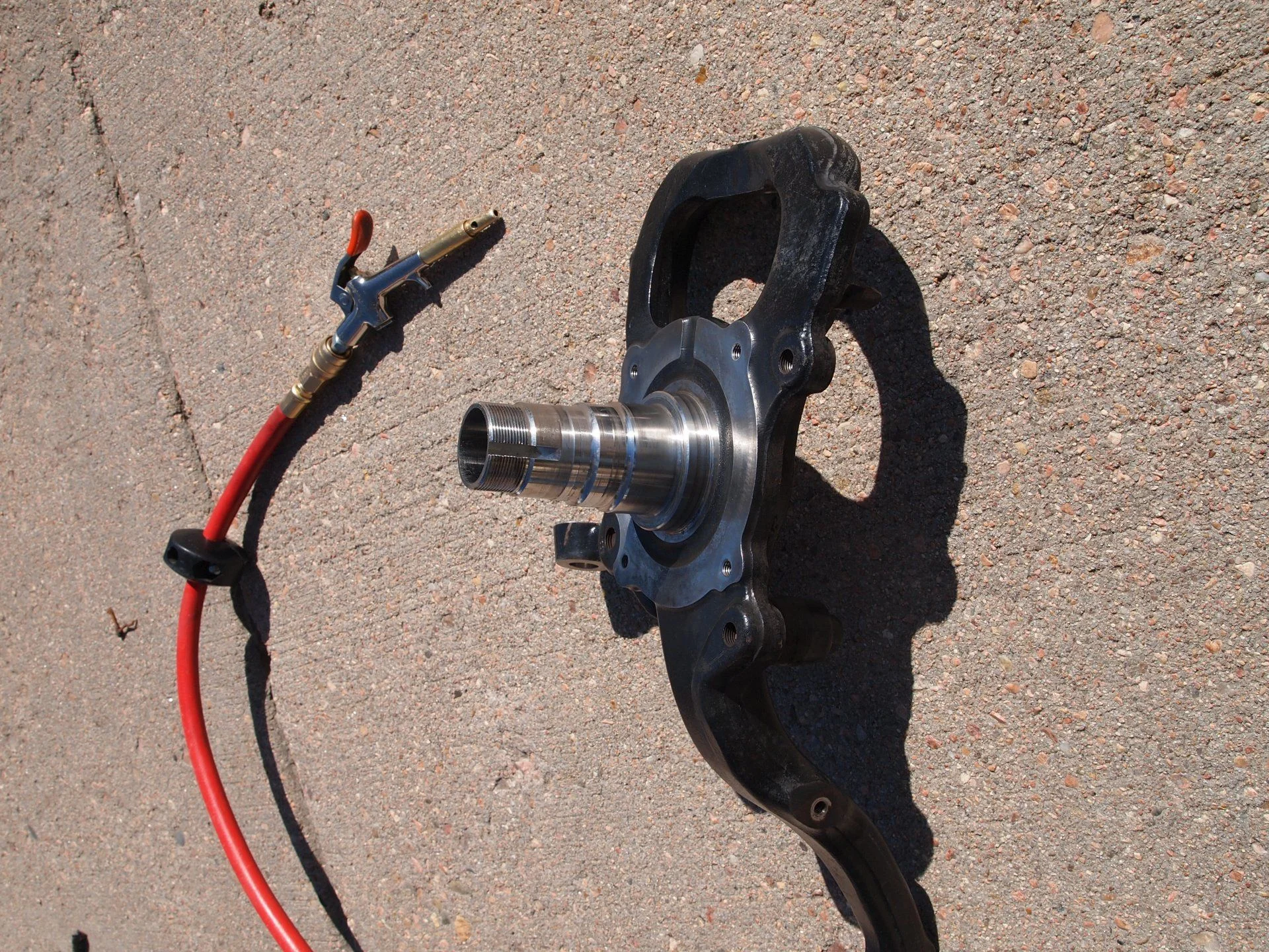

Tube in a grease gun works better, but that tub will be great for doing your wheel bearings, and you can slather that into the spindle bearings since you have it all apart. Next time, use a grease gun and Slee spindle bearing grease tool. Makes the process easier, done from the end of the axle. There is another low budget process called the "push" method but the Slee tool makes it one step easier.
Slee Spindle Bushing Tool
