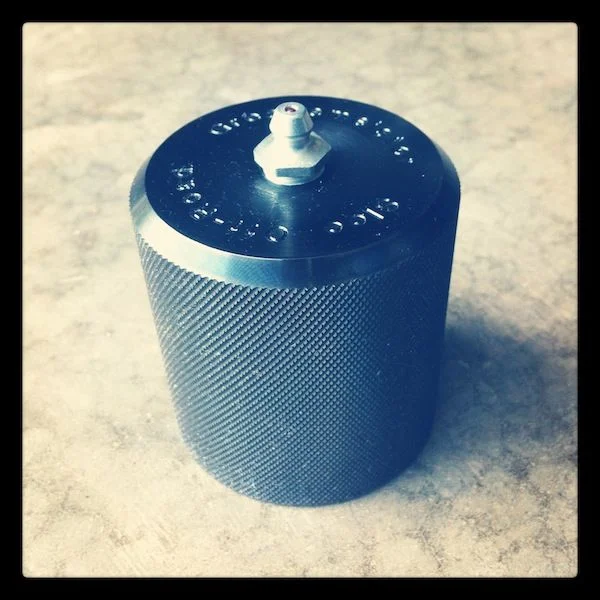

Iirc slee said just the (outer) locknut needed to be removed (and at that point the lockwasher slides right off so no biggie). If the inner locknut also needs to be removed (I doubt it does though) that automatically turns this into resetting preload of the bearings. But then again bending back tabs of the lockwasher to get the outer nut off, I guess you may want to reset preload on the inner nut while in there anyway and maybe use a new lockwasher?...
Bottom line is the tool makes sense to me if you're in there anyway doing a bearing repack (very 30k by the book) and I appreciate the fact that slee's sharing the tool and making it available to diy'rs. I'd argue that when repacking the bearings is the right time to do this job of lubing the spindle bearings anyway and if one isn't servicing their own wheel bearings then why would they bother servicing these bearings themselves - just ask the mechanic to also squirt the spindle bearing using landcruiser phil's method. for anyone complaining about taking off the flange I don't get why this needle bearing is so important that you would grease it without repacking the wheel bearings which is called for every 30k..since there's not even a mention of greasing this bearing in the service schedule iirc.

That is perfect! While these wont make or break your business.... I think it is even better that people want to buy it now. Thank you for doing that!
Wow. Pictures are just awesome. Now i understand it except for one thing.... In the video, when the grease pushes the axle inward, how do we get it back outward? Is this accomplished when the outer hub nut is tightened?
The axle and nut are independent of each other. You can just grab the axle and pull it back. Needs to be pulled from the inboard side.
It really is a beautiful piece of machining.
Question: I added grease until I saw new grease oozing past the brass bushing per Slee's instructions. The shaft was then difficult to pull back outboard, but I finally got it pulled out and the snap ring back on the end of the shaft. I have a tiny bit of grease finding its way between the outboard shaft dust seal and the back of the steering knuckle. Should I be concerned?
Anyone?
I would not be concerned about that. I see the same thing when I lube mine. The little bit of extra grease has to go somewhere if there is no air gap left inside. Now that all the extra grease is squeezed out just wipe it off so it doesn't collect dirt. It'll be fine.
