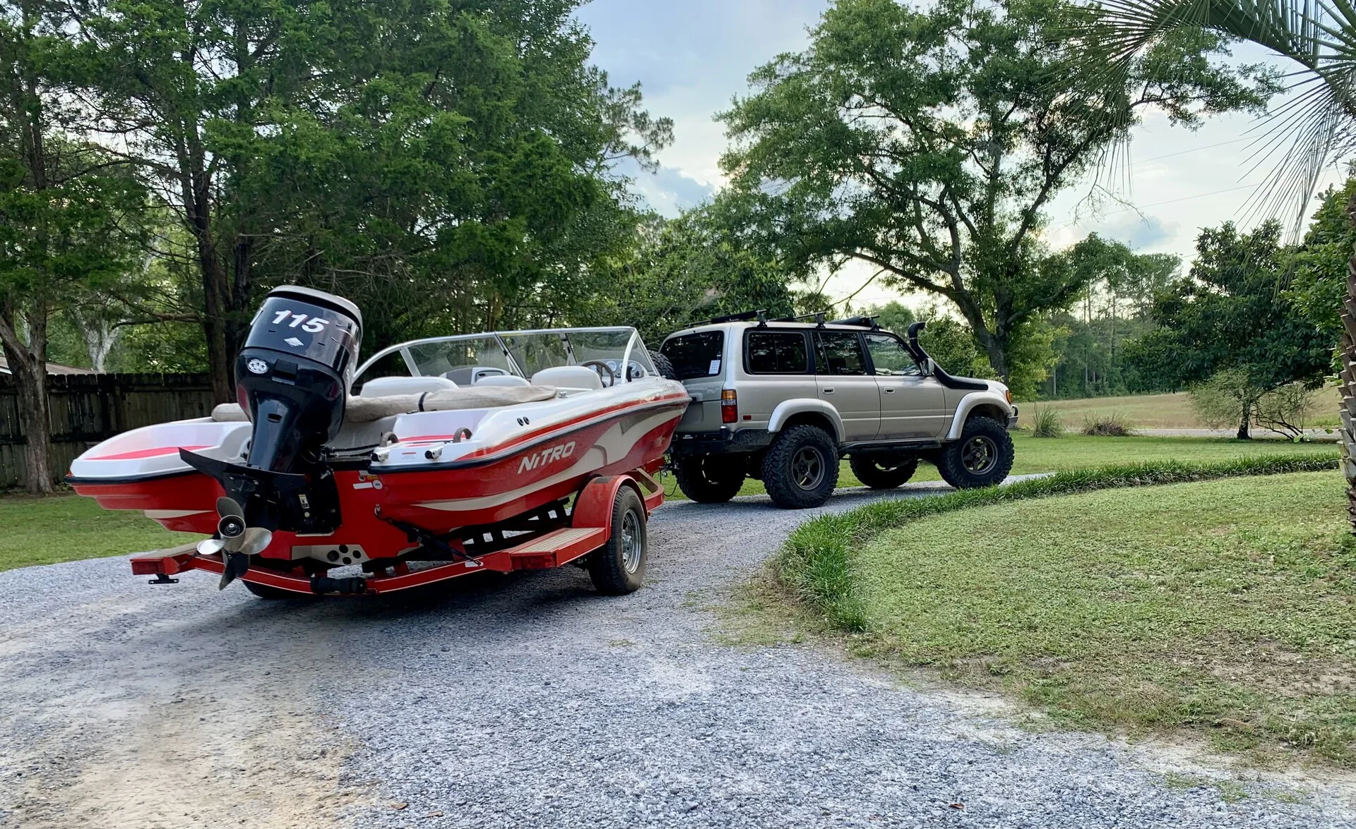

I would just freshen up the trans with a regular rebuild kit, throw in a corvette servo, stock converter, and change the tune to “tow/haul” all the time.
Keep nice clean fluid in it and run a nice cooler and it I’ll last just fine. Mine is to almost 200k. My truck is heavy, I drive like a maniac, and I tow decent loads on occasion. Mostly this boat.
Which I should add that I did not rebuild it. It had 116k when I put it in with a new filter and fresh fluids.
