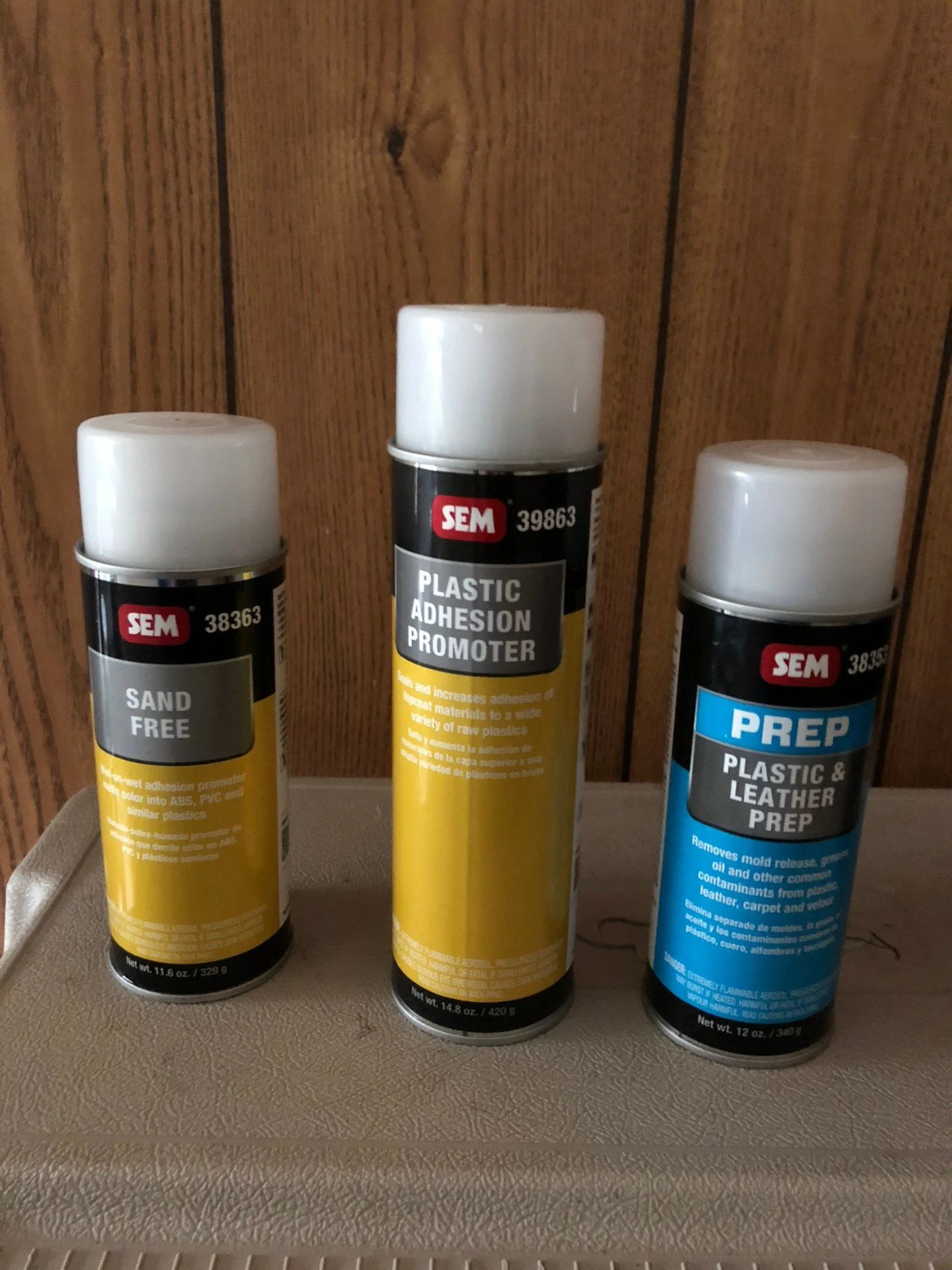

The SEM system does work very well for painting plastic. Have had great success refreshing many interior plastic pieces. The center console looks brand new and shows no wear or scratches after a year of so of use. Key is following the steps with proper preparation. Make sure the plastic is super clean by aq thorough washing with Dawn or similar dishwashing soap. After drying, follow SEM plastic prep spray. Then the most important step is using the appropriate plastic adhesion promotor spray. Apparently this material chemically melts a micro layer of the plastic which you immediately follow up with the first color coat. Allows the paint to get in the plastic and not just on top. You need to use the correct promoter spray depending on the type of plastic (i.e. ABS) being painted. Their are two different promoters. Below is a photo of the products mentioned. The SEM website is a great place to learn about each product. Their Customer Service is great too if you have any specific questions.
