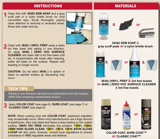

Hi Tex ( @Scro )..have you painted your dash yet? I noticed that SEM recommends 38343 Vinyl Prep prior to the Color Coat (not Plastic Adhesion Promoter 39863), so I wondered if it worked OK for you?

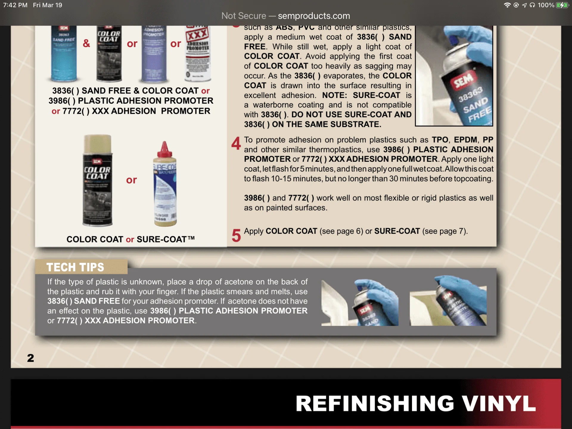

I believe the "acetone" test used to decide between "39863 Adhesion Promoter" or "38363 Sand Free" is meant for hard plastics (like my center console) and not for vinyl. When I did that test, the vinyl on my new OEM gray dash pad got sticky and the dye/paint came off, so in this case too, the Adhesion Promoter would not be the recommended choice.

This is a screen shot for future reference.
Hi Scro.. I see on your screen shot of the SEM guide (Item 4) that Adhesion promoter works on most plastics and paints. Maybe it isn't necessary to use the recommended Vinyl prep...I know that other MUD members have used it, but unsure how it might work with a brand-new vinyl dash.
I plan to paint the dash pad in the next couple of weeks. I couldn't find the SEM vinyl prep locally, so I ordered it online today from "StockWise Auto". I'll post pics

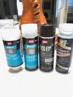

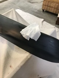

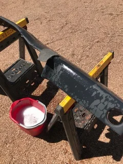

OK...so I finally got around to painting the gray dash pad SEM brown. It only took about 2 hours including drying time once I got started, but I'll wait overnight before applying the UV protectant. Looks really good so far, so here are my steps:
1. Small amount of Dawn in big bucket of hot water and grey (v. fine) scrub pad. Big bucket of clean, hot rinse water afterward. I noticed that the water was beading on the surface at first and scrubbed until that went away.
2. SEM soap with scrub pad. Another bucket of hot rinse water. Set inside garage to dry for 1 hour.
3. Small amount of masking (probably unnecessary).
4. SEM Vinyl Prep (38343). I had 6 damp cloths on standby for this step and only let the Vinyl Prep set about 3-4 minutes before wiping it off. After 5-10 minutes, I noticed it didn't dry evenly and my cloths were still dirty so I did it again. When finished the cloths were clean and the surface looked dull and even. Do not paint if there are visible imperfections or shiny streaks.
4. Paint color coats. I waited another 10 minutes after the Vinyl Prep looked dry (20 minutes total). I did four light coats and used about 1/2 can.
5. Four light coats of the Colorbond UV protectant (satin, clear). Tech tips for those not super good with a rattle can: be sure spray tip is clean and clear. Mine "spit" a couple of times and after those droplets dried about 10 min I gently knocked the sheen of those spots. Delicate work to recover. Also, don't try to spray the inside of the vent hole as this can leave a slightly greater sheen around the perimeter where there is more clear coat. Very light coats, keep your distance and keep moving.
