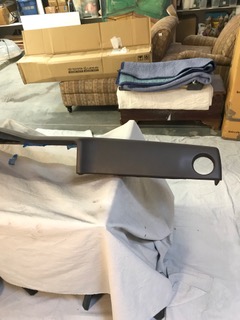

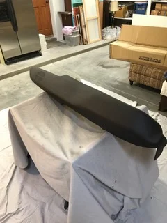

Some imperfections that maybe only I"ll notice, but overall pretty pleased. Here's the dash after UV Colorbond:
Recap: Dawn soap, SEM soap, SEM Vinyl Prep, SEM Color Coat and ColorBond UV Protectant.

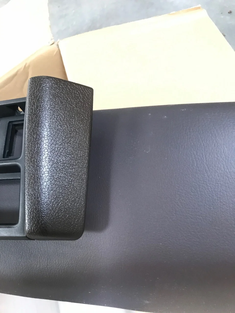

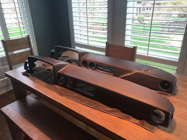

Here's a picture of the new grey OEM dash painted SEM Cordovan brown and the A/C bezel side-by-side: Notice the deeper vinyl grain and richer chocolate-brown color and glossier appearance of the A/C bezel piece. The SEM dash is rather muted in comparison. Doesn't look bad though, just different a little. For sure, I'll need to paint my A/C bezel piece to match the new dash pad.
To answer your questions: I used about 1/5 or less of the soap and hardly touched the vinyl prep. A little seems to go a long way. I used less than 1 can of Color Coat and a similar amount of UV Protectant. I bought a second can of the color coat for other parts and think that will give me plenty for the entire car.
Even though I haven't installed the part based on what I've read the SEM paint job should hold up for years, especially with the UV protectant. It's all about the prep work.
Wow, thank you for posting that comparison photo. I actually like the satin, low gloss finish of the SEM paint better than the OEM finish :) Especially for the dash where you (I, at least) don't want any glare from the sun bouncing back up at me. I have my broken up original brown dash and will take it with me when I go check out the color hues of brown I am considering. Thank you for letting me know about the quantities of the materials that were needed for the job. That lets me budget better :)

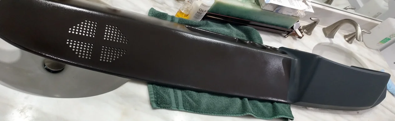

I've used Cordovan Bronw SEM with great success throughout the interior. The pic below compares to a dash I refinished with Cordovan Brown to an OEM pad I'm just beginning to restore. I used the SEM prep, texture, color and clear spray can products on this dash. Very pleased with the outcome.
Looks great. Thank you for the vote of confidence on the Cordovan Brown. I'll be going with that over the Bluebird Brown for sure now.
