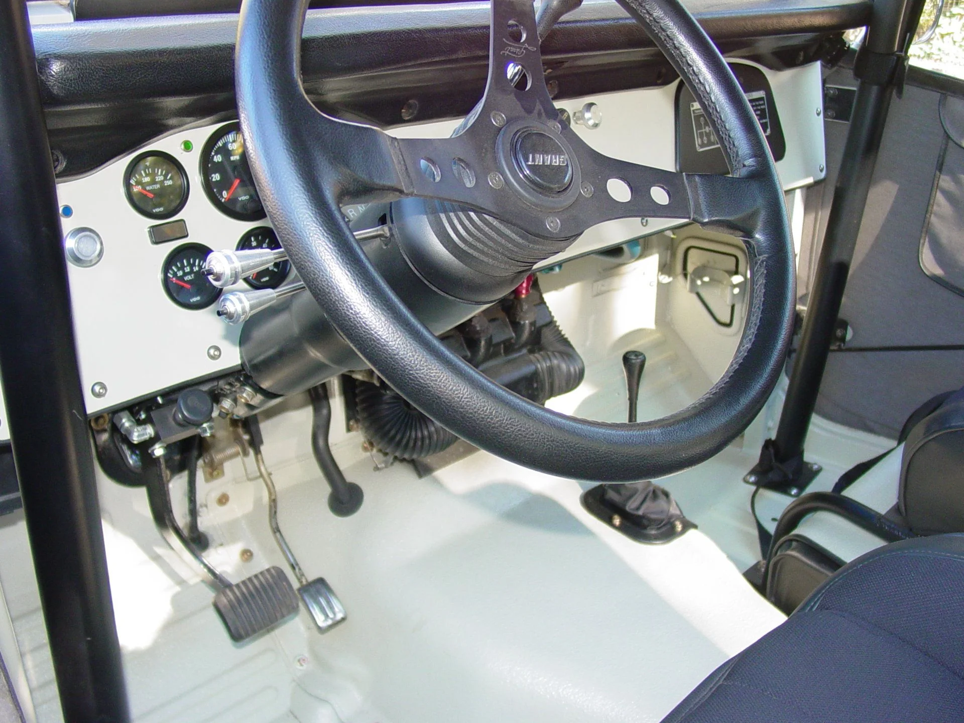

This is raptor liner when it was new ,has held up for about 8 years now.Like Splangy said prep is key to long lasting product.I had a few spots that did not get clean enough and only lasted about 1.5 years,have since repaired and going strong.
