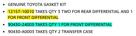

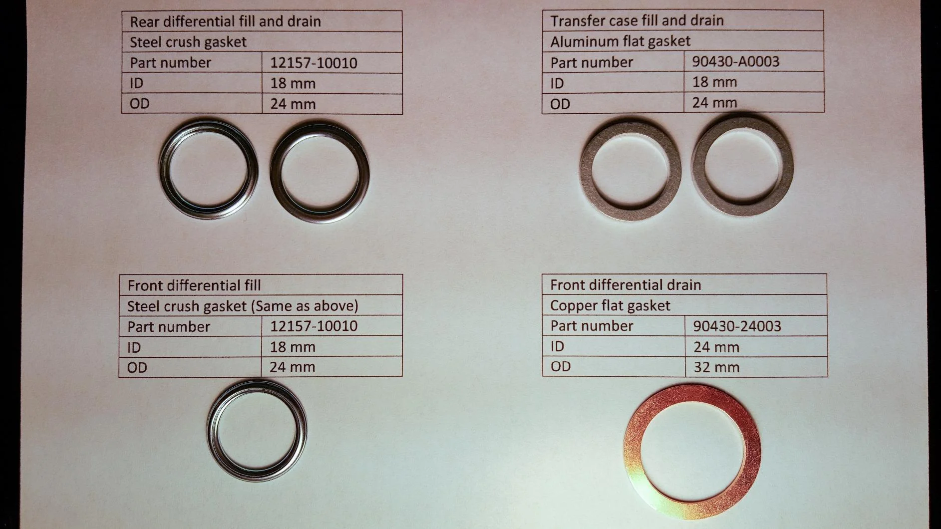

Does all three (Rear/Front diff. and T-case) uses the same crush washer? Based on this Amazon kit, it looks 12157-10010 is for both rear and front but the t-case is different.
I'm confused about the Amazon's kit here. Does this mean the front diff. washer has it's own different part number?
Okay, so based on one of the customers' post, does this mean the front diff. can use either the steel crush gasket (12157-10010) or the copper (90430-24003)? I'm confused?
