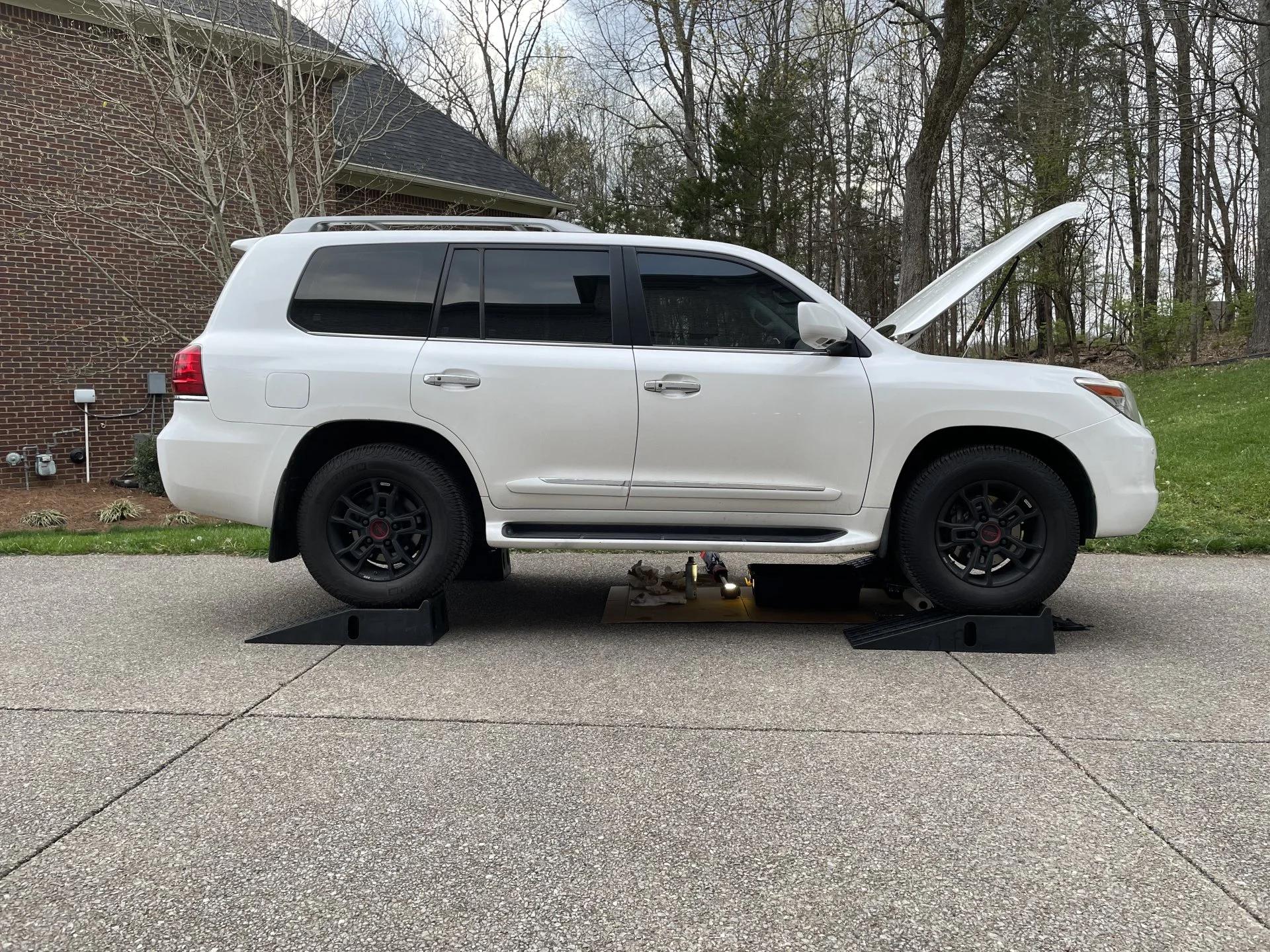

Also, Getting the truck up on a set of 4 Rhino ramps really improves the time underneath because there is so much more clearance.
Agreed. 4 ramps from Harbor Freight & AHC High Mode make all the difference.
