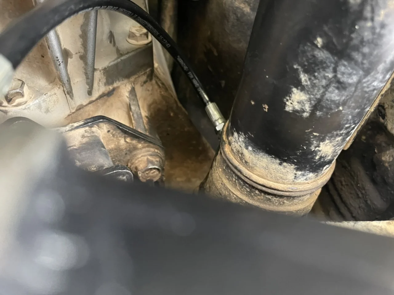

I found this thread very helpful when I went to grease my new-to-me LC200, but like everyone said the rear spider for the front driveshaft was the hardest to reach. In my case with Victory 4x4 front and transfer case skid plates, I couldn't use the passenger-side crossmember trick mentioned by @bloc and the top-access method @OregonLC mentions here was also not possible. At least without removing the transfer case skid. I wanted to attempt this without removing the skids...
Using a Lock-n-Lube connector and flexible tube, I was *just* able to reach the zerk fitting from the driver's side by removing the heat shield shown in the middle of the picture here (with 1x of the 2x 12mm bolts visible):
This is looking from the driver's side, with everything reassembled. The aluminum skid is along the bottom of the picture, and the (now greasy) exhaust pipe along the top. The hard-to-reach zerk is behind that heat sheld. It wasn't easy getting the Lock-n-lube bit onto the zerk, but I will say it's much easier once the exhaust has cooled! :inpain:

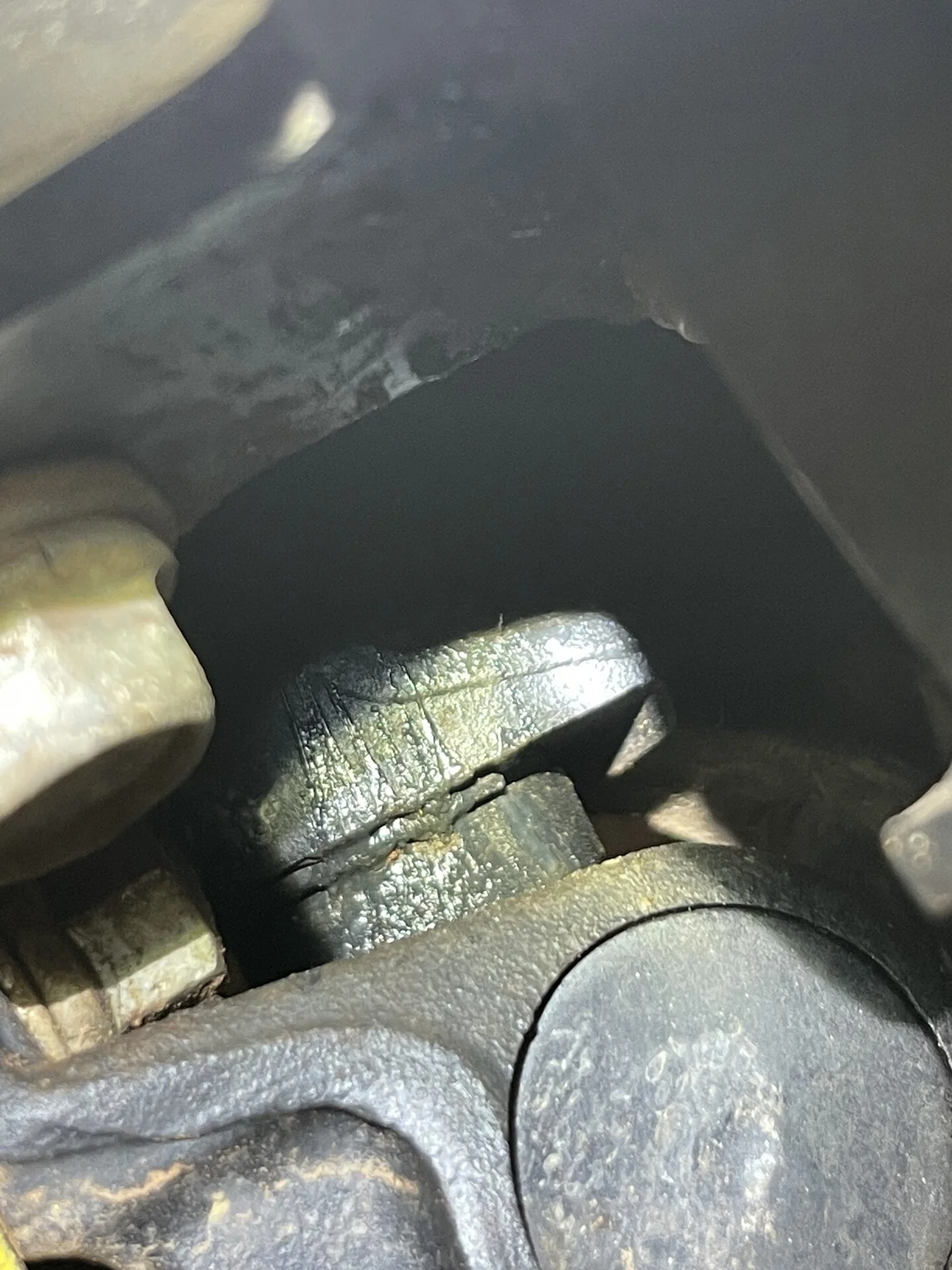

I recently greased the driveline, 1200 miles ago, and since then I’ve had a very faint smell of burning oil. I feel fairly certain it’s from the u-joint by the transfer case that’s slung grease on the heat shield that’s right by the catalytic converter.
My question to the brain trust here is, is this just a failure to properly clean the excess grease or is grease slinging out of this ever so slightly just normal?
I’m including a picture of the suspected U-joint showing some evidence of possible grease slinging as well as the greased I used. I’ve rolled around underneath and this is my main suspect. One other possibility are the SPC UCA bushings squeak so I have applied a small amounts of Blaster Multi-MAX spray lube to the small gap where the mounting bolt makes contact with the bushing, this works for a few weeks worth of driving but any that doesn’t get on the intended target could be getting on something and making that smell once the vehicle achieves operating temp.
