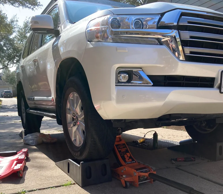

How I grease my front driveshaft
I had both wheels up on the same side while rotating tires. I was able to spin the drive shafts by hand while in Park. That’s gonna be my go-to technique from now on.
Definitely a viable option, but IMO involves more setup than diagonal ramps and a single floor jack, no jack stands needed.
I do believe my process is one of those things that the description makes seem far more complicated than it is in practice.

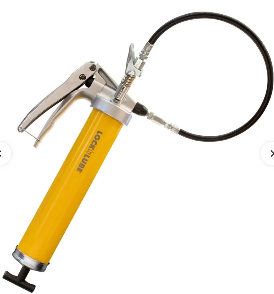

Building on this thread:
- Greased today the drive/propellor shafts for the first time at 32k miles (owned the vehicle from new, looks like dealer never did and the factory so so)
- Used Lucas X-tra Heavy Duty NLGI#2 for the spiders and slide yokes

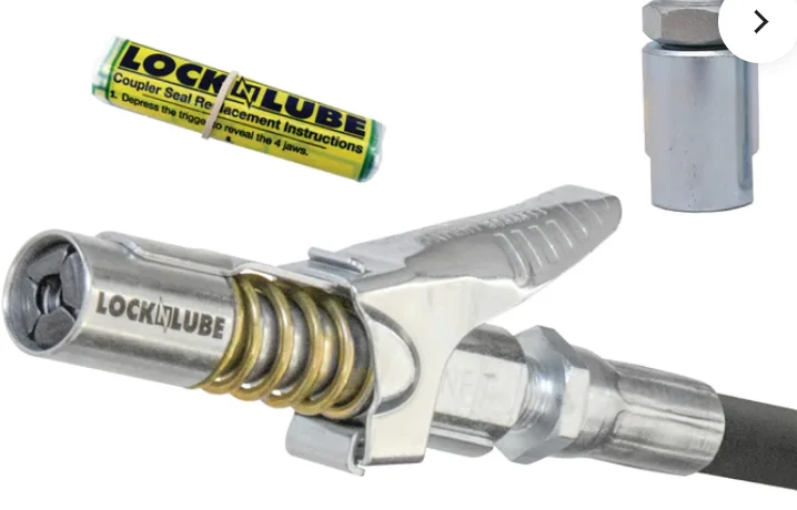

- Used LocknLube LNL 252 grease gun with flexible hose and LocknLube Grease Coupler which works well and fits in the small space at the spiders
- 5 to 6 pumps on the slide yokes and after driving relieved pressure at the shaft zerks, no back flow of grease. Looks all good.
- Used four ramps and did not need to turn a rear wheel to align the rear drive shaft to access the zerks, got lucky
- Front shaft required putting the car in neutral and jacking up one front wheel
- LC200 on hand brake, that worked fine
- Turning off ignition was followed by annoying buzzer inside and out to warn not in park..., was able to leave the key inside and close the door shutting down the intense noise outside as the buzzer inside was still going. Oh well...
- Otherwise this worked like a charm as noted by bloc
During test drive all was good. Applied the brakes several times hard per FSM. Then relieved pressure at the shaft slide yoke zerks, no back flow of grease, all good.
For now appears adhoc play felt or slight clunk is gone when suddenly changing on/off the accelerator. Looks like factory wise not a lot of grease is put in the slide yokes as reported by others. Surprising.

  1. I bought Lincoln 1134 Pistol Grip Grease Gun mentioned on this thread which in hindsight is a mistake. The NPT (?) tip/coupler is difficult to use; I managed 5/6 but ultimately gave up on the infamous rear zerk of the front shaft. I end up buying the LockNLube Coupler; the Swivel is also a nice add-on. It's a lifesaver, easy on and off. If you are looking for a grease gun altogether, I'd highly +1 to others recommendation: this LockNLube kit.

The Lock N’ Lube coupler is definitely the way to go. I also have this one as well, it makes quick work of the front zerks that are more difficult to reach.
