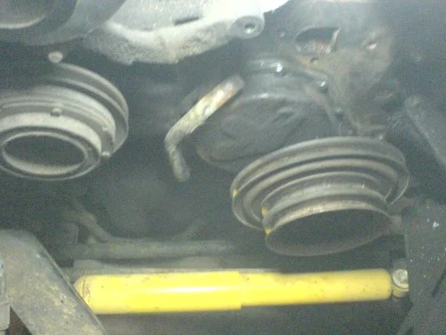

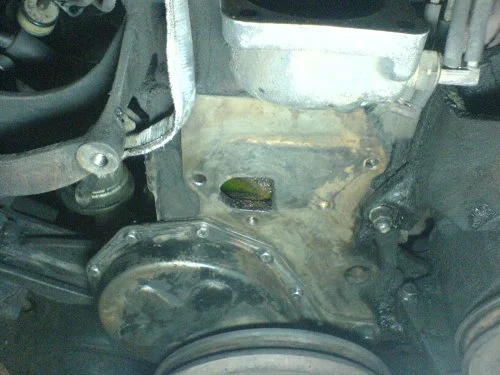

Well, once again a little job turned into a major overhaul. I noticed few weeks ago that I had a radiator leak of some sort. After the third time noticing the leak I was able to find the leak...the water pump had take a s**t! Buy this time is was a gusher and the Cruzier was un-driveable. I ordered a new water pump from the local Toyota Dealer and the part came in a few days. So I thought, a new water pump, a new gasket, some silicone, some radiator fliud and that would be it......WRONG! When I removed the hoses they were all jacked up. I think that the only thing making a seal on the hoses was the hugh pockets of calcium deposits. Both the radiator and heater hoses were pretty bad. I figured my $100 job just got more expensive.:crybaby: So, I proceeded to order a new thermostat, new radiator and heater hoses....what the heck, I might as well get the radiator rod & cleaned. Now $600 + into the project, I find out that Toyota no longer makes the top heater hose. The hose is pretty badly rusted and the tip of the hose is completely gone. Does anyone know where I can order on of these? Thanks Fellow Cruizers!

Seems to me that the thing you are showing is the top coolant line for the oil cooler (the metal part anyway) Spectre has the metal ones and the hoses that complete ther circuit.
I think you are right...it get to the heater sooner or later. Thank man! :wrench:

What is wrong with your water pipe? Just rusty on the end? If it's not leaking, just clean it up, paint it and off you go...
