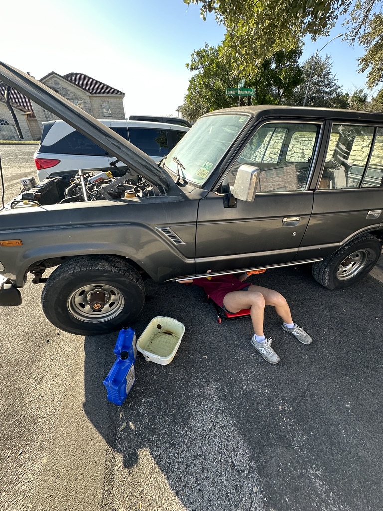

either way, it's going bye bye and I'm putting in a rear heater bypass as some of the lines going to the back are leaking. It's daughter's project car so her friends can be semi-cold in the back.
Installed the bypass hose from @cruisermatt but need to buy some plugs now for the lines going back and one of the exits in the rear heater piping on the side of the engine.
