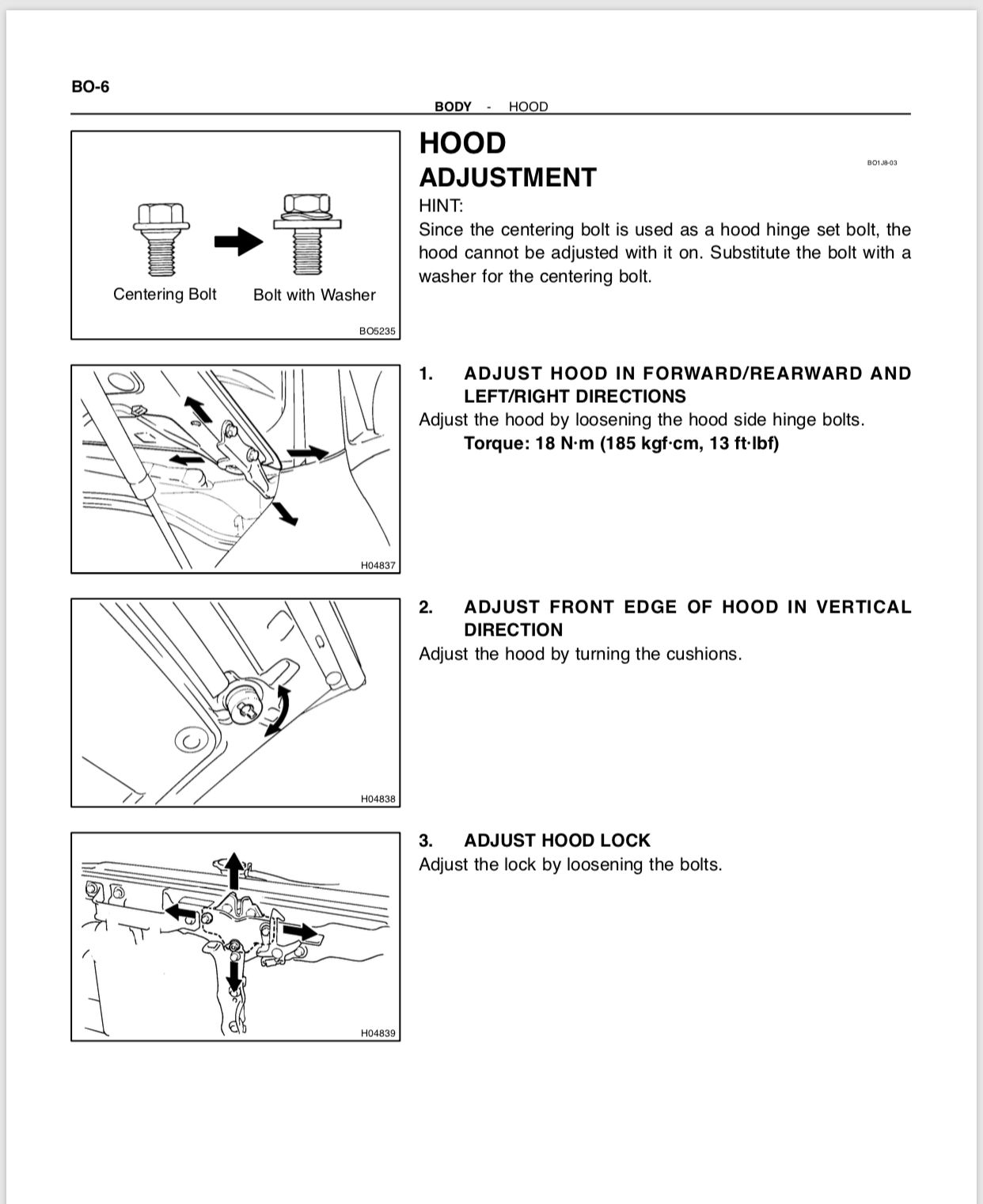

Read the FSM
If hood latch adjustment doesn’t do it, your latch probably needs to be replaced.

Thanks to DirtDawg and jLB though for taking things the right direction to the adjustment procedure that involves the latch. I hadn't dug through my FSM yet, and haven't gotten a good copy thats well indexed. Not sure if I'm ready to pay for a printed copy.
