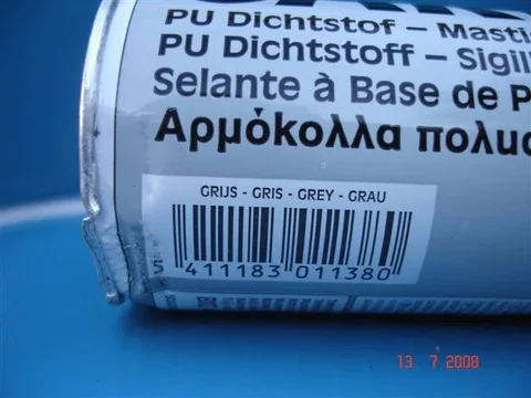

.....what did you use to seal the apron panels to the fender? It looks like a white caulk of some sort....
I had already taken a photo of the mastik I used (which was supposed to go in the earlier posts) but I must have dumped it by mistake. So I just went out and took another couple of photos now. (If you're like me - you prefer to believe photos than words.)
It is "Soudal Carbond 940FC"
Here's the tube ---- The black tape on the end is to try and stop the remainder of the contents from "going off" (because I want to use it on the "steps" when I get around to refitting them - which could still be a number of months away).
And here's a close-up of the barcode showing the colour. It sure looks white against the blue paint - but it is actually "grey". (A colour that I think Americans spell as "gray".)
I put a thick layer of this mastik on the "apron-panel" before bolting it down. Then I scooped off most of the surplus that "squelched out" using the blade of a rather-blunt penknife, before cleaning it up with lint-free rag (old singlet actually). In the end, I dampened the rag in "mineral turpentine" which takes off the surplus mastic cleanly without taking off any of my fresh blue paint.
