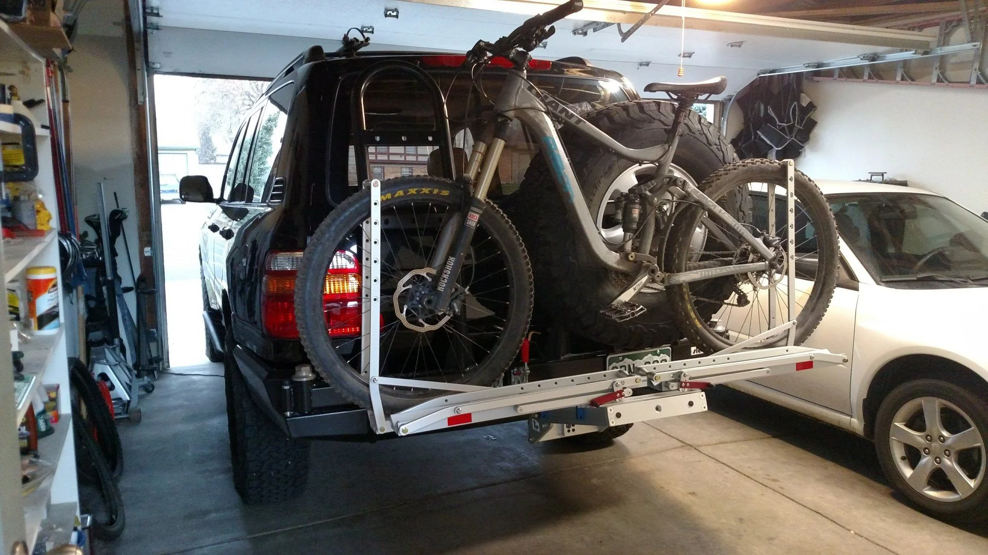

I have been going through the same dilemma recently.
What I ended up going with was 1up USA's heavy duty dual rack. I can fit two bikes on there with no issues, however I do loose the Slee swingout functionality (currently). To remedy this, I just bought a 2" drop receiver extension so that I can fold the rack down and still be able to swing out the tire/ladder, then drop the tail gate to change shoes and drink beer after a ride.
Using only the rack, no extension, I can fit my mountain bike on there without contacting the spare tire (the pedal fits between the center of my spare tire). I just don't slide the receiver portion of my rack fully into the hitch.
Here is a pic.
Here is a pic.
