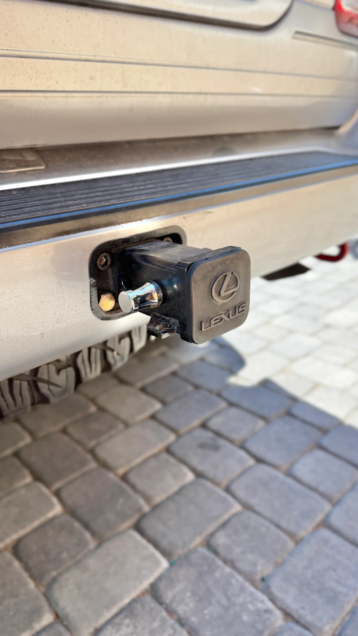

So I am in the same boat sort off . I have an 05 so I have the bumper cutout hitch which is pretty silly in terms of attaching a recovery hook or bike rack. The fit is not 100% and if the shaft is too long it hits the spare. Just today I sourced an OEM Lexus under bumper hitch. It will serve me better as a tow hitch / bike rack receiver.
Now can anyone tell me what bolts will I need to mount this hitch?
Thanks

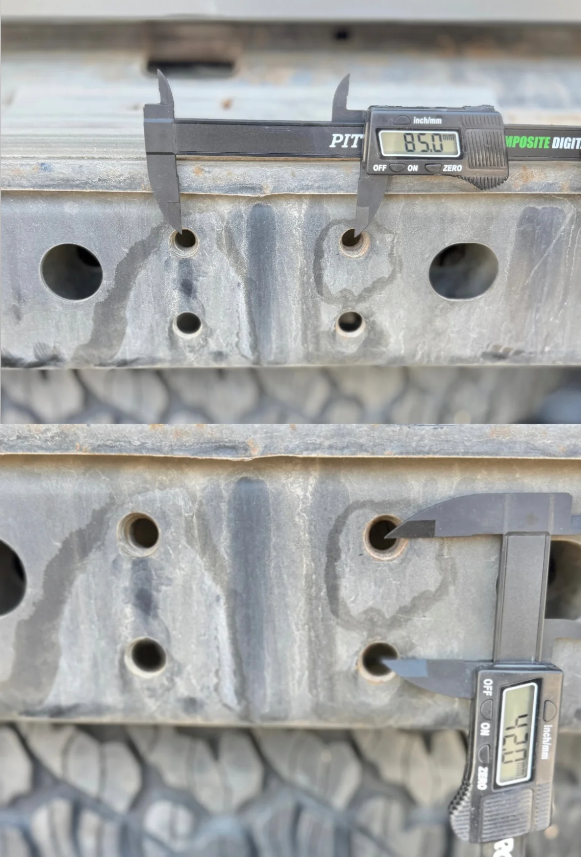

But like you I need my hitch receiver to transport our MTBs. I have an 06 and my rear cross member frame piece doesn’t have the through and through 2” hitch OEM receiver you see in 2003-2005 YMs, but I have the mounting holes (2 threaded and 2 non-threaded) initially designed for the pintle hook.
I ordered a cast-iron type female hitch receiver from amazon that has the same hole to hole spec as my rear cross member and had that copied but using steel material and fully tig-welded custom made by a local fabricator.
I removed my factory hitch receiver assembly because my 35x12R18 spare tire wouldn’t fit in the underside factory spare tire location.
Good point. I have not actually checked whether my 99’s frame crossmember has a 2” square through-hole. That would be a non-starter for a bumper-mounted solution.
That’s odd, all 4 are threaded on my 07 LC.
Mine's upper holes are threaded, used socket cap bolts and lowers and opted for zinc coated hex bolt with stainless steel washers and nuts.

My 03 LC has the hole in the crossmember, so I can use the OEM adapter. I currently have aftermarket hitch under the vehicle and I don't like how low it sits. I will not tow much with this vehicle, so thinking I may cut the bumper and do the through bumper hitch.
I would not use SHCS for mounting a trailer hitch; the heads are too small to spread the load properly. They weren't designed for this type of mounting anyway.
Use hex head cap screws, M14x1.25, Gr. 10.9 or better (I'd use 12.9, but that's just me) (for the weldnuts), or you can use SAE 7/16-20 grade 8 or better (I'd use grade 10). The thread pitch is the same for both series (there are other SAE-Metric threads that are also equal, FWIW). I typically use rear (third row) seatbelt anchor bolts; they're the same size and right length.
You obviously want equal grade nuts for the other two bolts, and hardened flat washers would be nice to use, too. If not, then at least structural washers—not the Home Depot variety.
Also, FWIW, the 80 series has a 6-mm doubler plate behind the frame where the pintle hook is design to mount; I don't think the 100 series has it (I haven't looked in a while). If it doesn't, it needs it.
