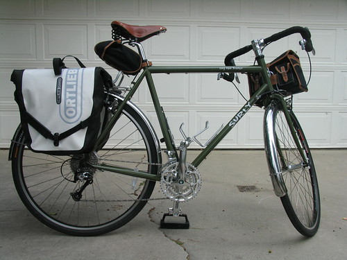

CK - Nice Surly and glad you found something that meets your needs.
