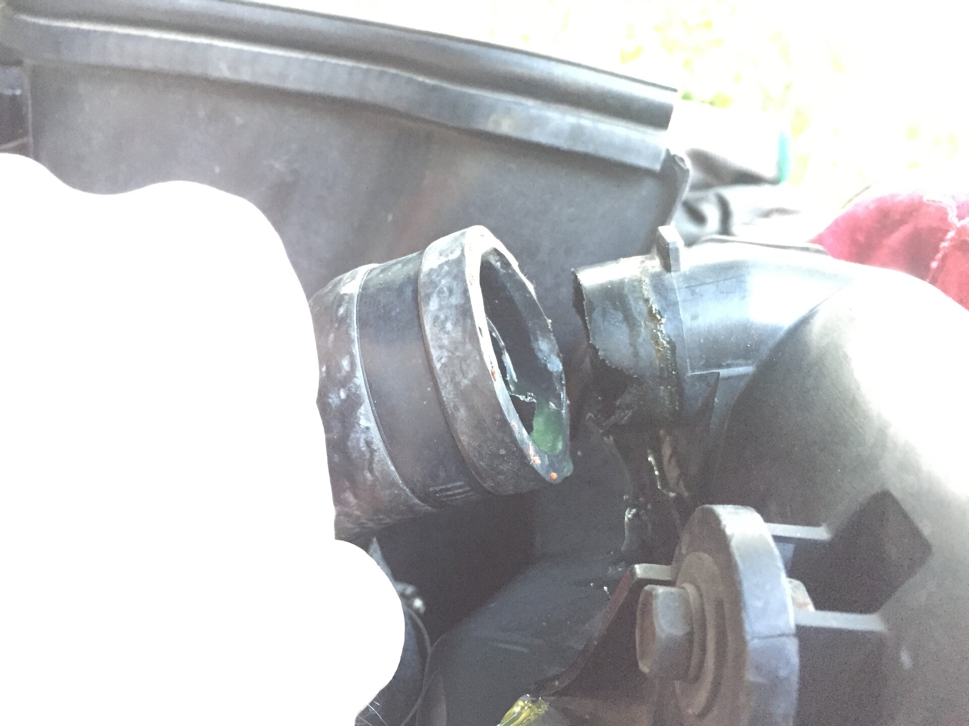

I'll just note about the recommended Koyo Rad: I bought one in 2016, after my water by-pass barb broke on the then 19 year old OEM unit. Eight years later (in 2022), I discovered the plastic of the main upper hose barb on the Koyo cracked & crumbled (see photo). I was very surprised by this as I, and many others, had very good results using Koyorads in another coolings-system-sensitive autos, the 2nd gen Acura Legend. In hindsight, the Koyo rads produced for the Legend were from Malaysia and the Land Cruiser Koyo's are from China. While some may say that 8 years from a radiator is acceptable, the Toyota OEM radiator would disagree. Take that for what you will.

I had a TYC do the same thing in my 80. I swapped to a Copper/Brass CSF for the earlier models and the only issue I had was long hill climbs towing in 100 deg plus ambient temps. I run a Koyorad in my 100 but she pretty well stays on the pavement, experiences less vibration and will get a radiator swap as PM every 5 years until I save enough for a RD.
Bottom line is the plastic tank TYC and Koyorads should be replaced every 5 years. After that and the Thermoplastic crosslink bonds are starting to deteriorate from constant heat cycles.

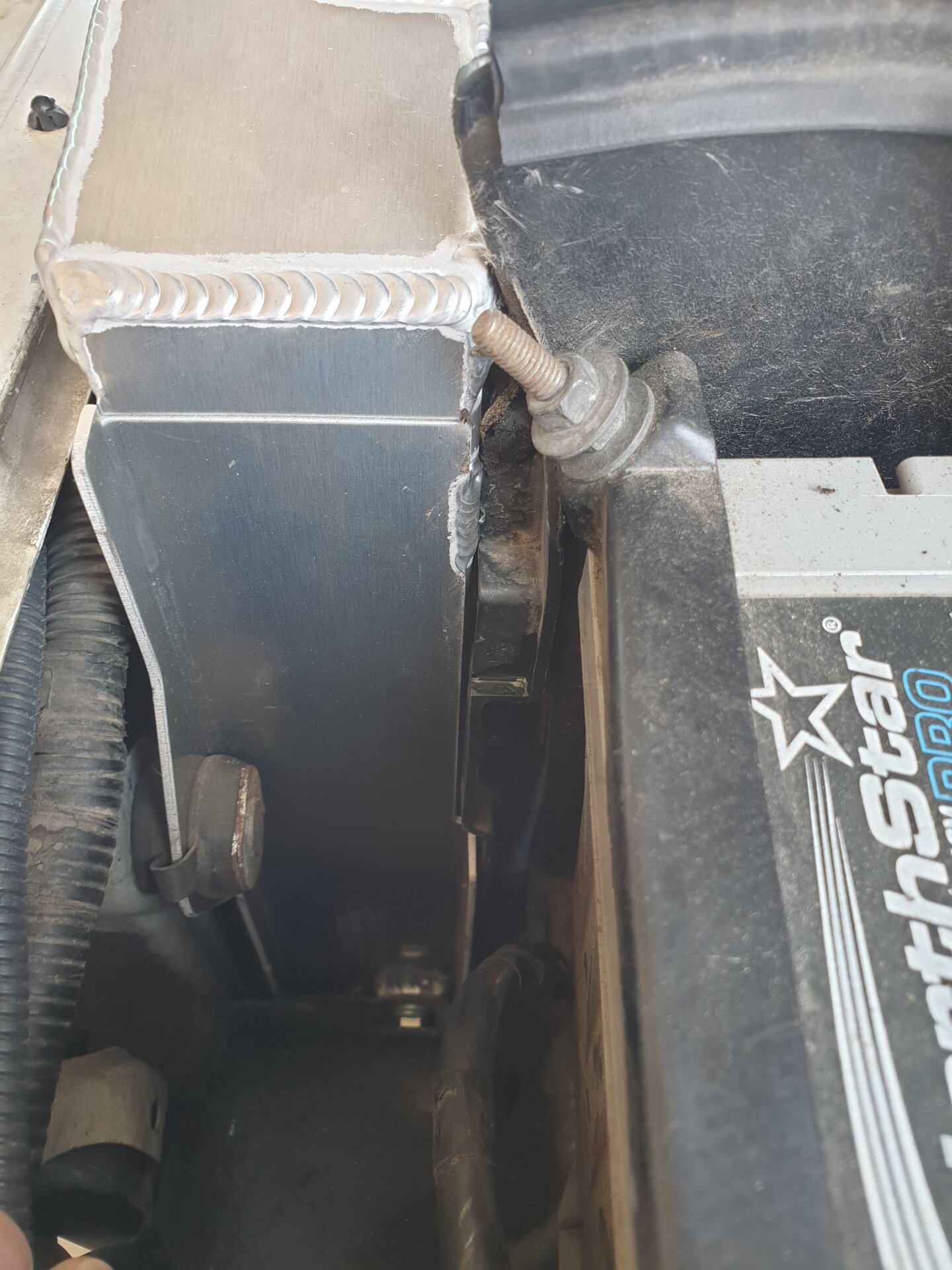

Photos from the recent install showing quality of welds, mounts and general fit.
Oddly enough while studying these pics I took I just noticed there is some lettering between the Veins in the Fan Clutch. I can make out a "B" and a "K."
One more. The battery hold down is not touching the radiator even though it appears to be.
