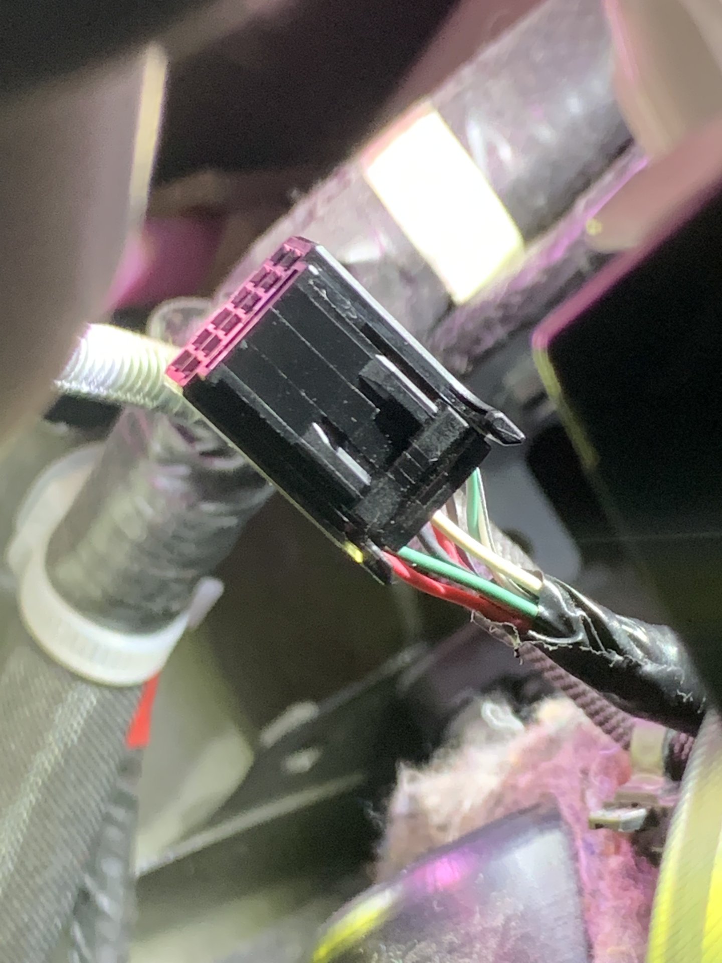

Has anyone figured out how to bypass the TPMS? Ive done it on several other Toyota’s and Lexus by splicing together two wires. I haven’t seen any write ups for a 200 series. I located the wiring harness for the module, behind the passenger/rear panel but don’t know which wires will ground the module.
Hi Danny, I saw you where attempting to bypass the TPMS, i'm very interested can you share more details pictures and instruction. I hate this stupid system. Also location of the ECU box, i see its on the rear passenger quarter panel, but from the picture i see two white box. Also which wire to short, did you use a resistor across the two wires? Thanks in advance. Rom

Does anyone know what two wires bypass the light from the harness in the rear quarter panel? Or hypothetically, what wires would those be? Lol
