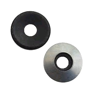

is this the kind of washer you used?
Mine didnt look quite that bad (NorCal), but i just grabbed some stainless steels bolts and some rubber washers and "sealed" the holes back up that way. I did it years ago, and its never leaked a drop.
yup, those are the ones, they flex a bit and seal the hole up well. Use a little silicone when installing. From the pics it does not look like bad rust. I would: wire brush area, sand a bit, paint, let dry and then install the bolts and washers with silicone
