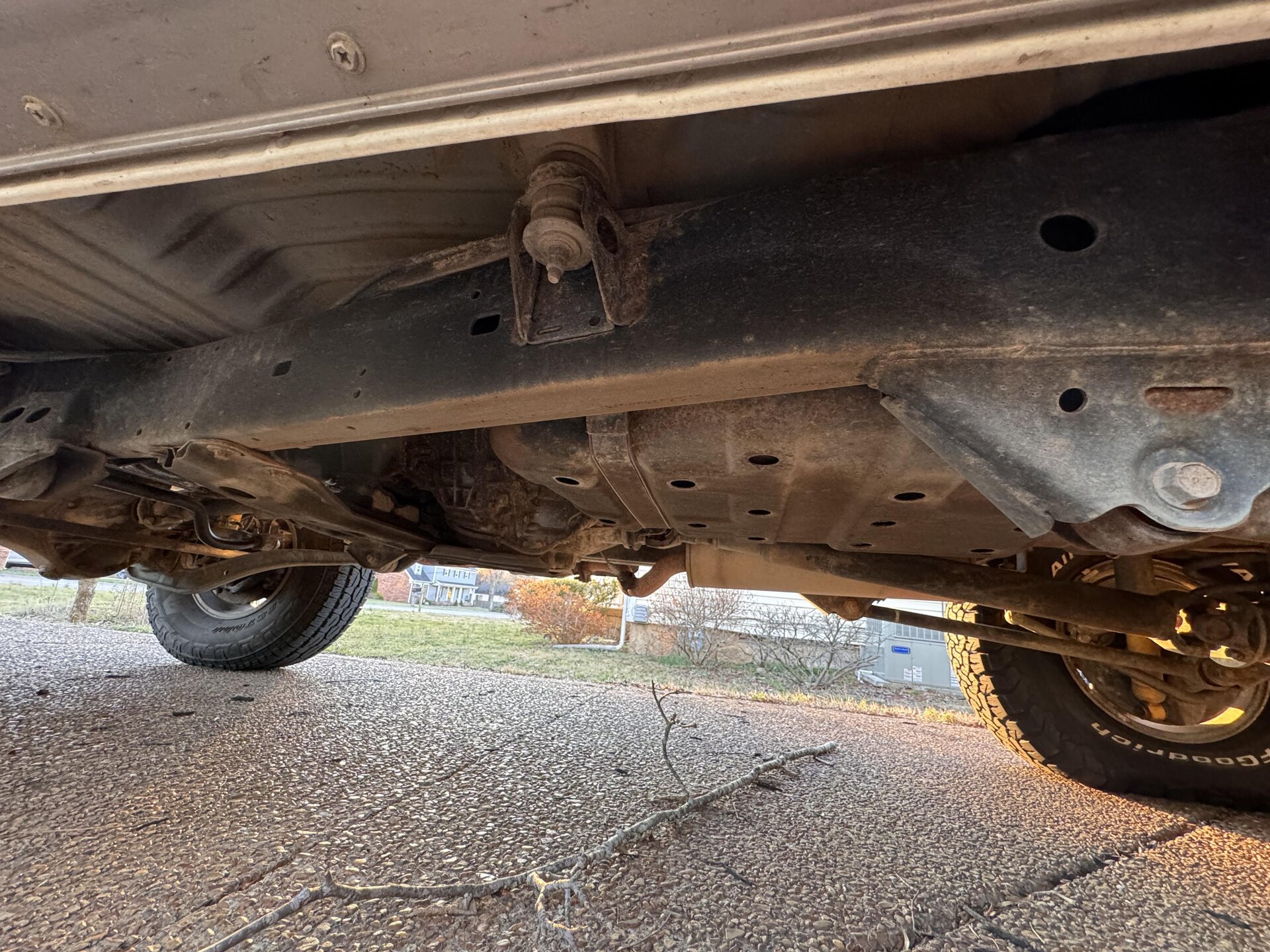

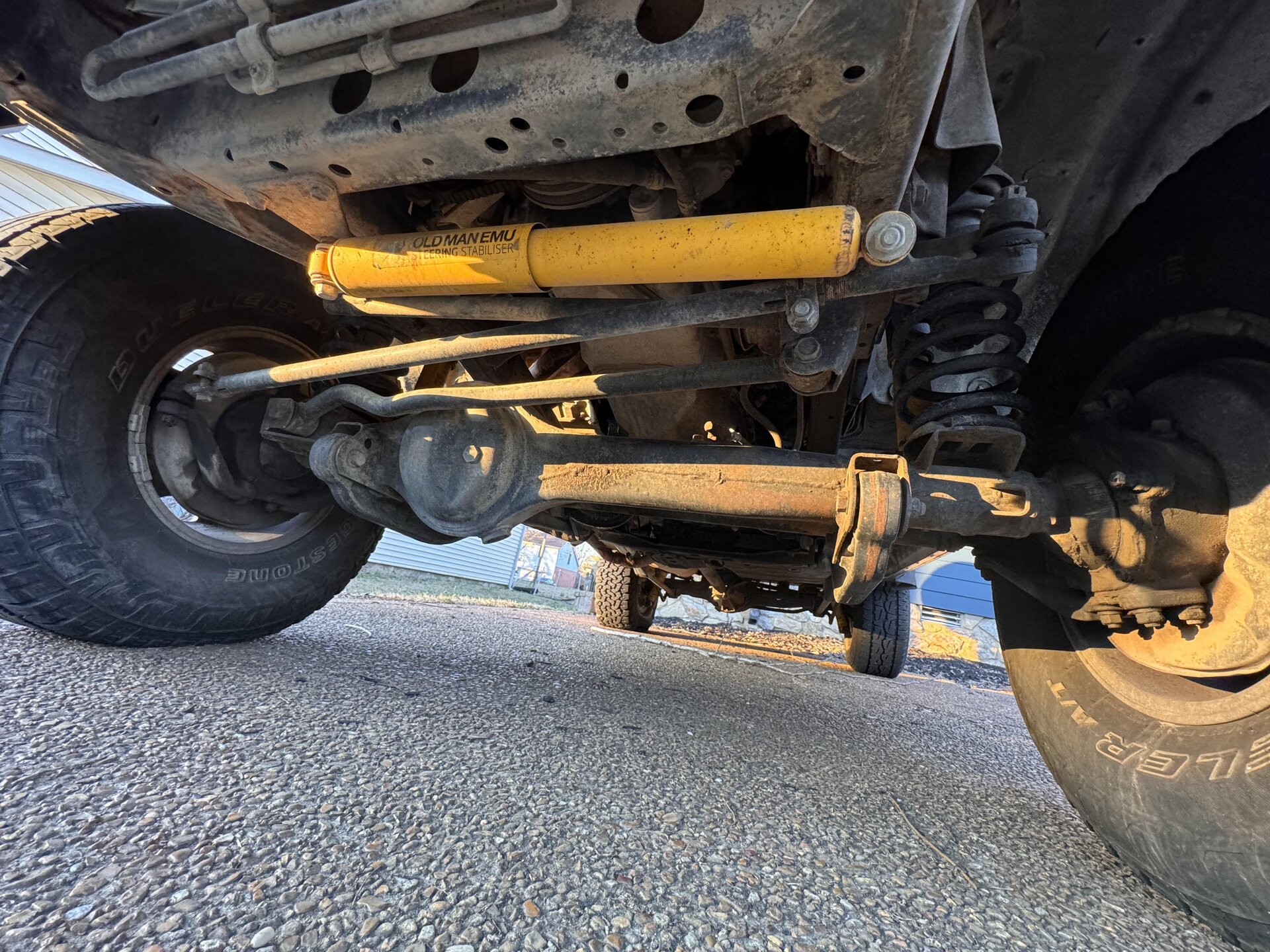

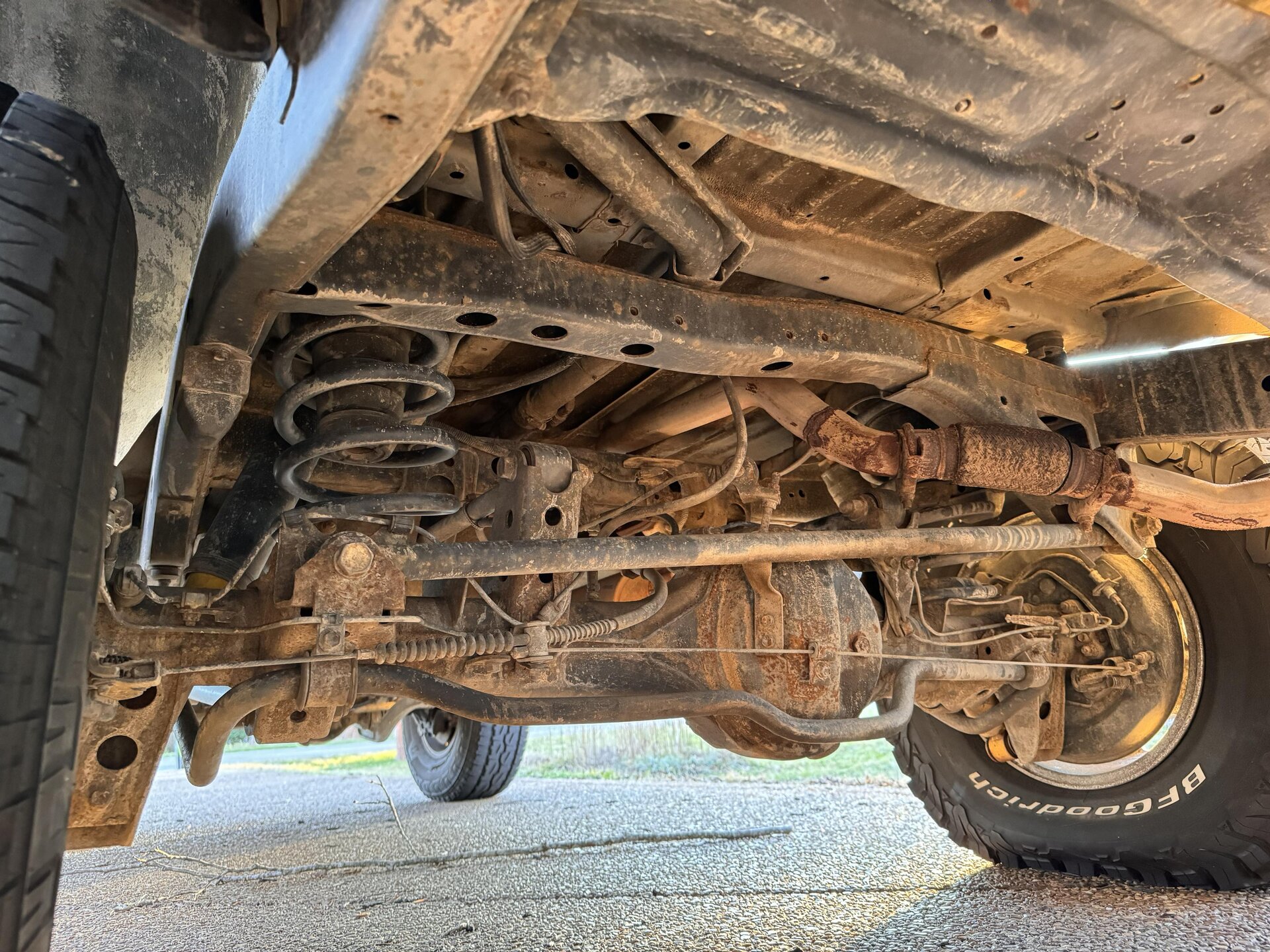

Hi there! I found a '97 that looked decent on the exterior and interior, but looks a little troublesome underneath. Should I pass? Thanks!
Rust doesn't look hateful to me, but the mix/match and half flat tires, ghetto exhaust, etc. is what would make me take pause on the maintenance by this owner...
If the price is right, that amount of rust wouldn't scare me away for what I can see in these pics.
Its not crusty/flaking rust really. Not light surface rust either.
If the rest of the vehicle is in good shape.....I wouldn't 'pass' on it from what I can see. IF it also has body rust that would be a deal breaker for me....or if the price were too high.

It's all relative, if you have to ask then it's too much rust.

It really does not look bad 🤷‍♂️
Check the body carefully, behind the running boards, inside the quarter panel cavities, bottoms of the fenders, rear rocker panels, rear hatch, wheel wells, around the windshield "frame" area, in the engine bay, inner fenders, ---.
Agree, some of the "rust" looks like mud.
Swivel balls look dry as a chip, get ready for a front axle service.

No judgement. Simple fact is, rust that is significant enough for you to ask about us enough to mean you will fight every bolt and nut you touch

I still think that's mostly mud, but... $22k seems steep to me.
Put it this way, the kind of guy who has a 25 year old vehicle that's worth $22k would have pressure washed the mud away himself before he put it on the market. We haven't seen the rest of it, but based on that it's probably not spotless.
