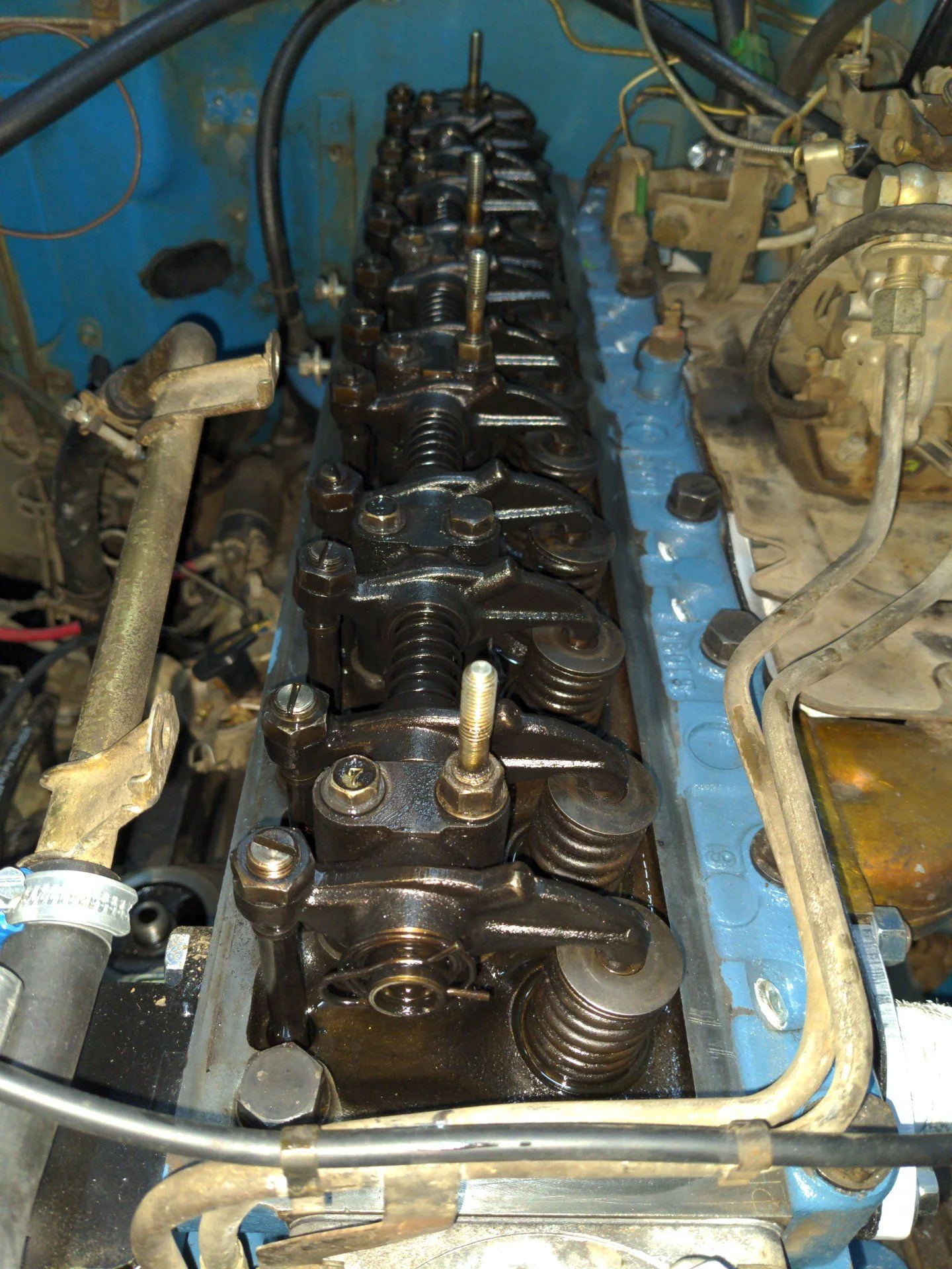

Since you have the valve cover off, it is easy to confirm the # 1 piston is at the top on the compression stroke, by checking the two rockers for the # 1 cylinder which are the two furthest forward. They should have a little play in them. I like to just grab the push rod with my thumb and fore finger and rotate and/or wiggle them. Both should be loose. If either are tight then you are on the exhaust stroke which is wrong for setting the distributor. If this is the case, then you will need to rotate the engine one revolution and back to TDC. And when you do that, the rotor on the dizzy will be pointing 180 degrees from where it should be and you will have to remove, rotate 180, and re-insert the dizzy.
And while you are checking for loose push rods, check the # 6-cylinder push rods as well. The # 1 and 6 pistons come up to the top together but are always on opposite strokes. One on compression and one on exhaust. So, when at TDC, only one of them will have two loose push rods. And if you rotate the crank one turn back to TDC, that will reverse. HTH

I did get the #1 cylinder both valves loose as mentioned, but here's where I'm not sure if what I did was right (spoiler alert it's wrong because it still didn't work)
rotor was pointed at either #2 or #6 WIRE, I pulled the distributor, using screwdriver turned oil pump to point to #4 CYLINDER more or less, re-seated the distributor so rotor was now pointing to #4 CYLINDER with distributor seated. Plugged everything else back in and tried to start it with no joy. One thing I have not really done is I have not opened the timing cover to make sure it's in place which admittedly could be causing the problem.
