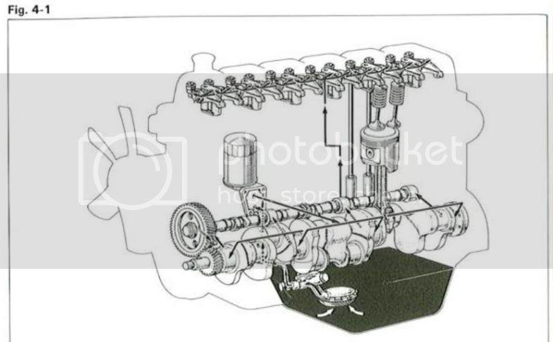

It can take a few minutes to get oil up to the rocker shaft. The camshaft either must be spinning or positioned just right to allow oil up to the rocker.

No. Throw the dist. back in with the rocker shaft off and just crank it. Do not start the engine, it wont start anyway with the rocker shaft off. Then see if the oil is making up to the head. The idea here is that the cam is probably out of position, and not allowing the oil to get to the head. If the engine is cranking (spinning) it will allow the oil to find its way into the oil passage leading to the head.
