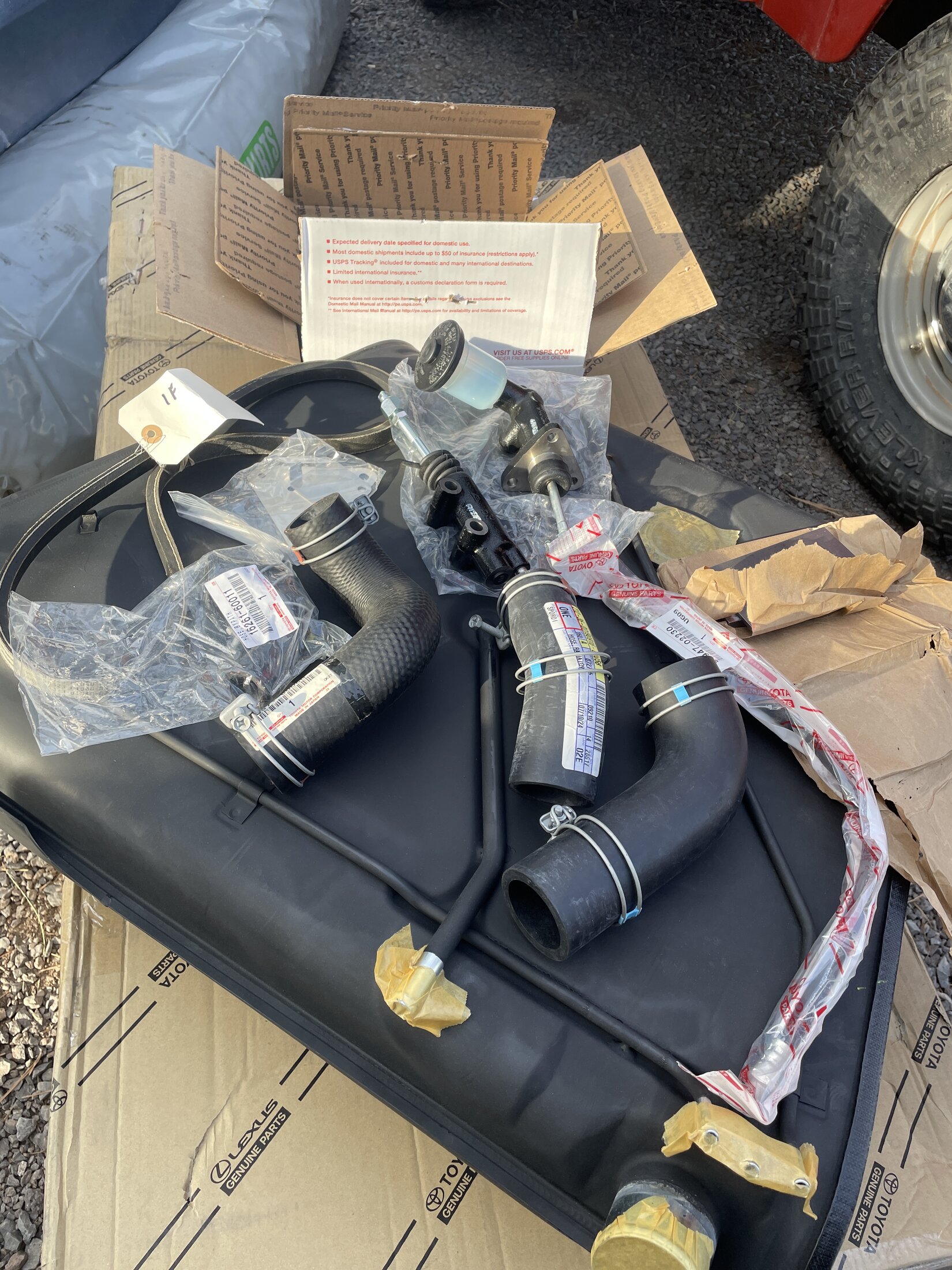

Have failed clutch master cylinder on my 64 fj40. Don’t believe this to be OEM (pic) …. but don’t have the expertise to know for sure. Any help identifying the component, replacement option, or rebuild kit greatly appreciated. Thx!

lots of stuff going on in the pic
not stock for 64,
which side of the bellhousing is the slave cylinder located?
the hose off the master is not stock

Thanks for your reply. The mc and sc are not stock for a 64. Likely off a 71-75. I found like replacements for both and will stick with them. The truck body is near original but not the drivetrain. Thanks again!
