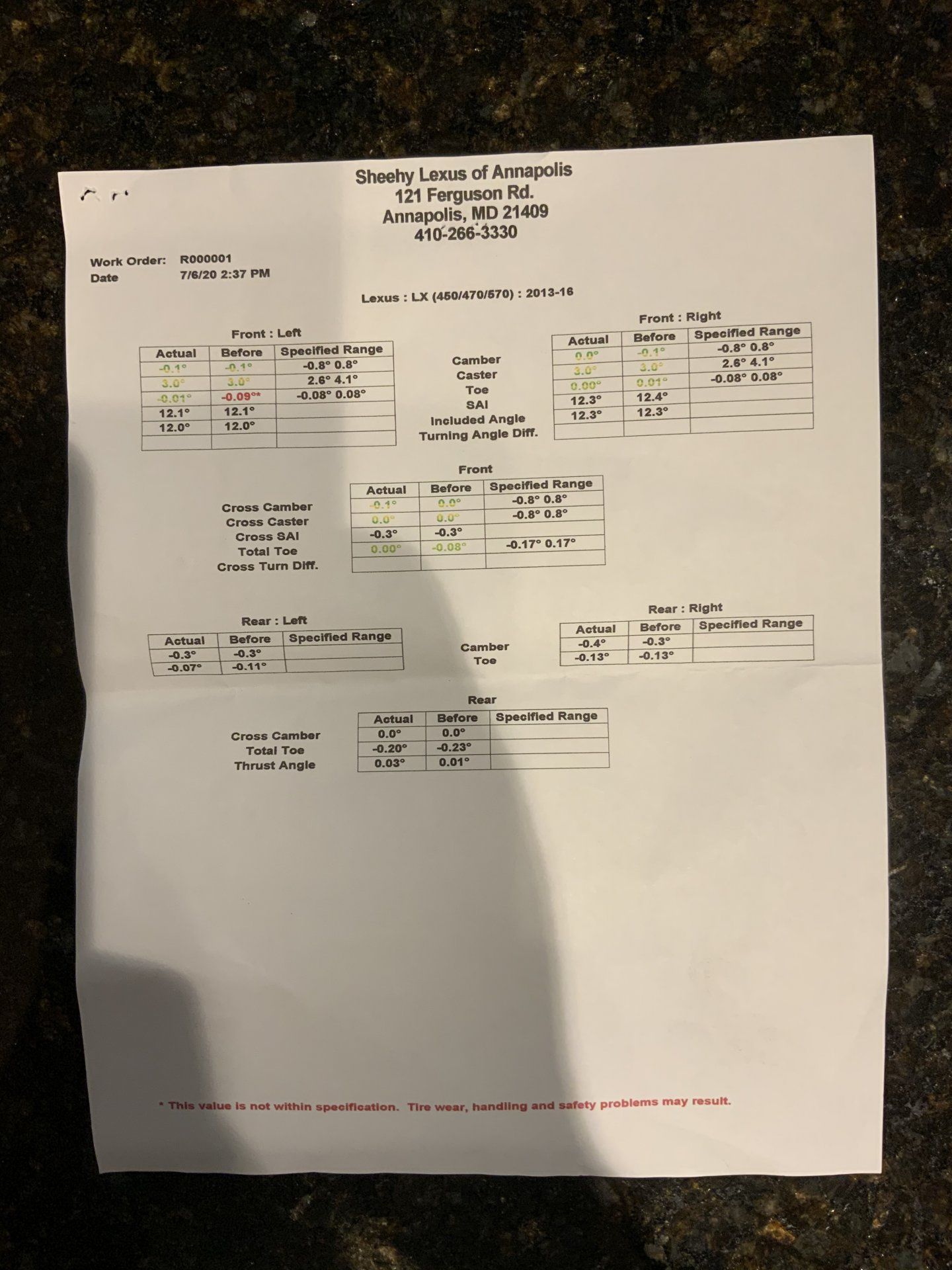

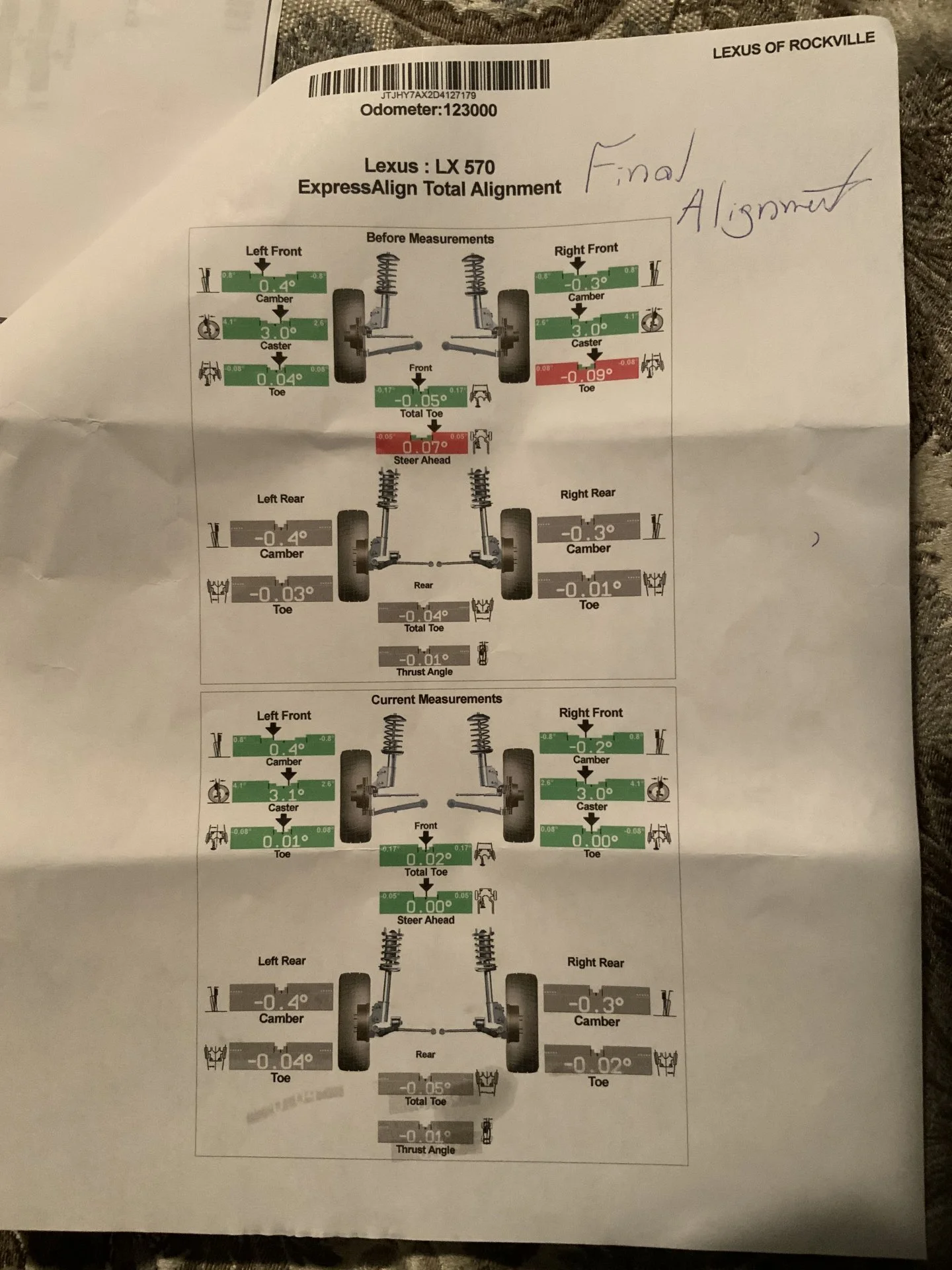

Okay, not totally. Yes it’s reliable. The power is nice. However the handling is terrible! 13 LX570 123,000 miles. The steering wheel moves and twitches even over the slightest bumps. Highway driving over bumps are sooo uncomfortable the truck feels so unstable in the front end.

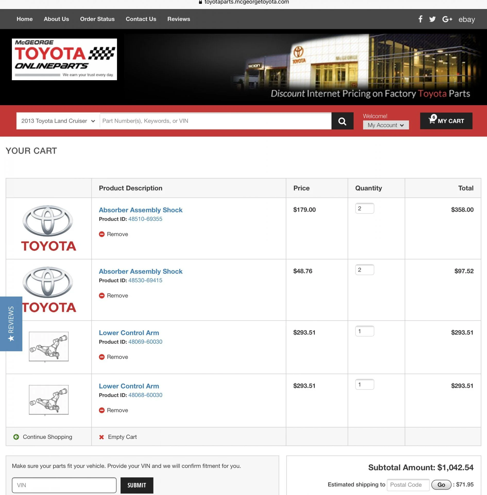

Perfect alignment toed in tracks straight! AHC fluid changed at 100k miles. New upper and lower control arms, outer tie rods, sway links. Tires rotated and balanced multiple times on Michelin Defenders excellent tread full range of tire pressures explored.
Multiple dealers says “truck drives normal, they all drive like that”. Lol well if they do Lexus wouldn’t sell any! I don’t want to sell the truck as I love the Mark Levinson and comfort however I can’t drive it like this with the loose front end!
I’ve already spent $4000 on the suspension, any other ideas before I contemplate trading in for a Mercedes GLS 550?

Dang. why do you keep starting new threads? You've literally started over 6 different threads about your steering issue and you've probably had that many alignments. Everyone said you needed more toe-in, and then you went and dropped "4k on suspension parts"??
Wasn't everything fine until you got new tires and your first alignment

Is the shop doing the alignment experienced and thorough? It's possible they're just giving you the ol' "toe and go" and they're not adjusting important things like caster.
