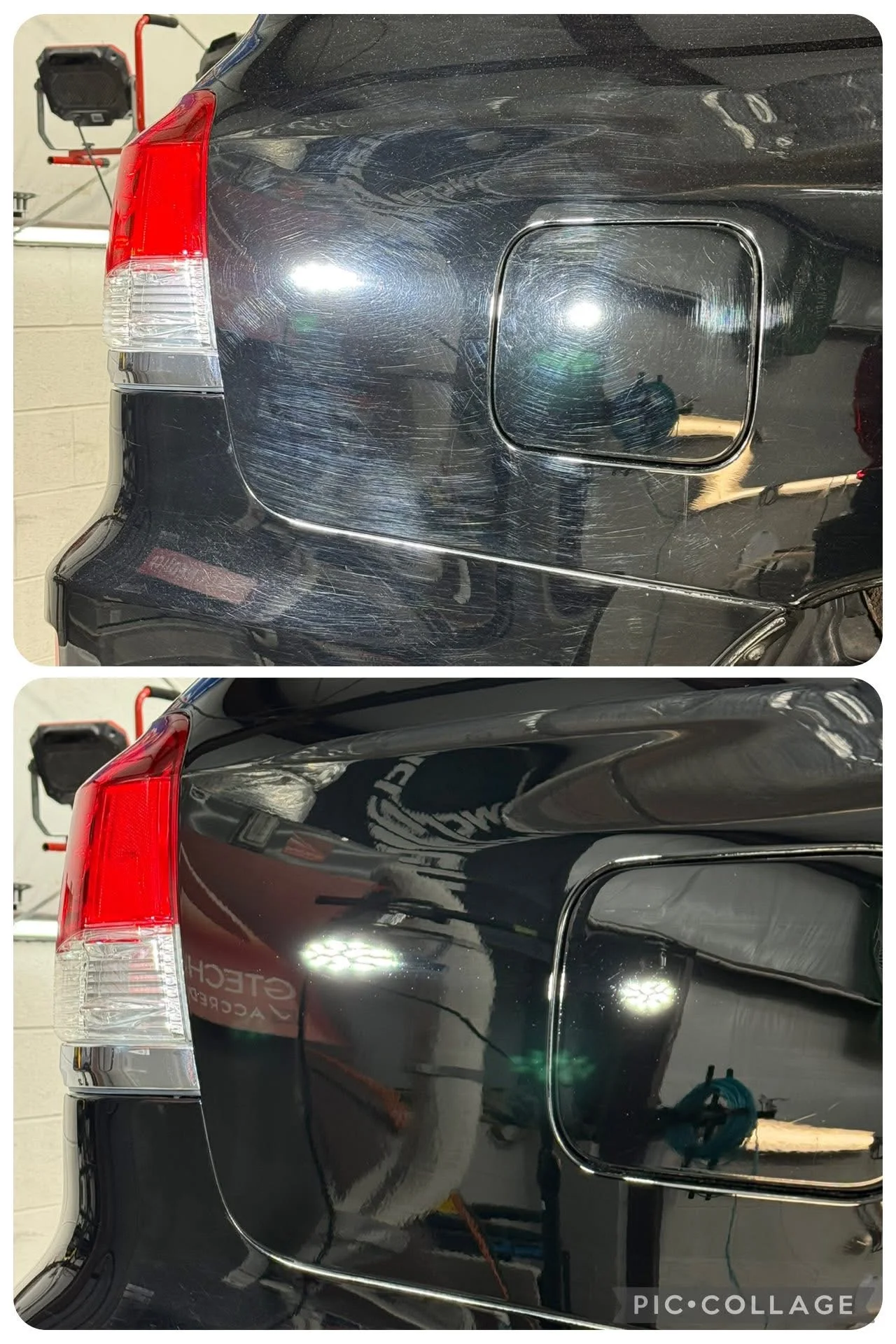

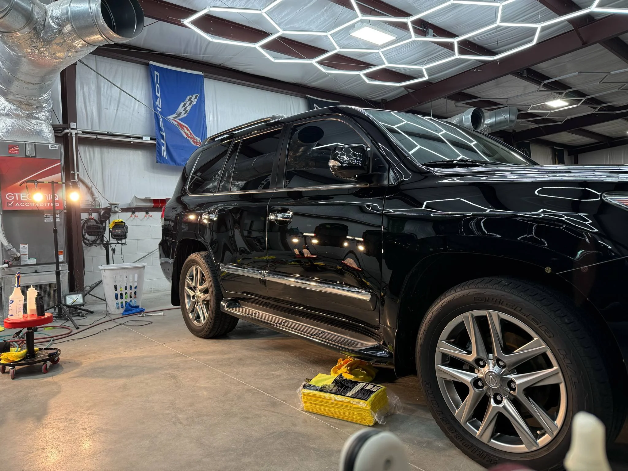

5) I did take it to Finishing Touch in Maryville, TN where we live and have them 1-step paint correct it and ceramic coat it...difference was huge. I think only cost $895.
Here's pics of it in stock form...had 155K miles on it when I bought it a few months ago. So, my request is to get help from all you 200 series experts on how you'd build it, what parts are best, and what to stay away from. I have many ideas and like to do things differently to experiment and push the limits usually, but not sure I want to go this route this time around or not...but maybe lol. Not really concerned with the money side of it, more what's the best options out there. We'll take this vehicle cross country, probably tow a small enclosed ATC toy hauler with our RZR Turbo S, my son's dirtbike, and maybe our Single Seat RZR depending on who's going with us. Might use my F-450 to tow all of it too on a bigger trailer, so just depends what our trip plans look like. But, I want it to be versatile yet very capable without getting insane I guess.

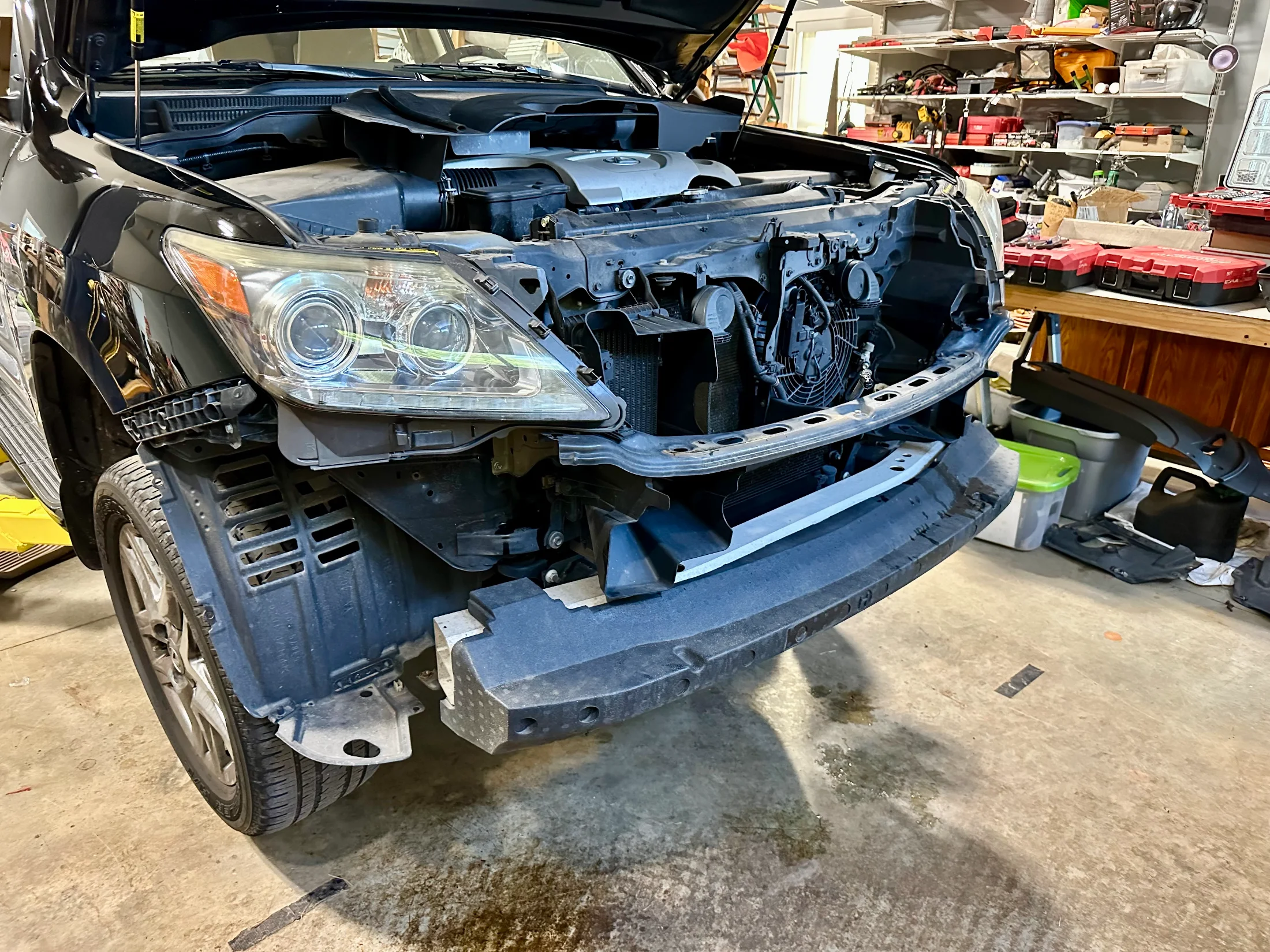

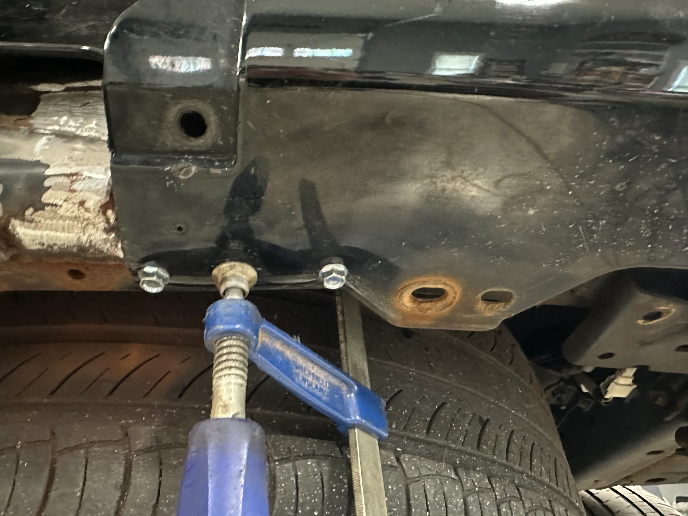

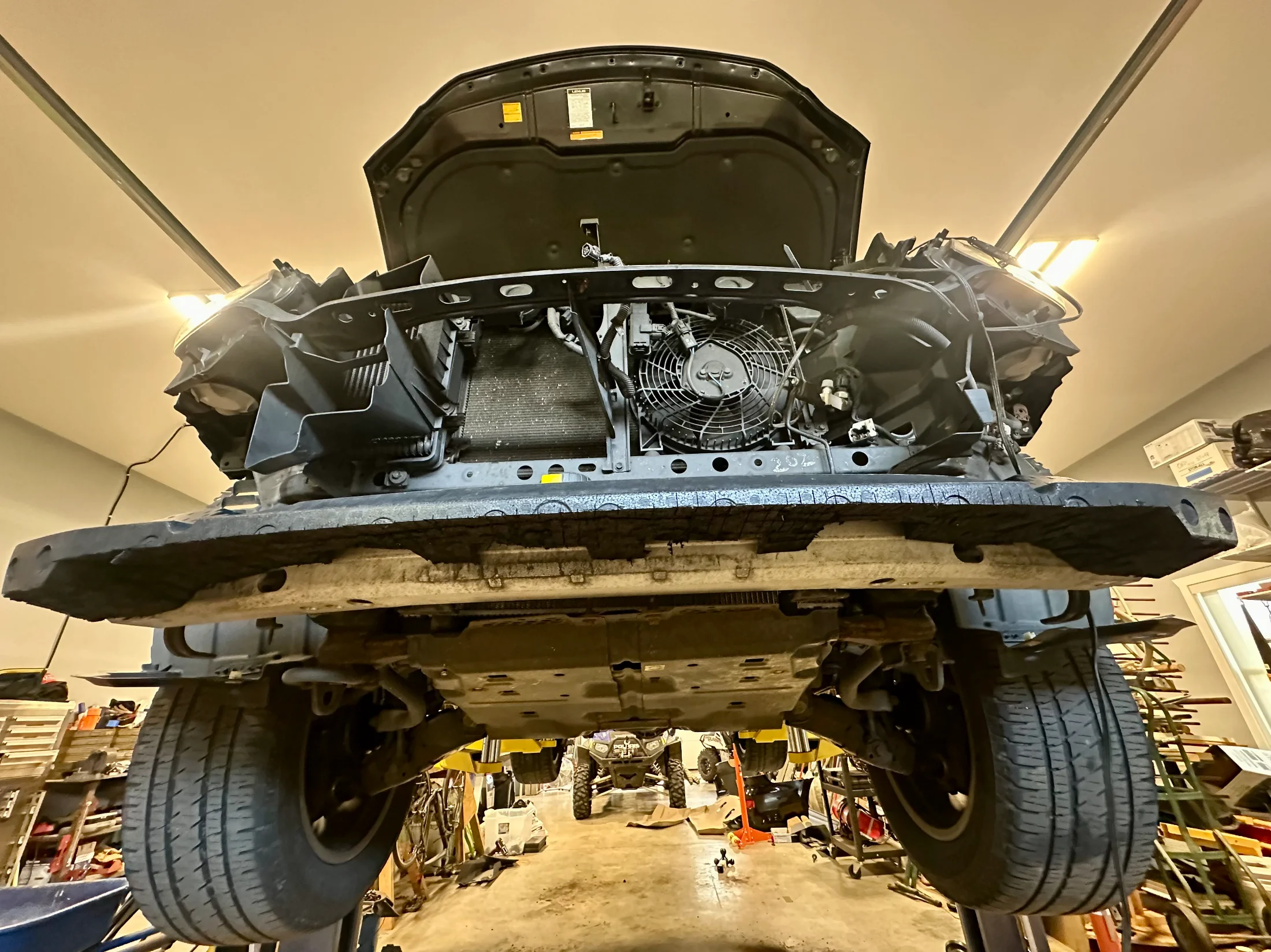

Next in line is I've started tearing down my 2013 LX 570 to install the 1.5" body lift from Micah at NST Spec. So far no issues. I sprayed all the body mount bolts from the top and bottom to start, then came back the next afternoon and all of them came right out no problem. I disconnected the radiator shroud's 4 bolts, loosened the driver's side and completely removed the nuts from the passenger side. Today I'll raise up the passenger side and begin installing the pucks. But, otherwise, pretty simple disassembly so far, and Micah quickly answered some questions I had before lifting. But I'm going to lift slowly without releasing the front passenger wheel well bolt he mentions, the steering linkage, and the gear shifter to see how it goes and whether or not it's needed or not to do. He did say I'll need to release and retighten the gear shifter from underneath once it's lifted, but that should be quick and easy.

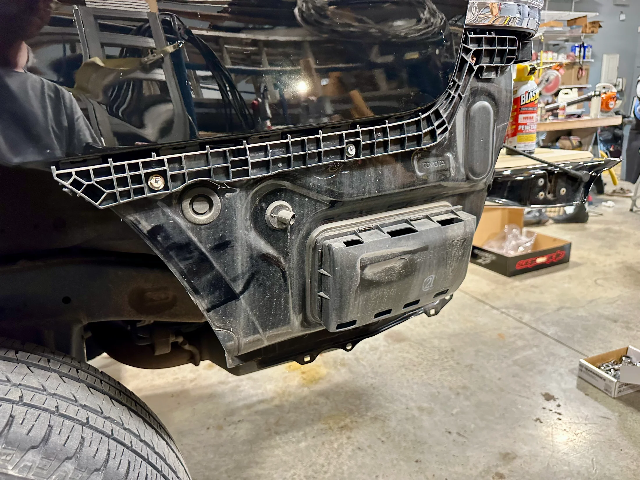

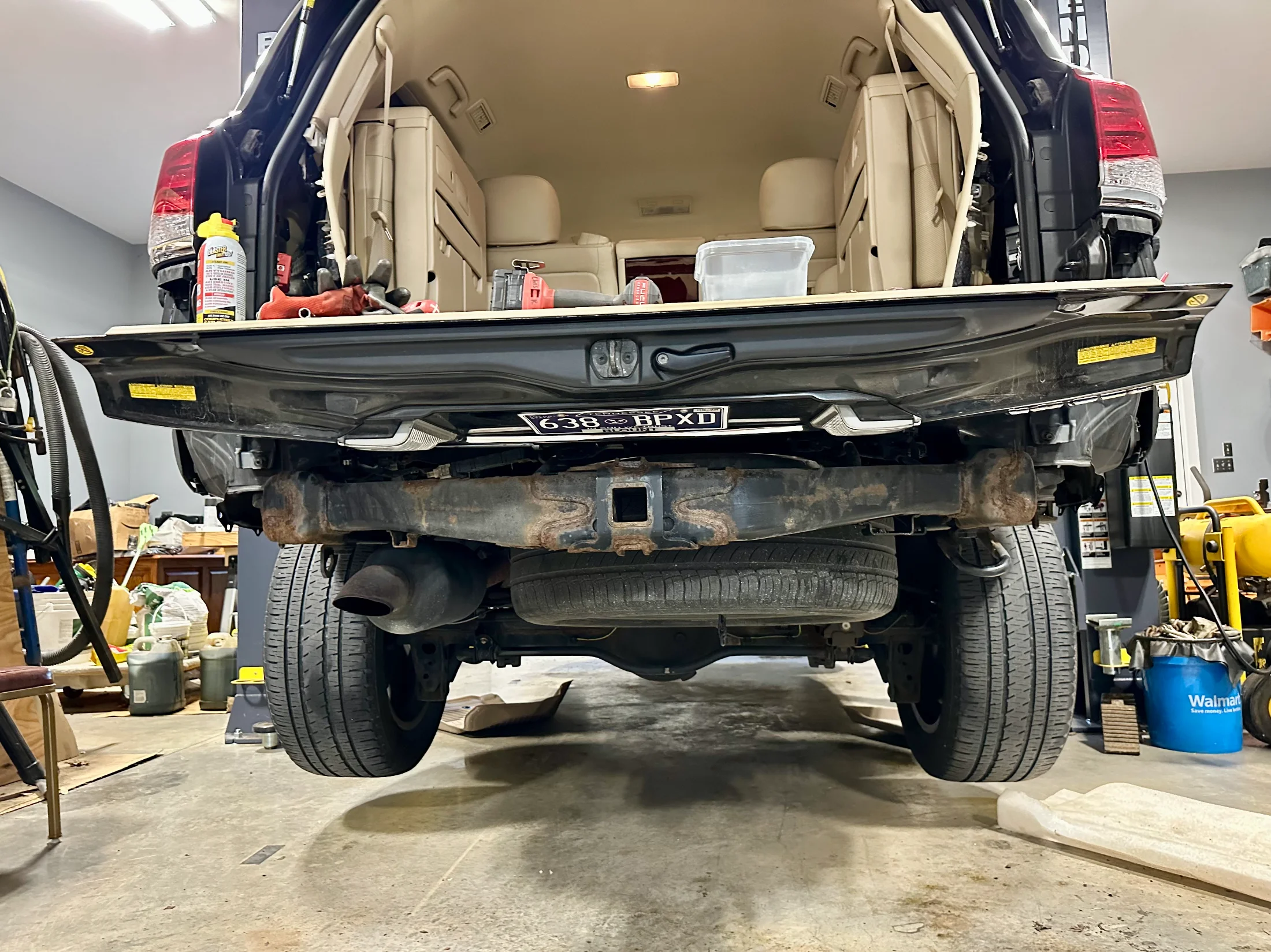

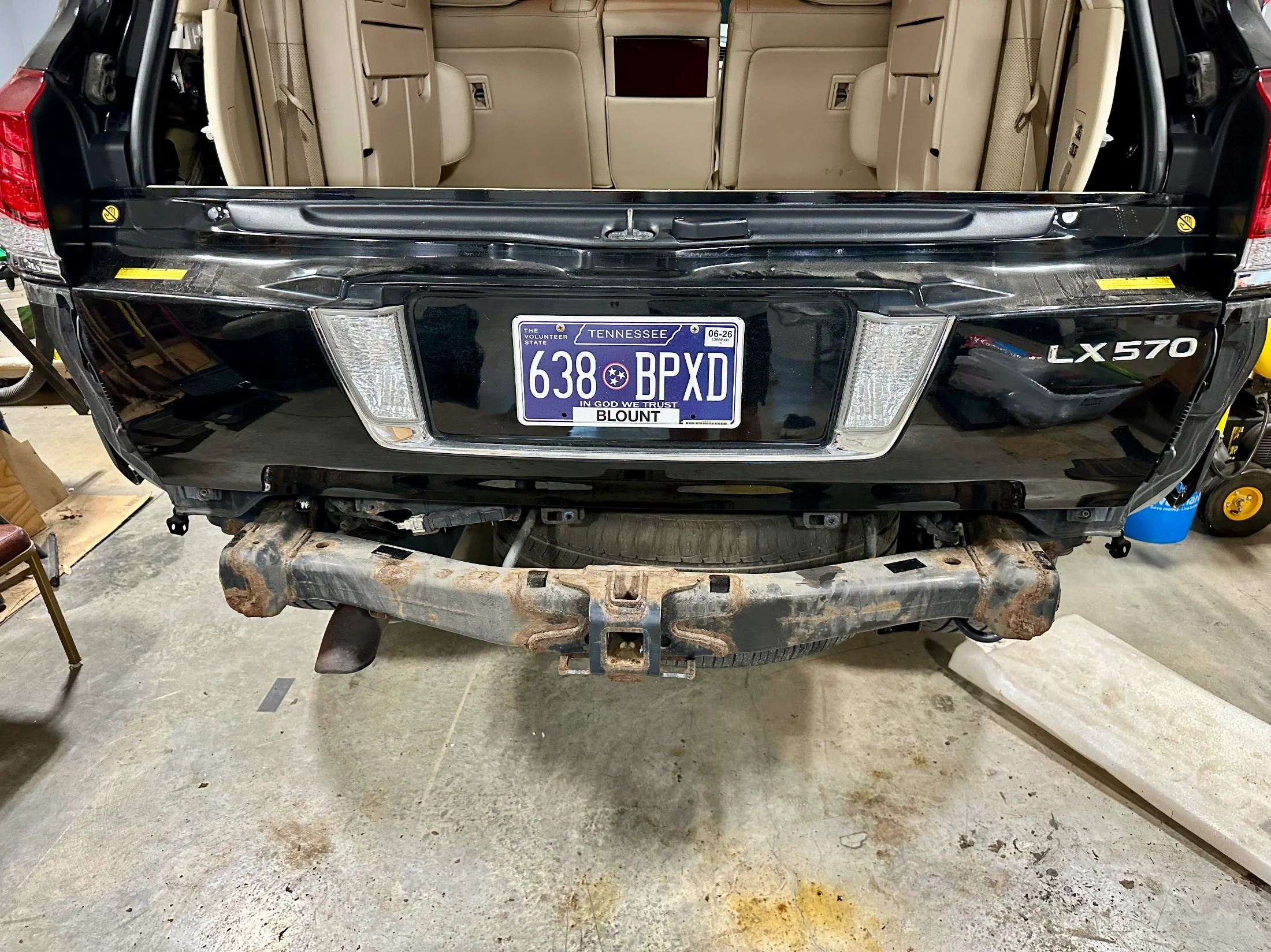

I'm unclear how the rear bumper that surrounds the steel frame/hitch will be able to be raised without cutting the entire bottom of it off...maybe I'm missing something on that process lol, but I thought I read through all his thread pretty well. :) I'm also unclear why the foam needs trimmed up front if we're moving up the entire aluminum frame piece 1.5" to compensate for the lift...shouldn't it just fit right under the bumper like normal again? I still have some more reading to do in his thread to clarify those things, but so far so good on the disassembly.

Not much else to report yet...yesterday I bought some jacks to place under the pinch welds, so I'll use the lift to raise the whole truck frame, then place the jacks under the pinch welds, then lower the lift slightly to create the 2" gap to slide the pucks into place, then raise the lift again to put full weight and tighten. Then I'm guessing I'll loosen them a tad again so they'll move un-binded when I begin to raise the driver's side. It's been years since I've done a body lift, but seems logical to me at this point lol. Wish me luck...lol.

Did a couple more hours on the body lift tonight, and got all the pucks and bolts and nuts and washers into place and it resting on it's own weight on the frame again. Tomorrow or the next day I'll begin tightening everything down, mess with the radiator brackets, and then begin figuring out the bumper mods. I did break the nut off the crossmember behind the back seats, so probably need to weld the nut back to the frame, because otherwise it's just going to do absolutely nothing and just rattle around...not even sure it's doing a dang thing anyways, honestly. Popped some plastic pins that I didn't pay attention to, so need to find some new ones of those if anyone knows the best place to get some of the different types of push pins they use in all the plastics in the fender wells, primarily. Otherwise, I had to call Micah about why the driver's side wasn't raising up easily like the passenger side...the culprit from that bolt in the center of the truck under the middle row seats lol. I loosened the steering column by taking the bolt out completely, and it never moved, so I put it back in.
Chris

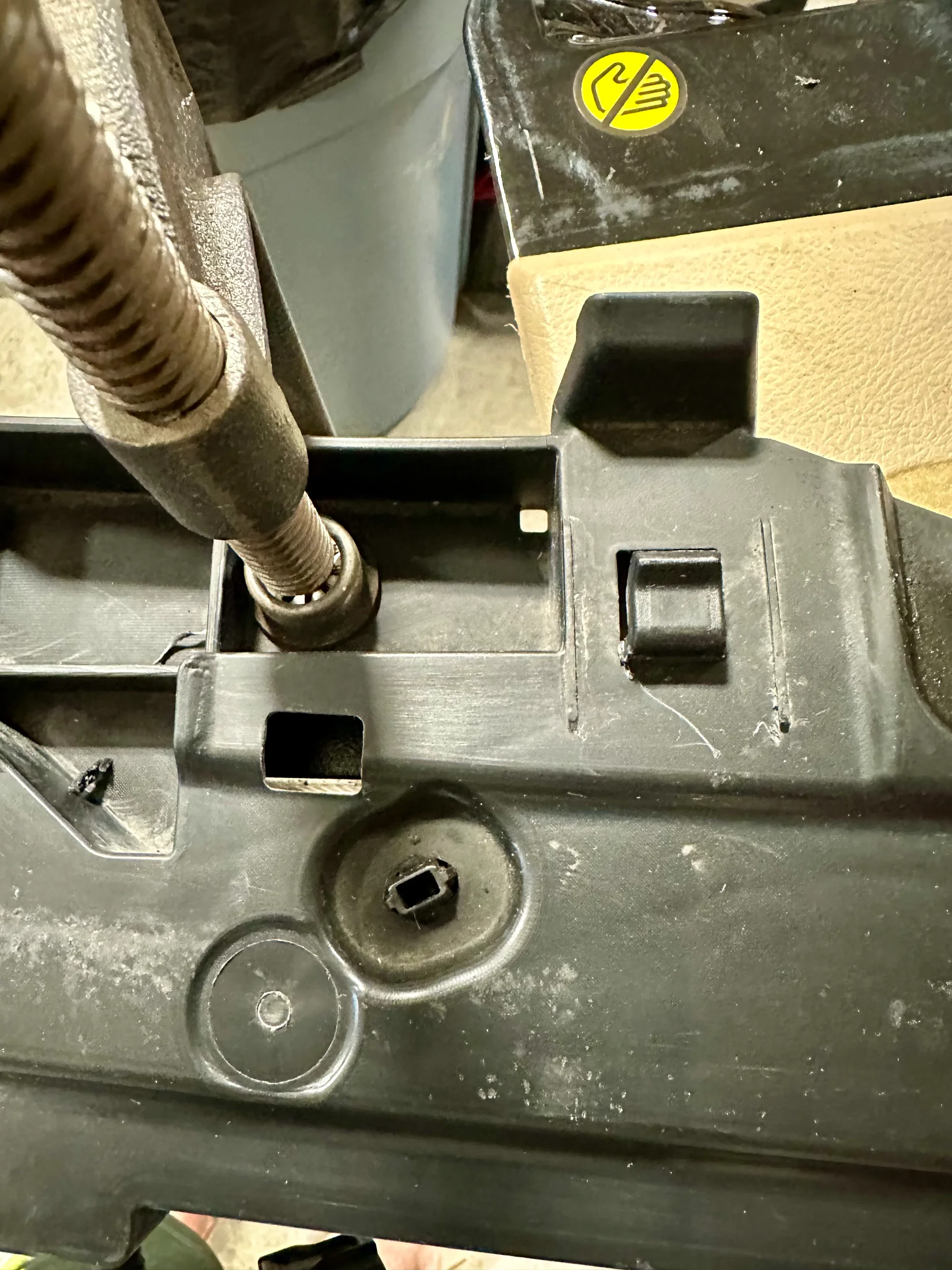

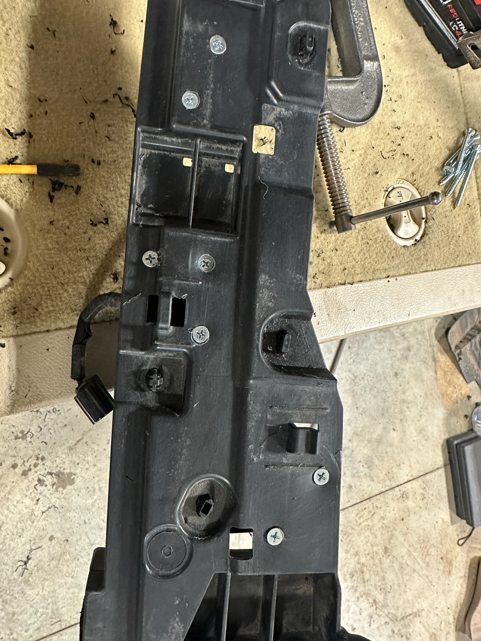

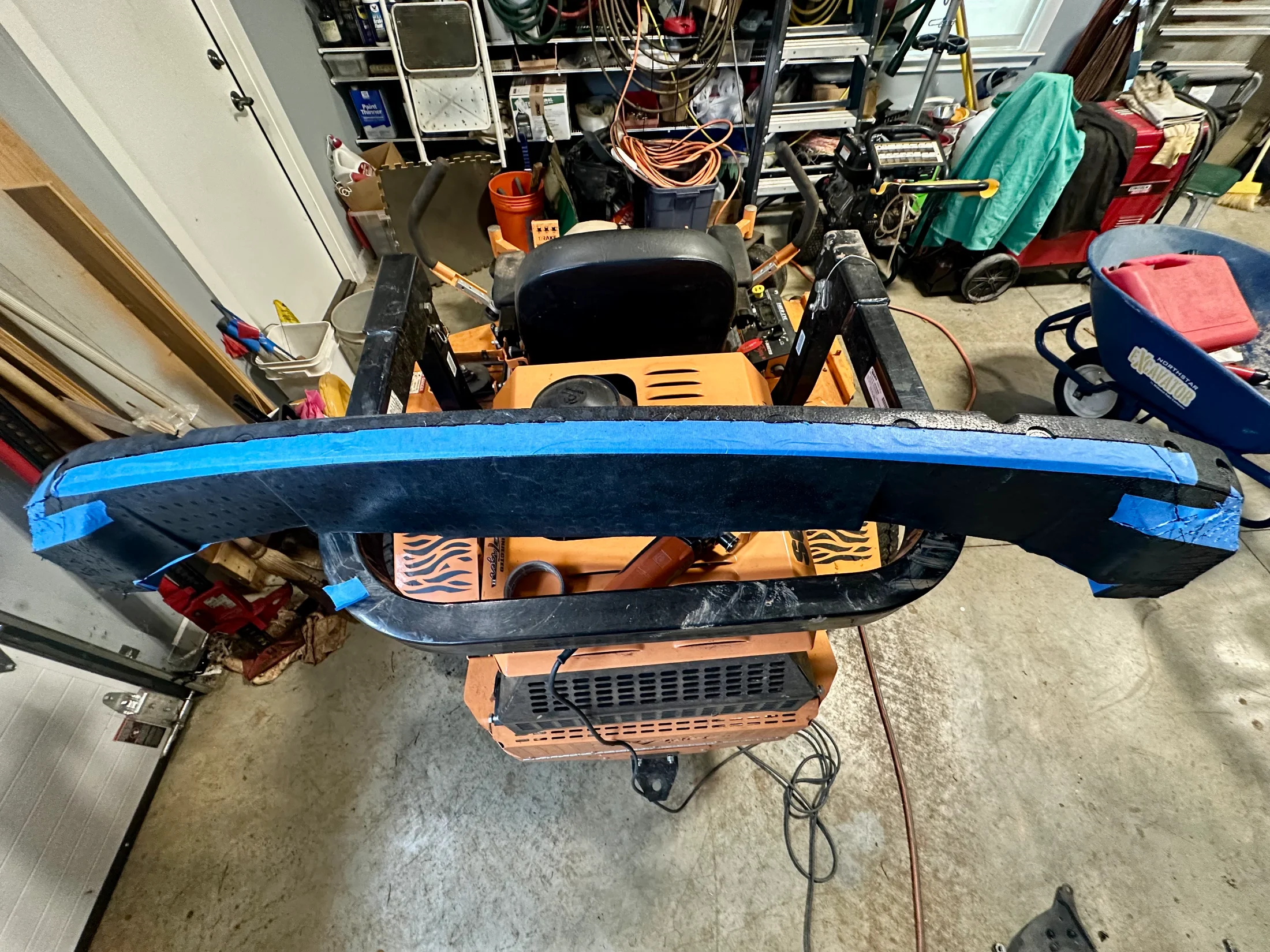

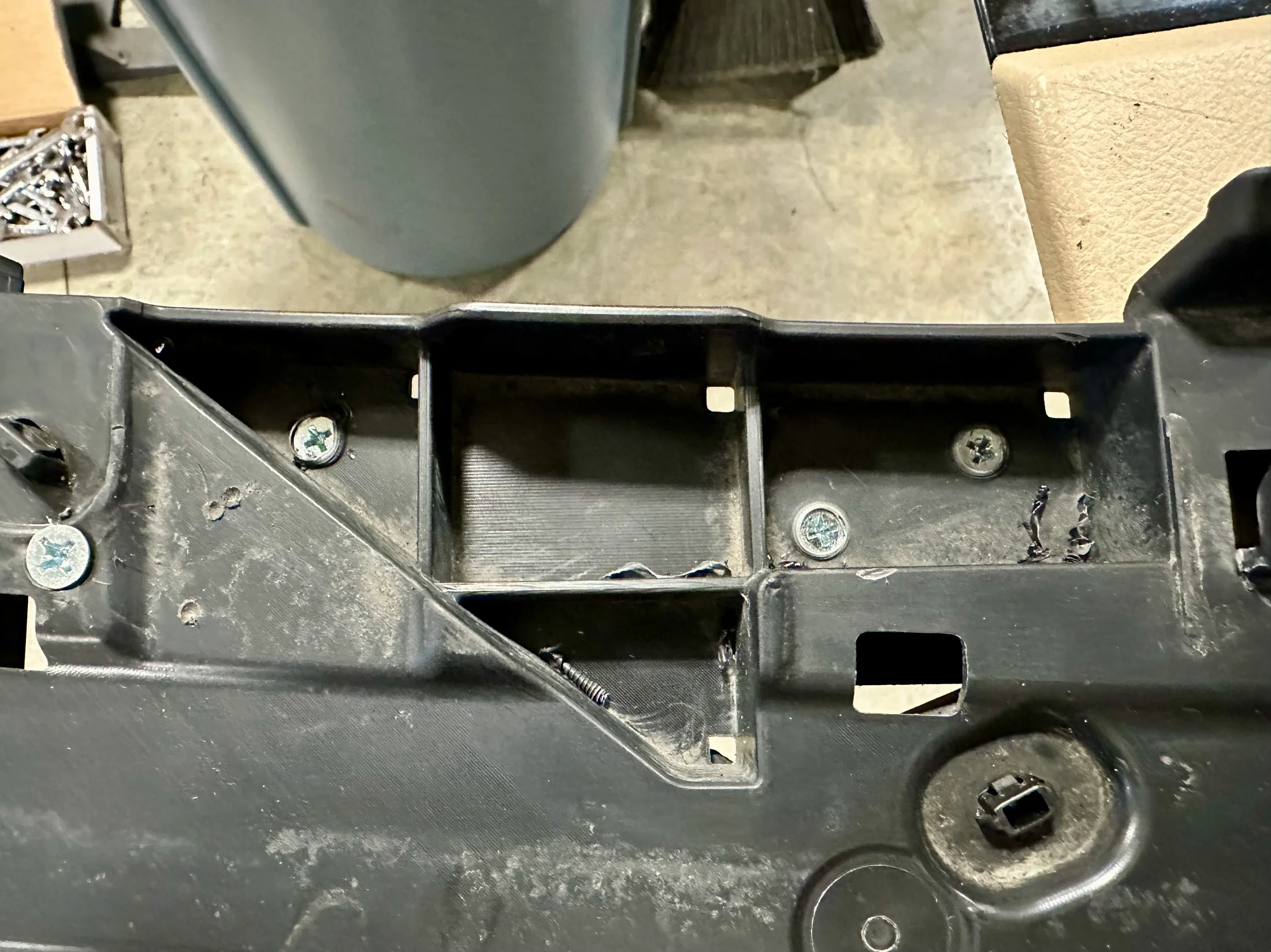

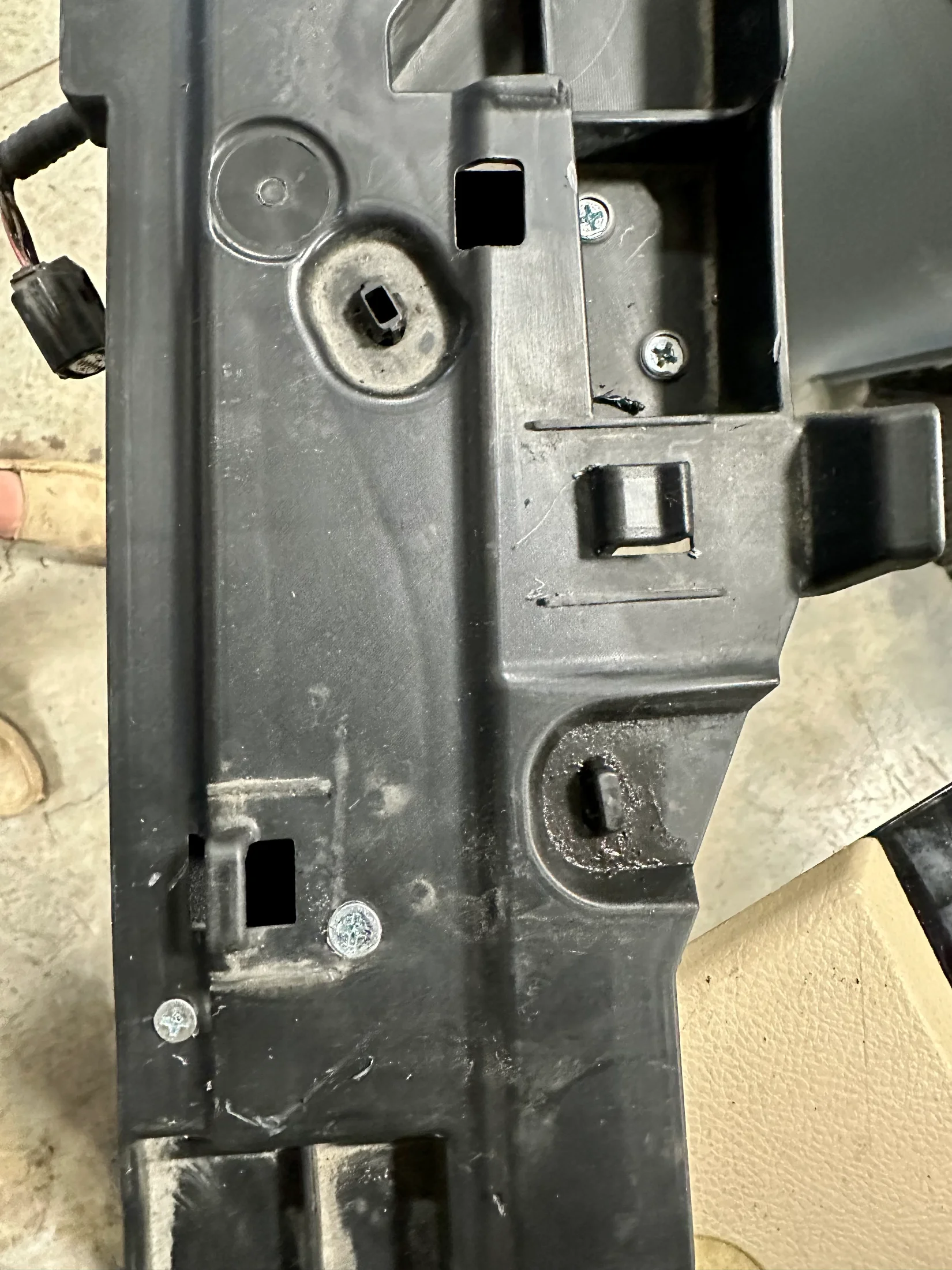

I ended up working on the Lexus a number of days last week and this weekend, and I have to say that this body lift is very time consuming when doing it by yourself. Here are a couple of lessons I learned through the process, and I'm not done yet lol:
1) Open the entire contents of the body lift and look at what appears to be the same parts, but are not. :) I ended up installing the lower radiator drop brackets up top and the uppers on the bottom. Not a huge deal, but Micah at NST made different ones specifically for the top and the bottom...I missed that in reading his thread...it was probably in there, but I miss it.

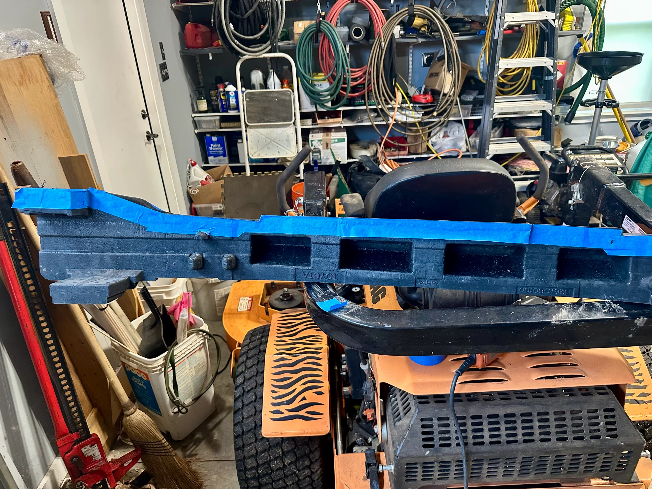

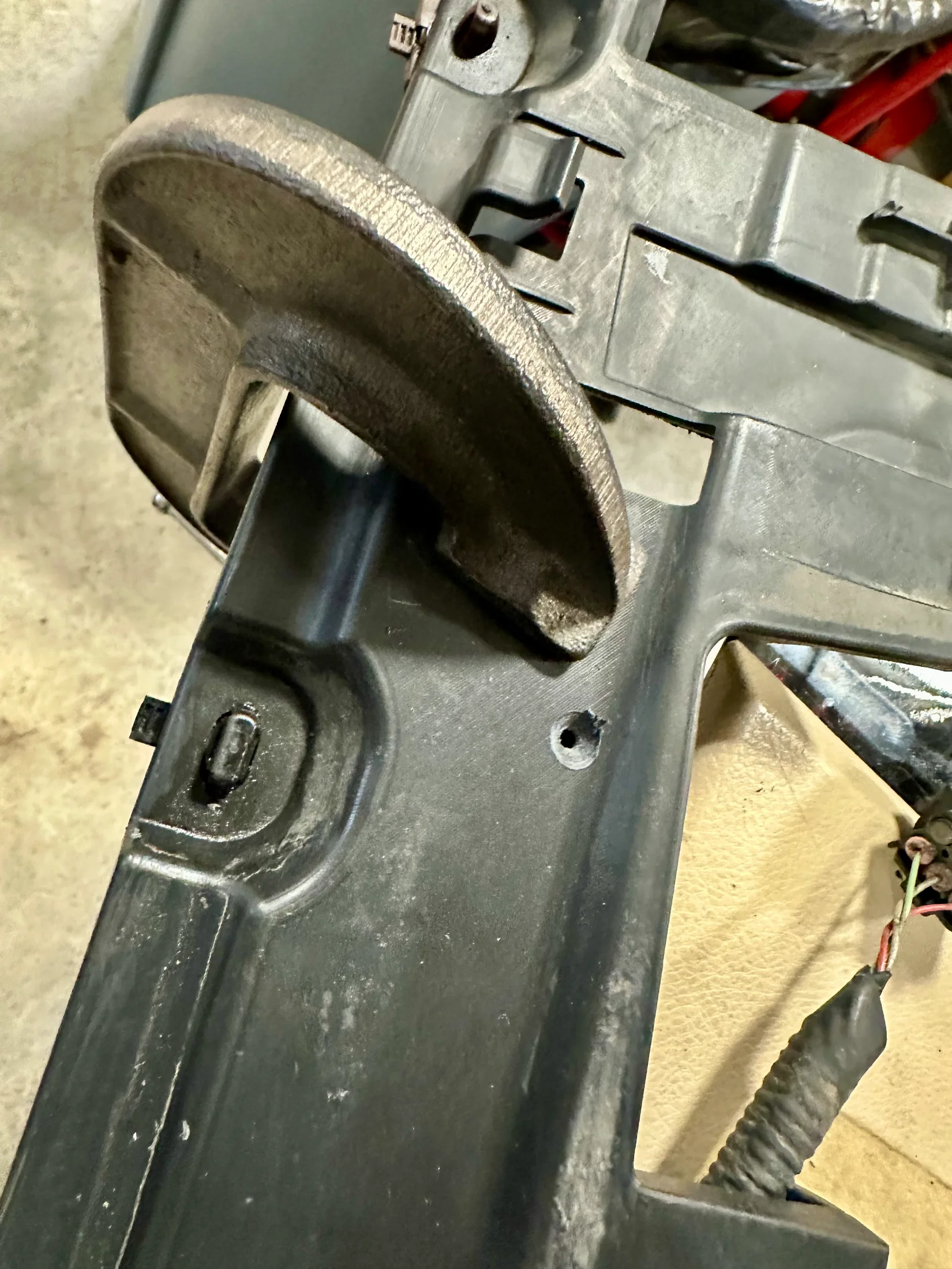

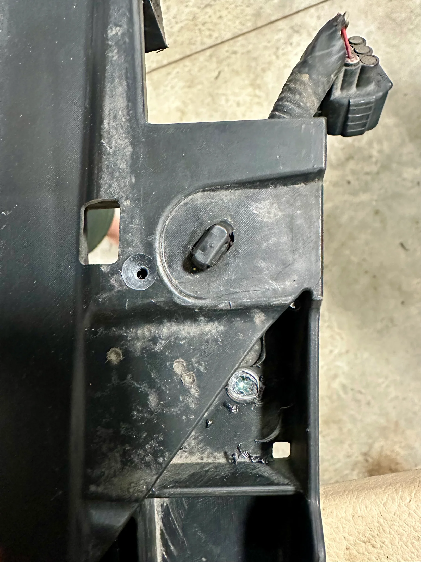

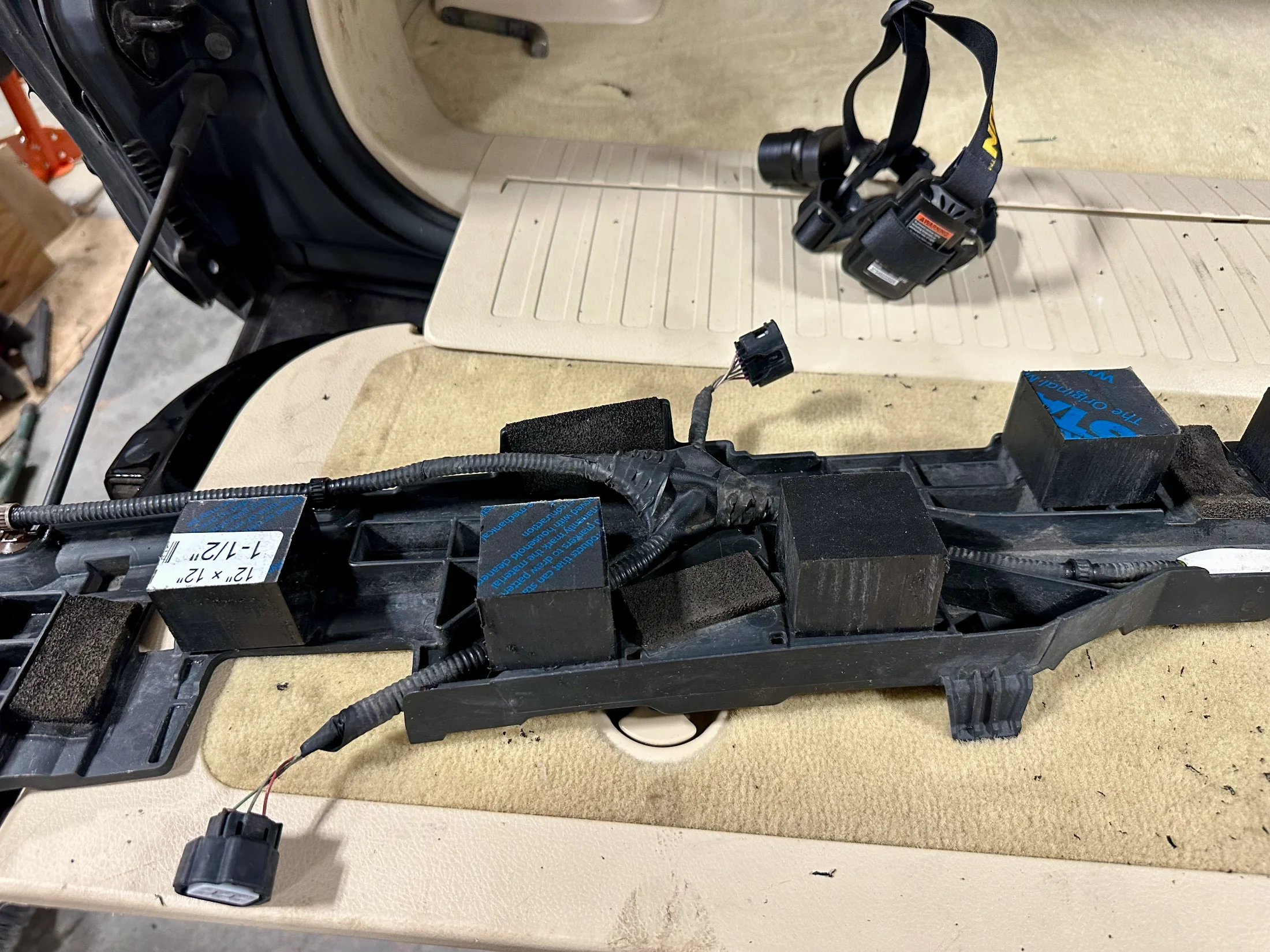

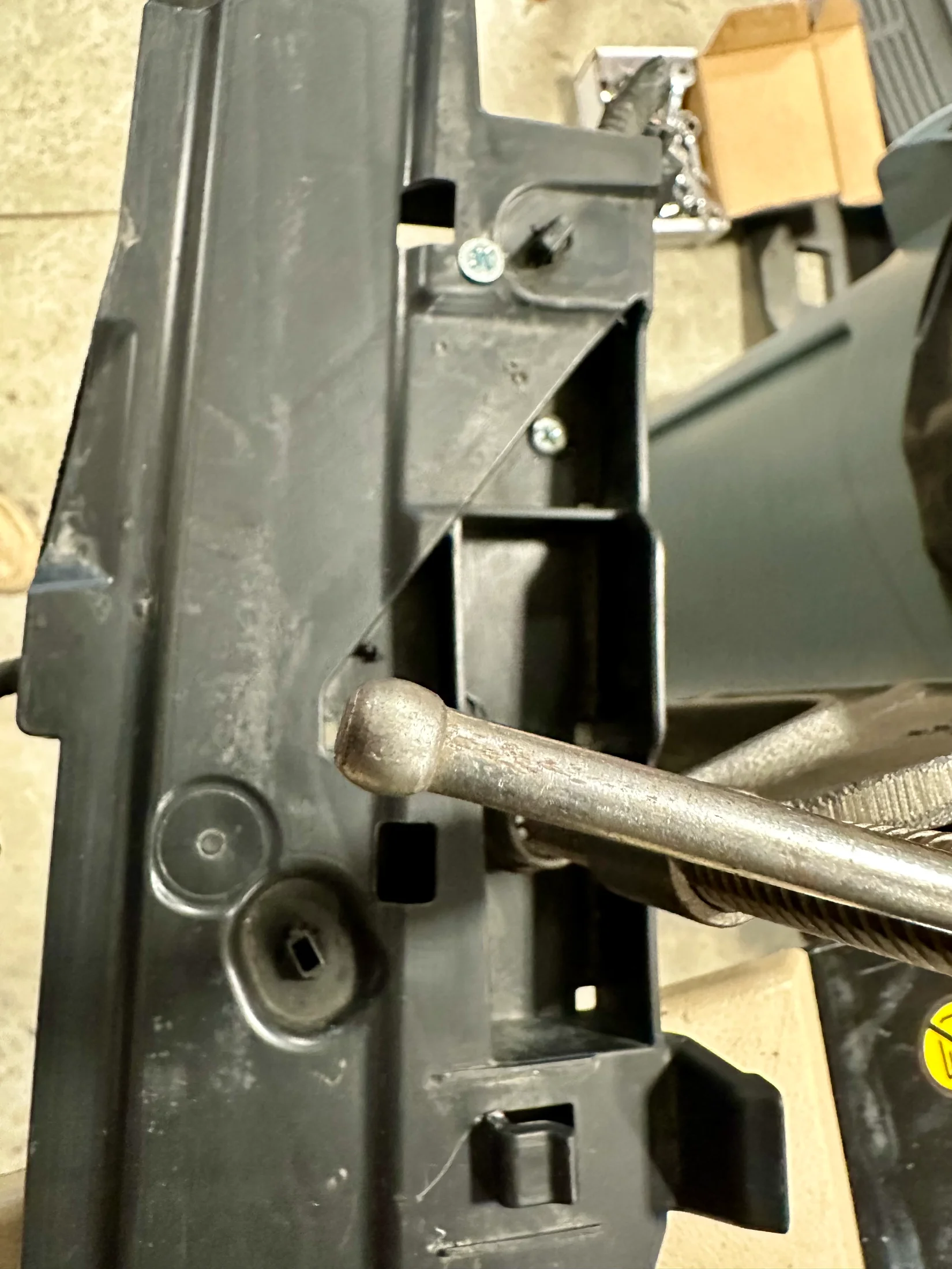

2) Shaving the front foam is pretty time consuming to sat the least. There's really no way around this part of the process and can't be included in the kit. I used a vibratory saw for the entire part of this. It ended up turning out great, went to mount the bumper back on, but there was still too much tension on the bumper for it to fit up properly. I didn't think I'd have to, but the fix was to take approximately 3/4" off the front of the foam, as well, and then it fitted to the truck perfectly.

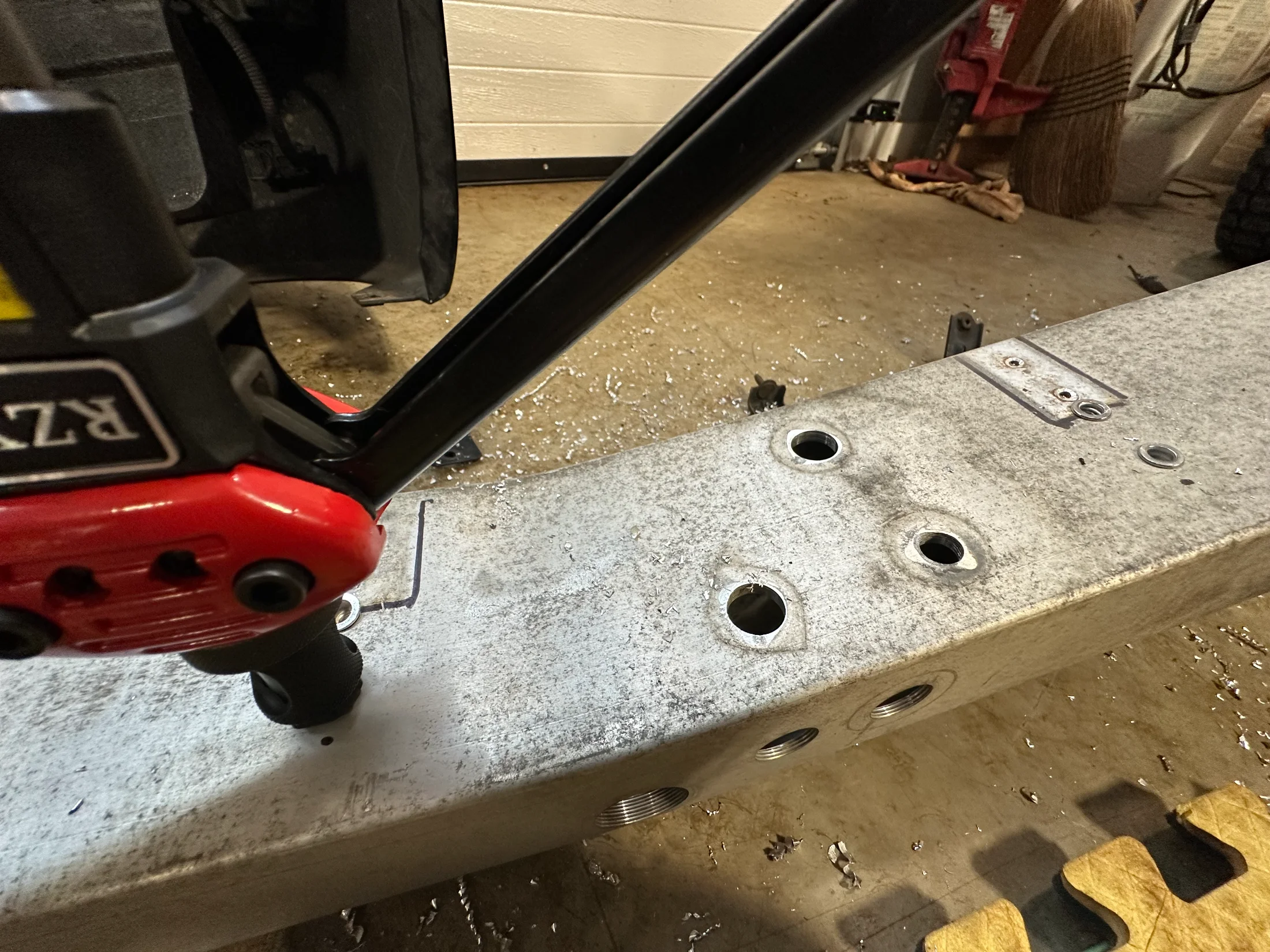

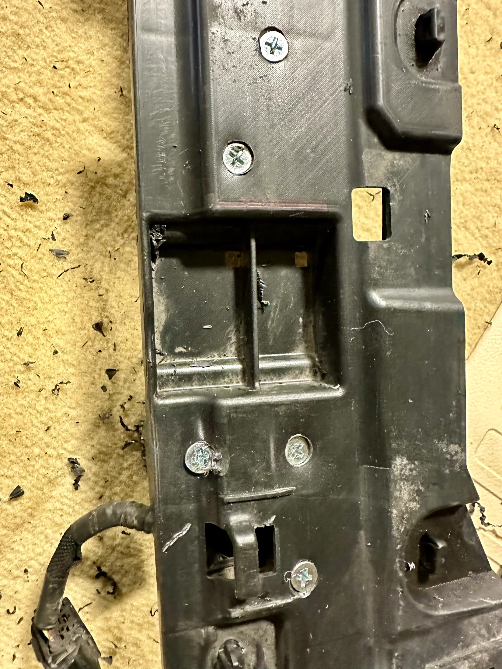

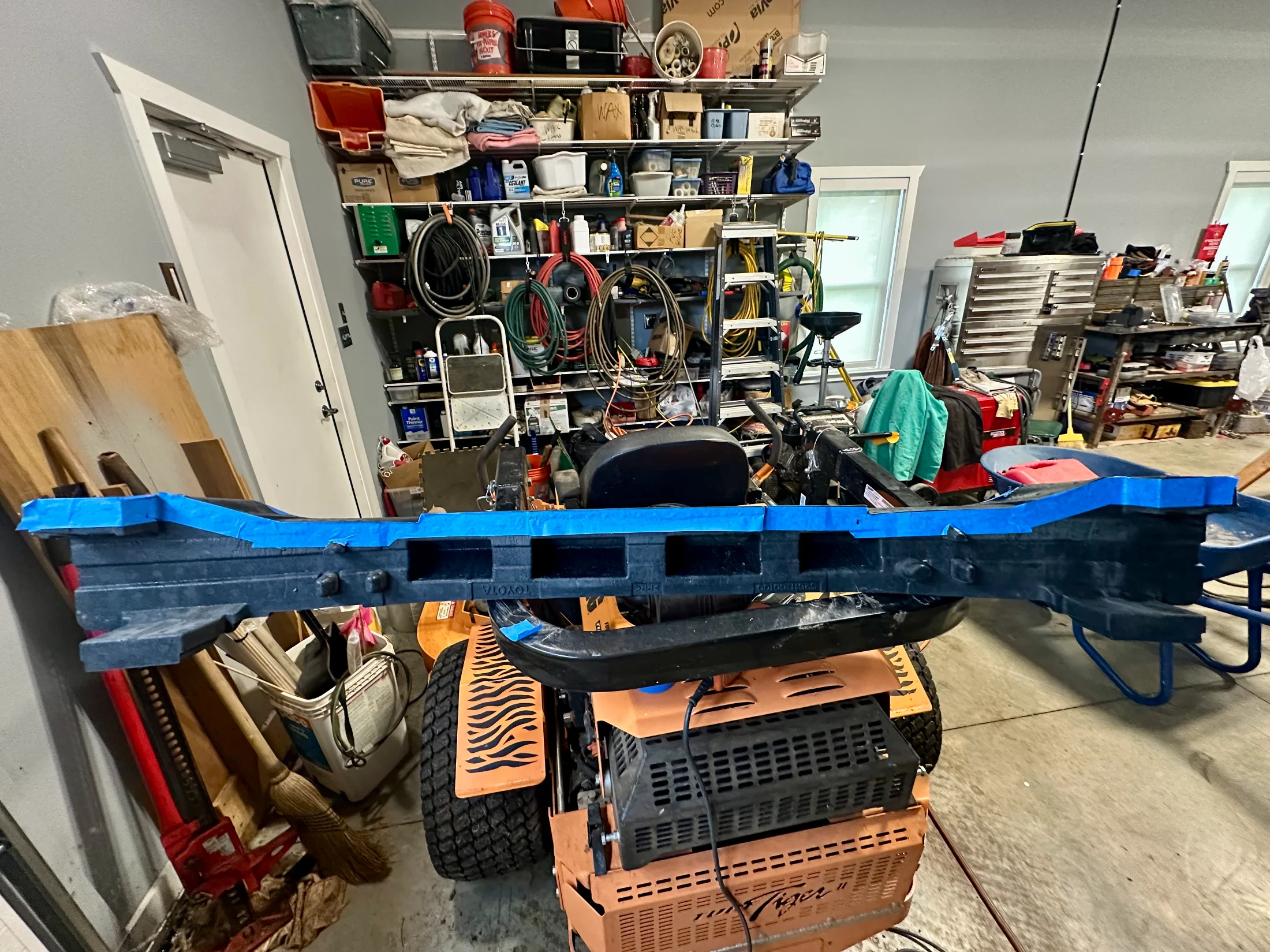

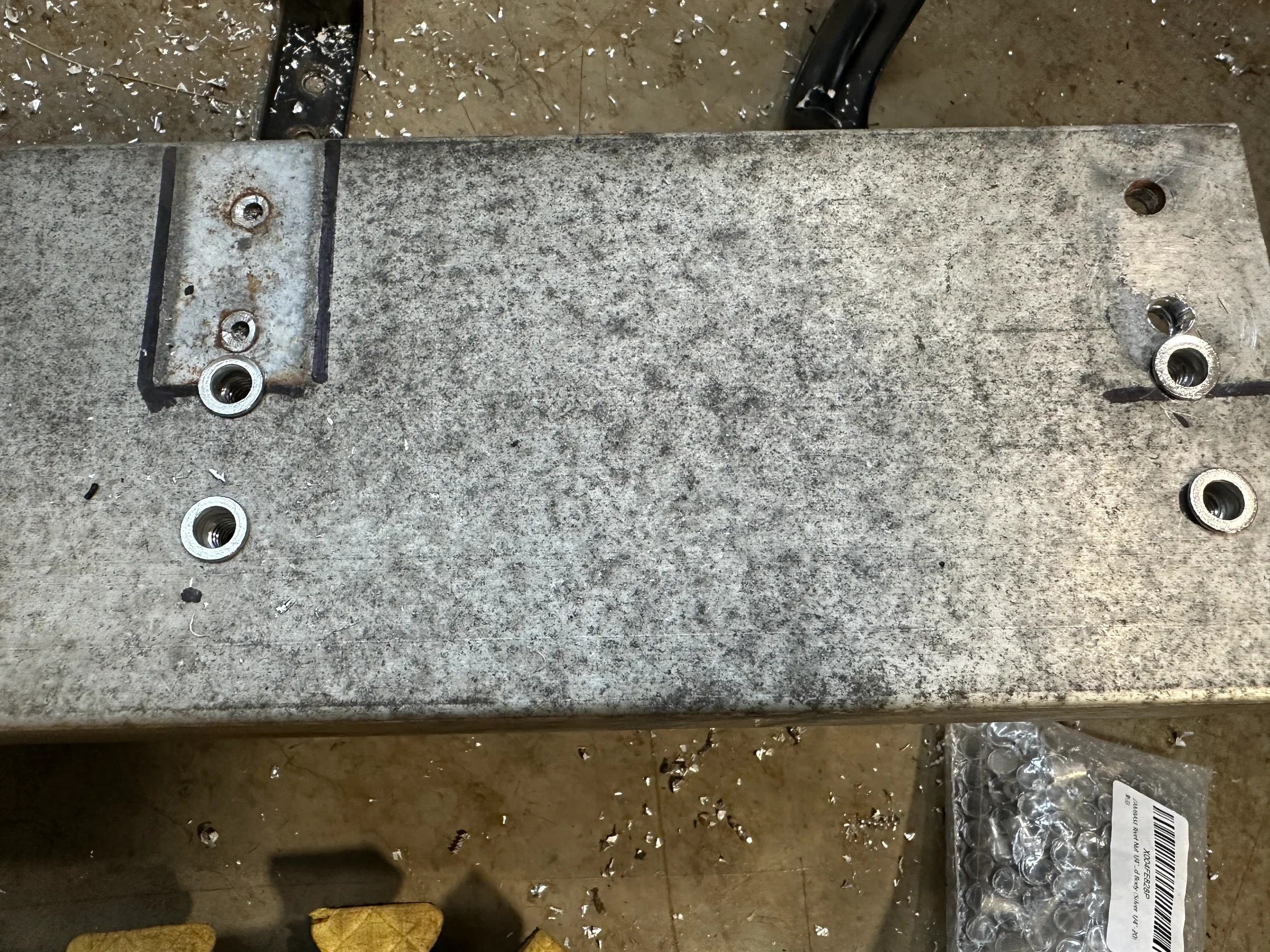

3) I removed the front aluminum crossmember to drill out all the riveted brackets and move them down 1.5". Exactly 1.5" down and you'll be drilling right into the center part of the channel, which doesn't work...broke one starter bit doing it. So, 1-1/4" or 1-3/4" is the better bet here to avoid drilling straight into the crossmember.

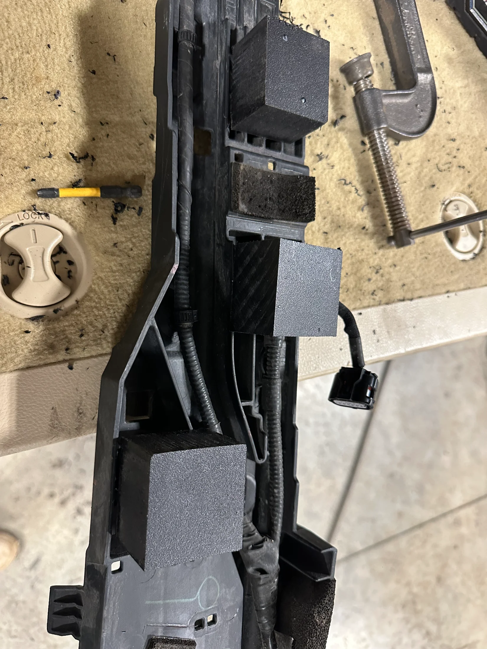

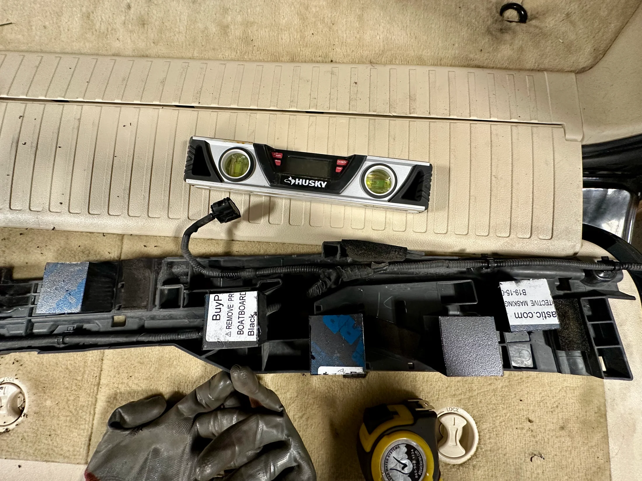

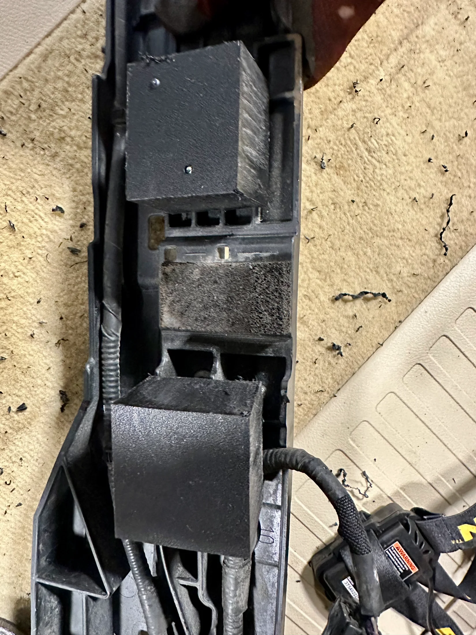

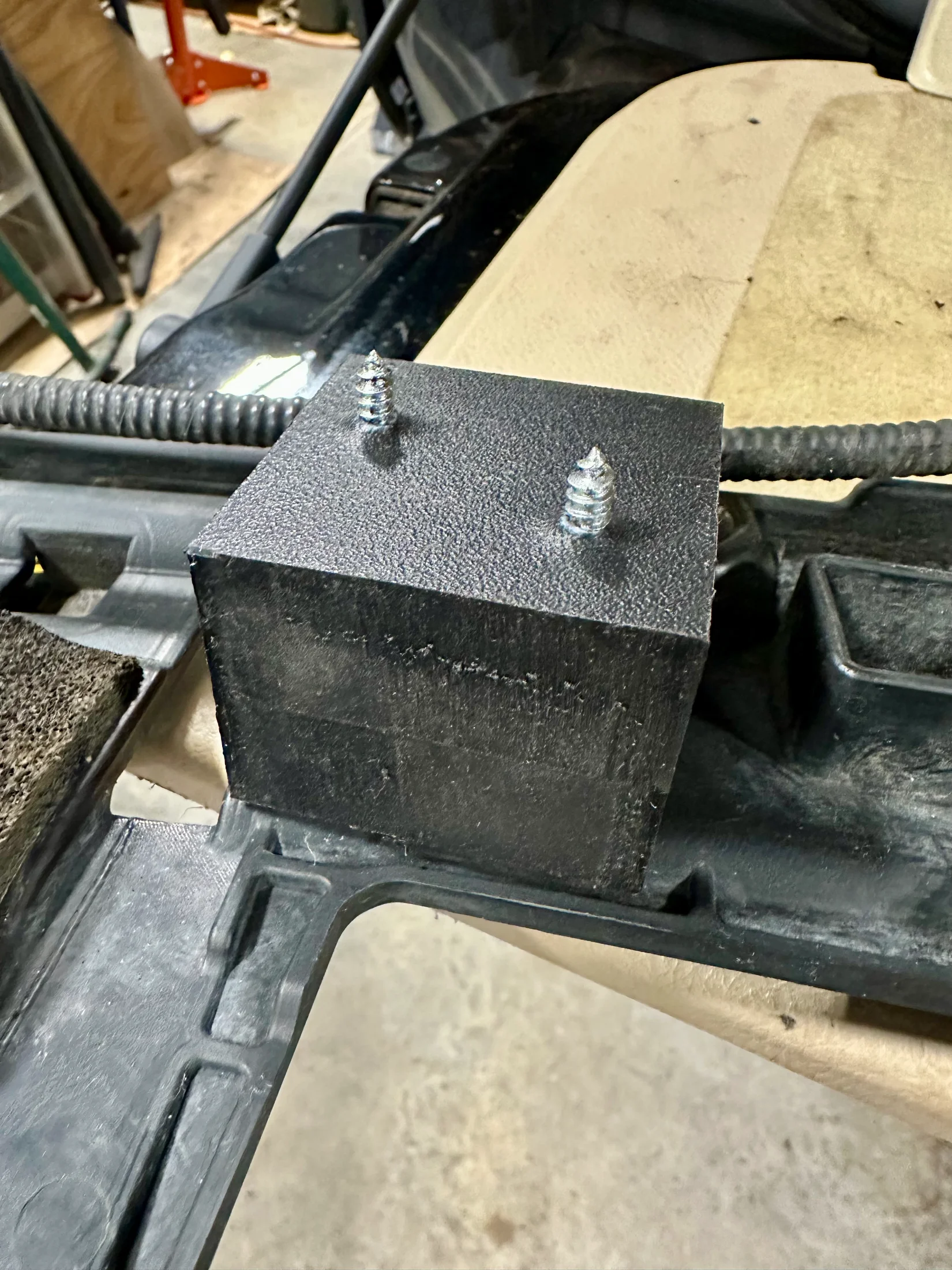

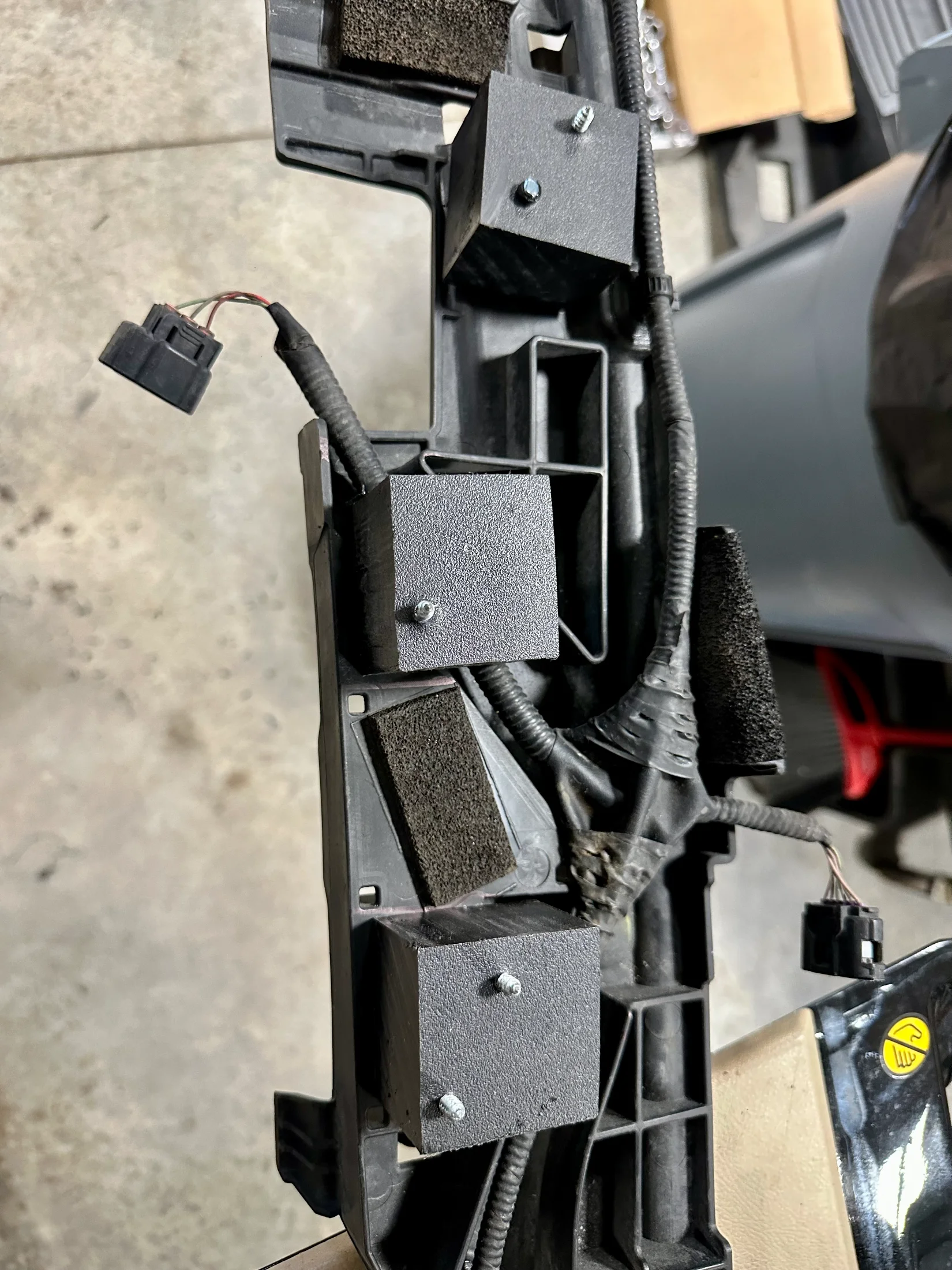

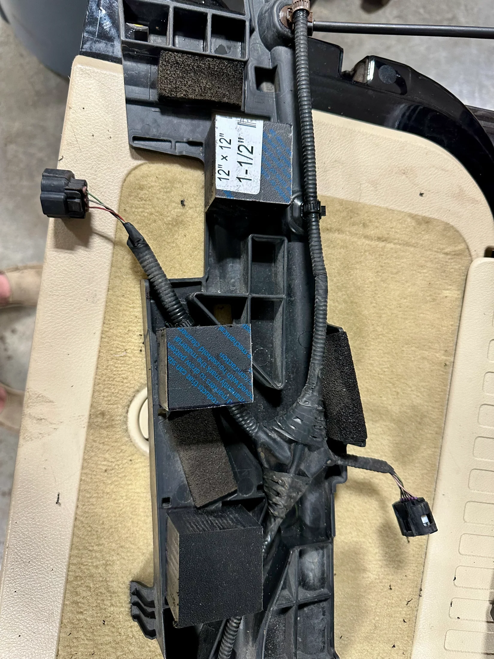

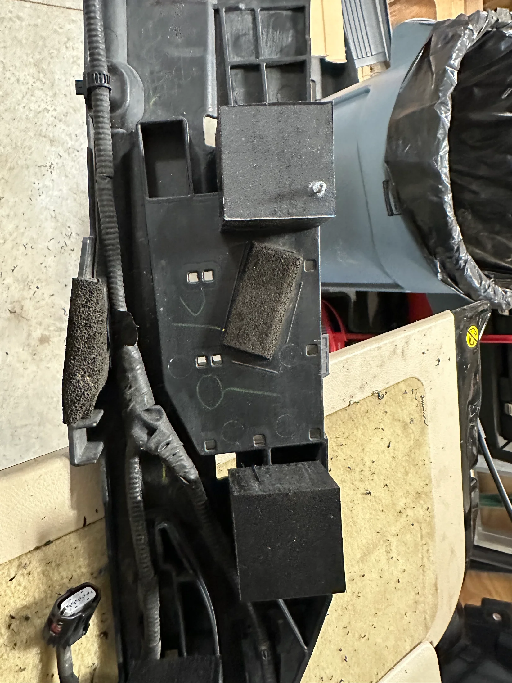

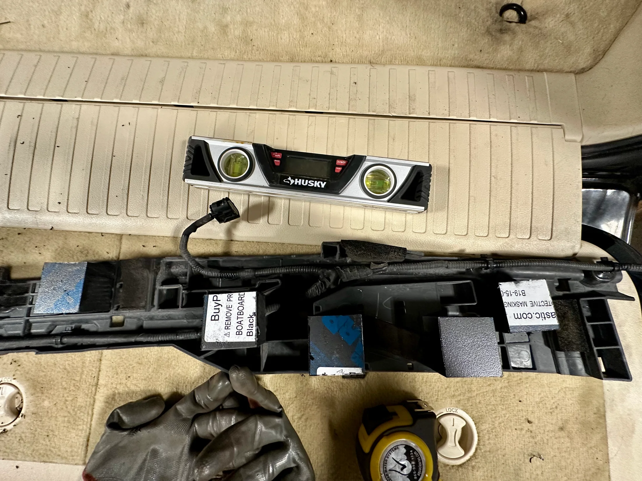

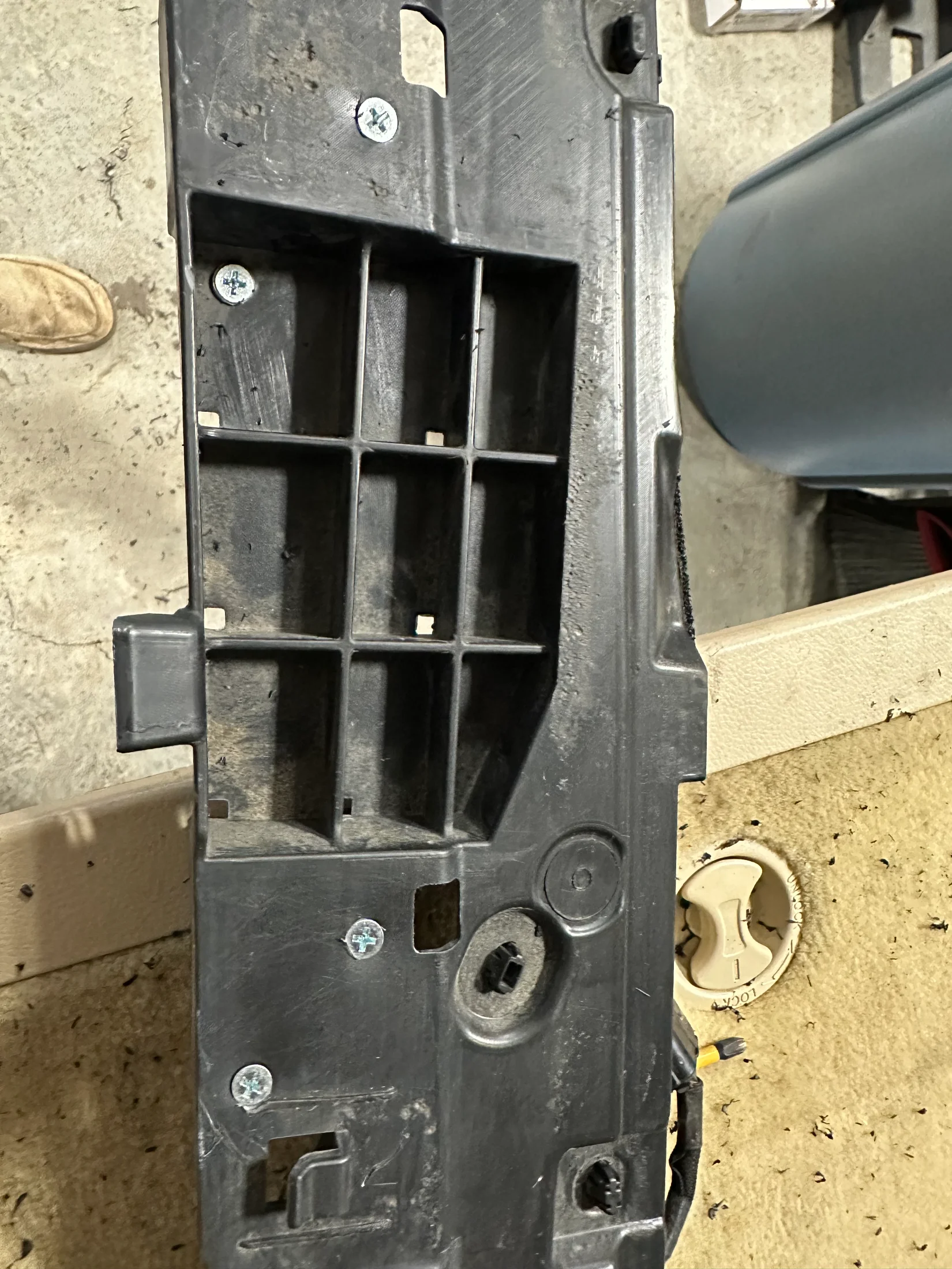

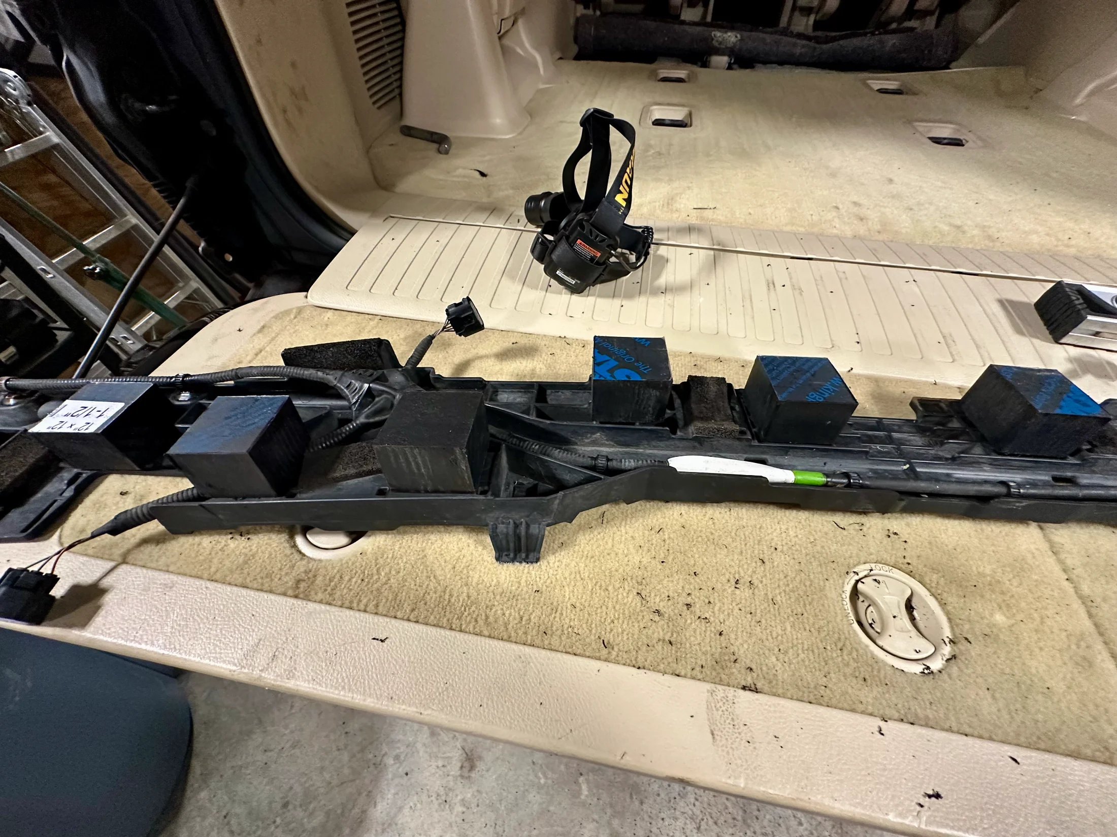

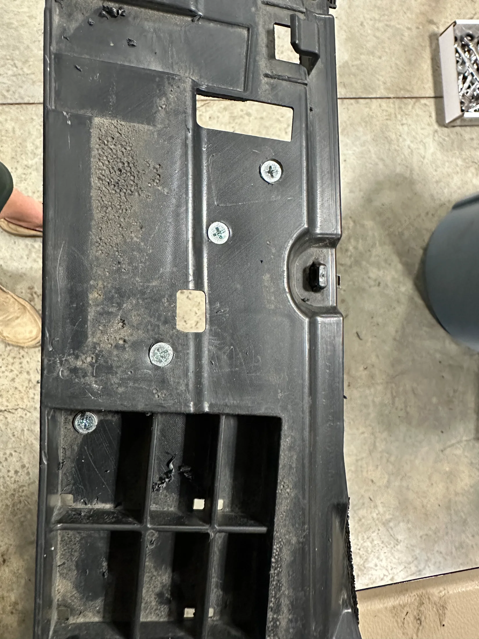

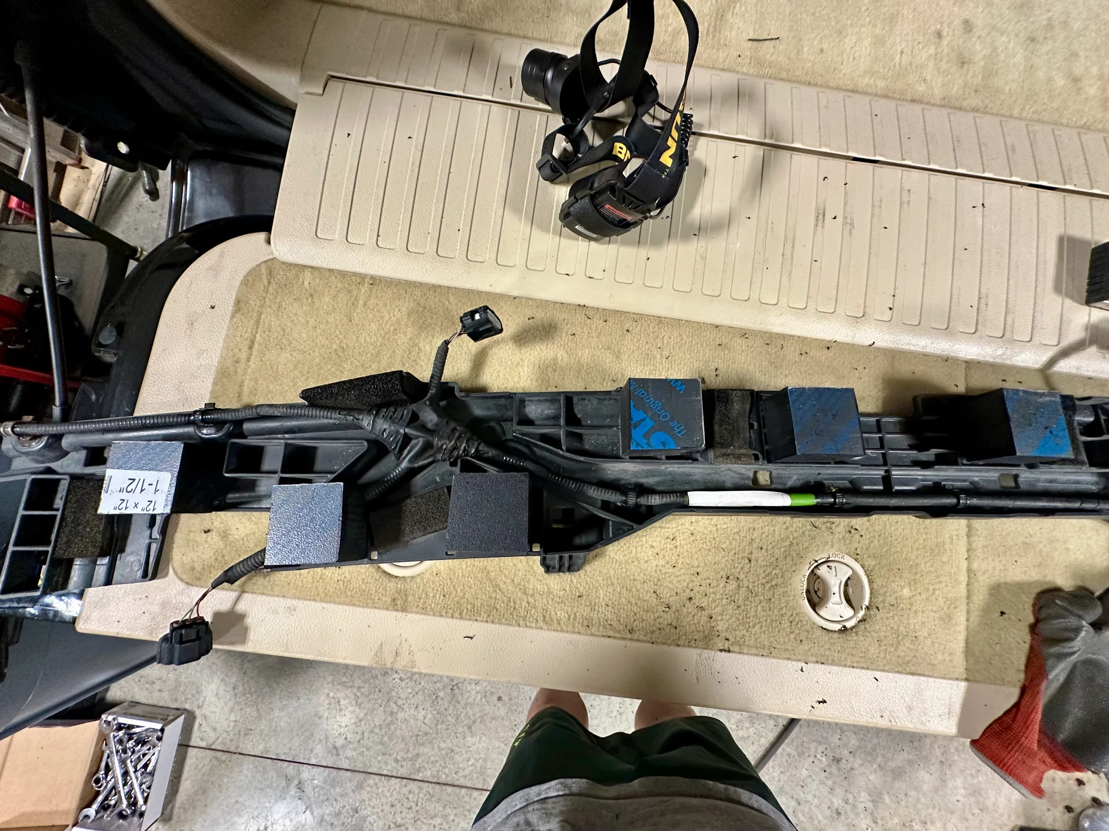

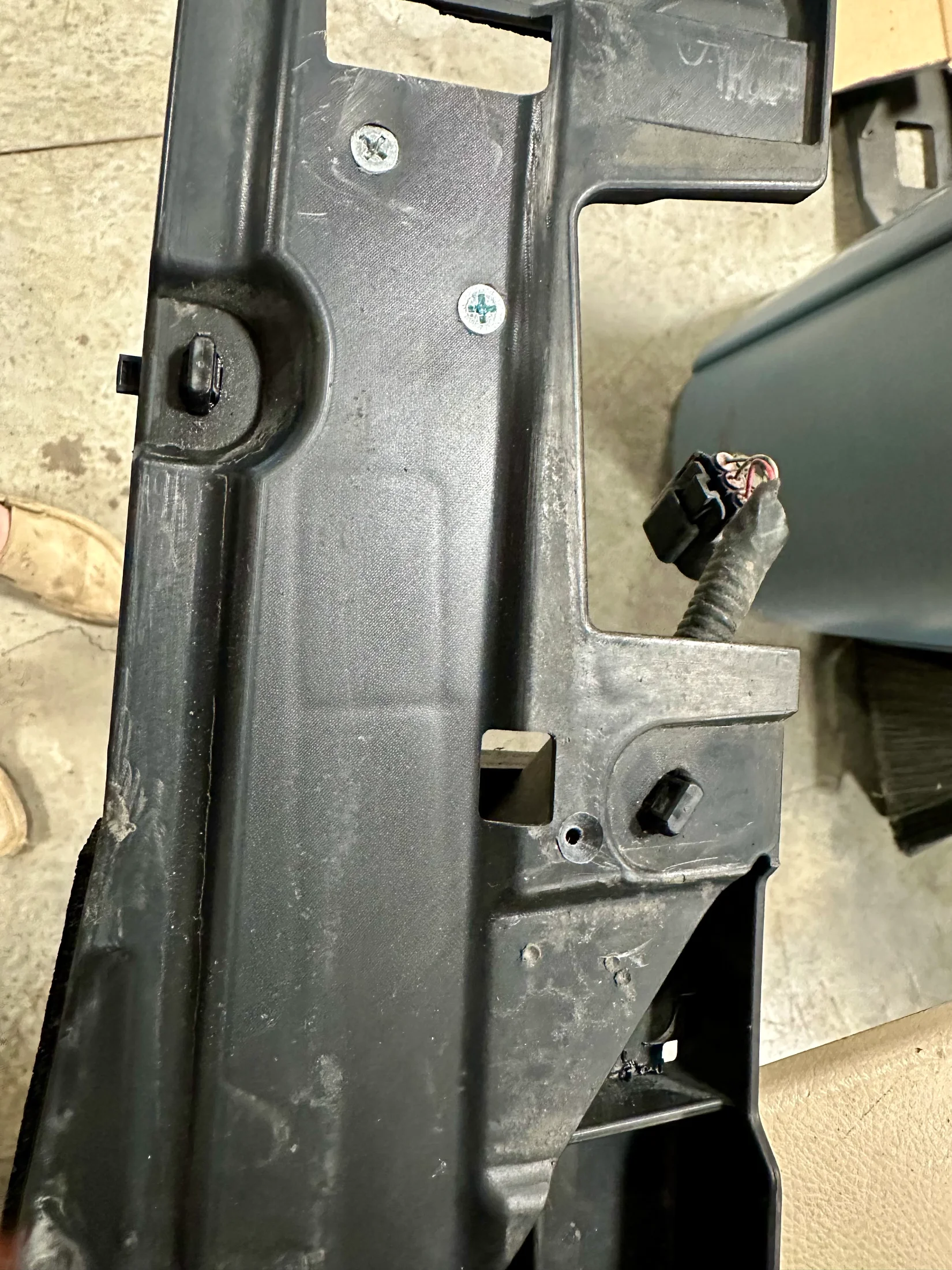

4) I bought 1.5" cutting board material off the link within NST's thread off Amazon. I cut them into 2" x 2" blocks and used tapered screws to attach them to the plastic piece of the bumper

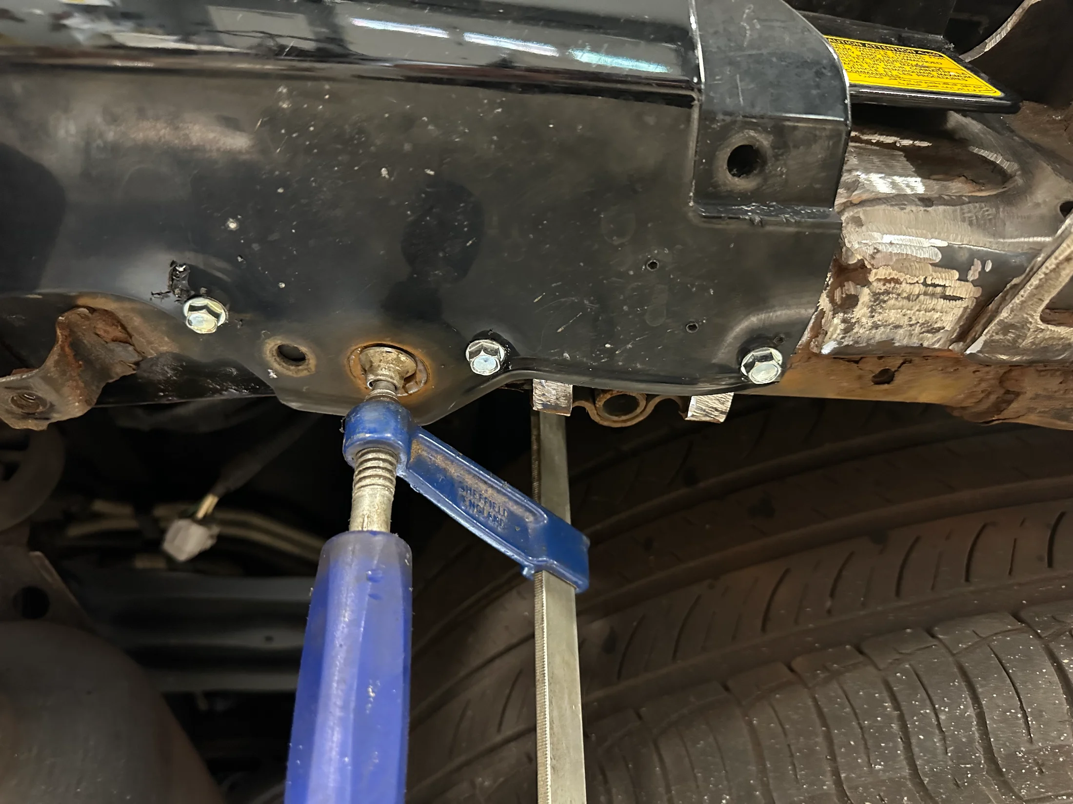

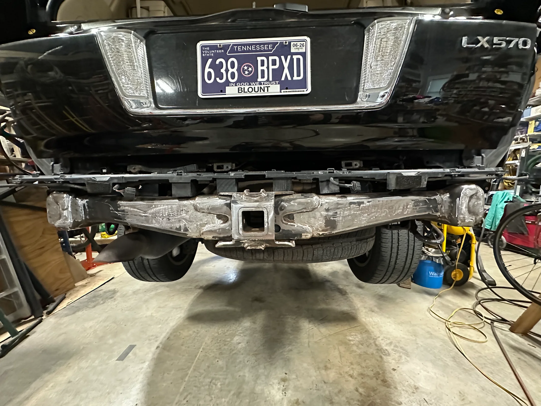

5) While I was working on the rear, I grinded down the majority of the bumper sub-frame, because of how rusty it was. It ended up pretty much being surface rust, brushed it off, wiped it down with Acetone, and then painted 2 coats of chassis paint. Before doing that, I mounted the bumper back up and put in 6 self tapping screws into the subframe through the underside of the bumper to keep it nice and tight to the chassis and not a great place to drag and scoop up rocks or mud.
Photo dump coming next few posts.
Chris
More photos...used a rivnut or rivet nut tool to install rivet nuts in the aluminum crossmember up front. I used 1/4-20 size rivet nuts and made the installation of the brackets easy. I also use locktite on all these, as well. That's it for now...We're on the home stretch now. I think all I have to do is paint the 6 self tappers in the rear before putting the rear bumper on, install the underside side covers front and rear and then figure out how to extend some of the wheelwell liners.
