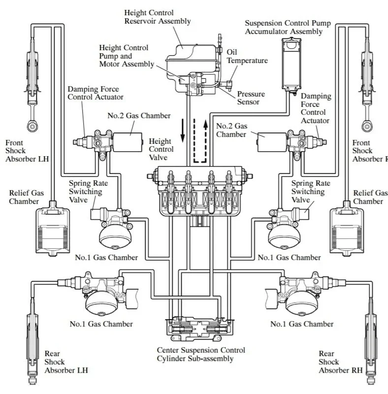

To the OP, this is troubling as I would expect based on the symptoms, that it is due to the globes. I still think it's the globes in some manner because it sounds like it's a compliance issue. Does the symptom only really show up when hitting a large/sharp bump?
It may be a deeper issue like the No.2 Gas Chamber along with the damping force actuator. Possible the fluid got contaminated and it's plugging some orifice?

I know we haven't seen one of these confirmed yet, but thoughts on the possibility of one of the relief gas chambers in the above diagram failing?
I believe they use the stainless steel bellows construction like in the KDSS accumulators so should be much more durable than the rubber diaphragm in the globes, but one side having significantly different spring rate than another could do all kinds of weird things.
But yes, panhard should definitely be looked at. Especially if things got worse after work on the rear axle.
