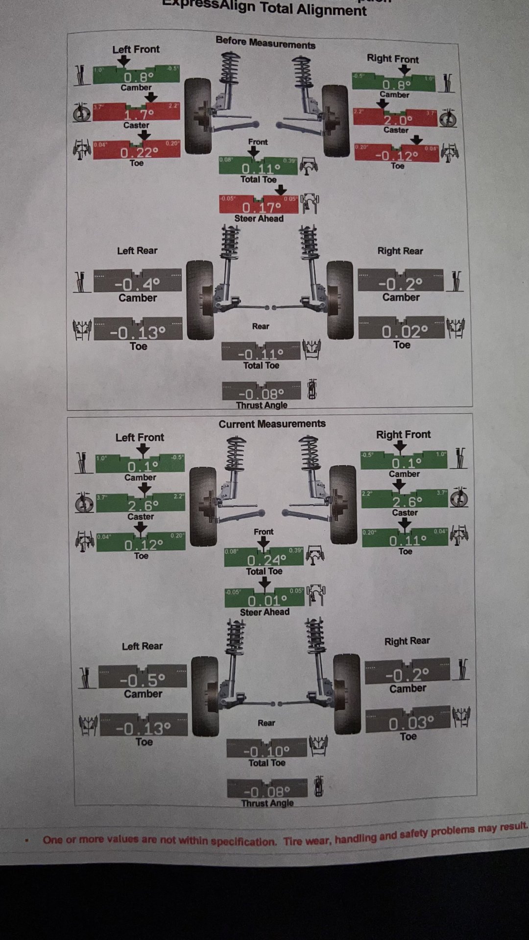

Aligned after 4 tries 13 LX570
Pretty sure you want slightly more caster on the passengers side to account for road crown, otherwise your steering wheel typically will be cocked left to about 11 oclock
camber should be easy to set and should be closer. If you have a lift a small amount of negative camber is ok, but if you don’t then camber should be set slightly positive. Also I can’t recall whether left or right side camber should be slightly more (right I think) but you want a tiny bit of cross-camber so if you fall asleep at the wheel the vehicle will eventually drift off the road to the right and not into oncoming traffic
Thanks @linuxgod and @njbrain. Seems like almost impossible to get a perfect alignment from a dealer. Previous alignment from different dealer drove great but pulled hard to left on crowned left lane highways. This alignment from different dealer eliminated the pulling but feels looser up front and slightly skittish over bumps. Worth taking it back for another shot?
I don't think that alignment will cause any drivability problems as a skittish feel isn't usually noticed till 0.5 degrees camber or higher. If you are a perfectionist as I am it might be worth another shot. The left rear cam needs to be nudged to the right, and the right front cam needs to be nudged right as well. Unfortunately most people on alignment racks don't know this. The adjustment cams are not mysterious. The rear cam adjusts camber and caster equally and opposite. The front cam adjusts equally and together.
You don't have much toe-in, so that may contribute to looseness and/or skittishness. You don't need much - typically you'd want 1/32 to 1/16" toe-in, which is maybe 0.08 deg?
Dealer alignments often just try to make things green and within those center detents in the graphics and then consider it good. The techs often don't really understand the subtleties of alignments. You might need to look for a serious alignment shop in your area, maybe one that does race cars, if you notice the handling difference and want it done "right"
Side note: I run about 3.7-3.8 degrees of caster - more positive caster helps steering feel tight and keeps the truck from wandering but it also makes the steering sometimes feel heavy... your 3 degrees should be fine there.

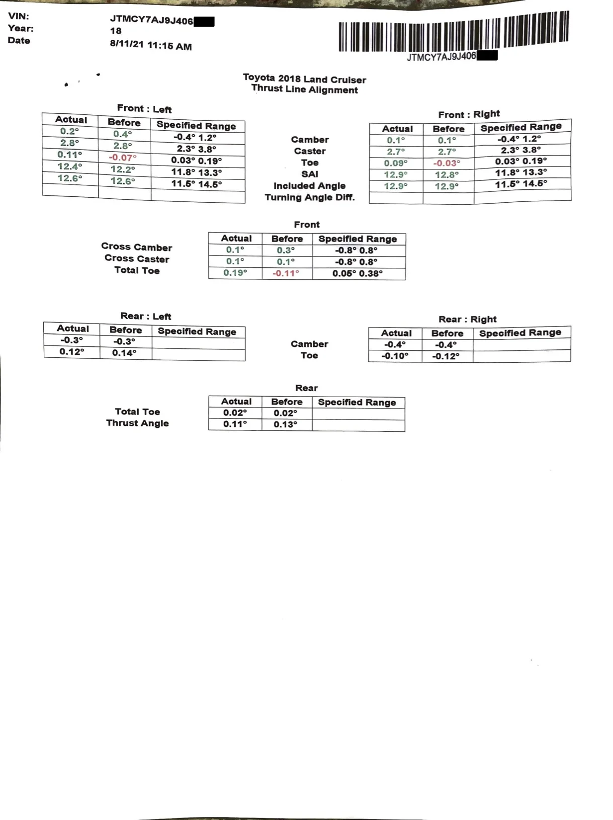

In any case, I took my LC in for an alignment this morning to a well-recommended local tire shop, and asked them to get to zero front camber. The initial response was they would try, but they wouldn't go outside of the range of whatever their alignment software indicated for my year/make/model/VIN. The end result: they said they did their best, but couldn't get all the way to zero camber. The report is printed below.
Interesting that (1) my toe was negative and therefore out of spec versus their "specified range" values in their software for my 2018 LC200, and (2) their "specified range" for camber was/is -0.4 to +1.2 degrees. I thought the lowest camber figure from Toyota was zero, rather than -0.4 degrees. Do these recommended ranges, and/or the end values, look blatantly wrong to anyone?
Maybe the wrong toe settings were causing some of my uneasiness and understeer when loaded?
I've only driven the LC about 5 miles since, and not on the highway yet, so too early to give any kind of seat of the pants report.
Your final specs look pretty good to me, as do their specified ranges, at least for my 2013.
Keep in mind when they do an alignment, they really need to roll the truck off the rack and then back onto it to ensure the components aren't binding up and everything is "static". Very few shops do this so it's typical that your final numbers can vary a little from whatever was originally set. I'm surprised toe was slightly negative but given how far off camber was previously (left-to-right) I'm not shocked something was off

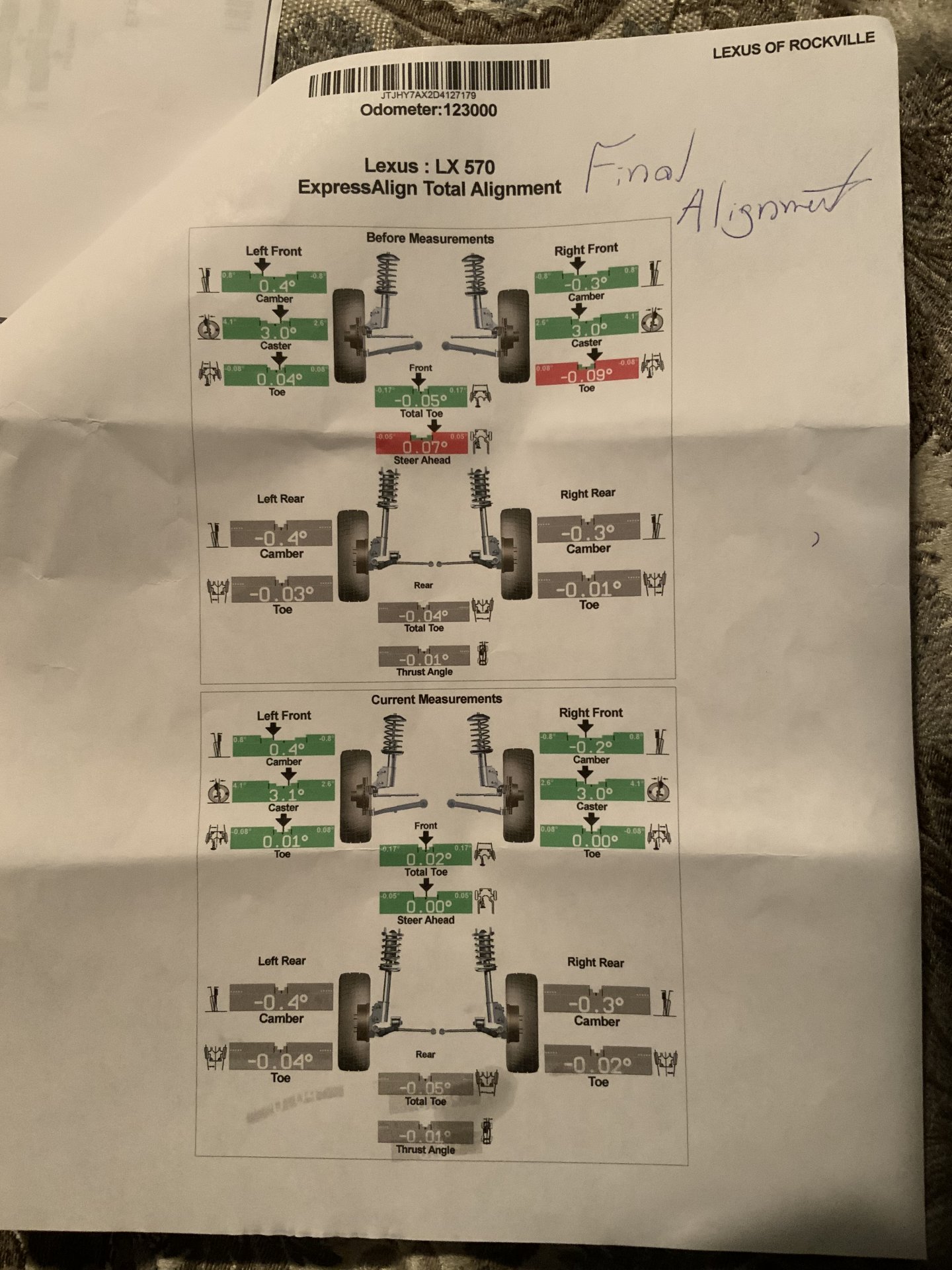

Nice. Those settings should be pretty good.
Typically shops set up a small bit of cross-caster and cross-camber to account for the road crown. Cross-caster is so you don't feel like you're always holding the wheel at 11 o'clock to go straight, but how much (or whether to bother) depends on how the local roads are built and not every shop does this. Cross-camber IIRC is so if you fall asleep at the wheel you will slowly drift to the right shoulder instead of into incoming traffic.
If you feel like you still wander on the highway at all, or that you need to continually make minor adjustments to keep in your lane, you can push caster a full degree more and still be within spec. I run at 3.8 deg (which is a hair over spec) and I can drive down the highway hands-off the wheel. Note that very high caster will wear the edges of the tires a bit more when turning, and you eventually risk contact with the KDSS arm and sway bar once you run 34"+ tires, but it's an option.
