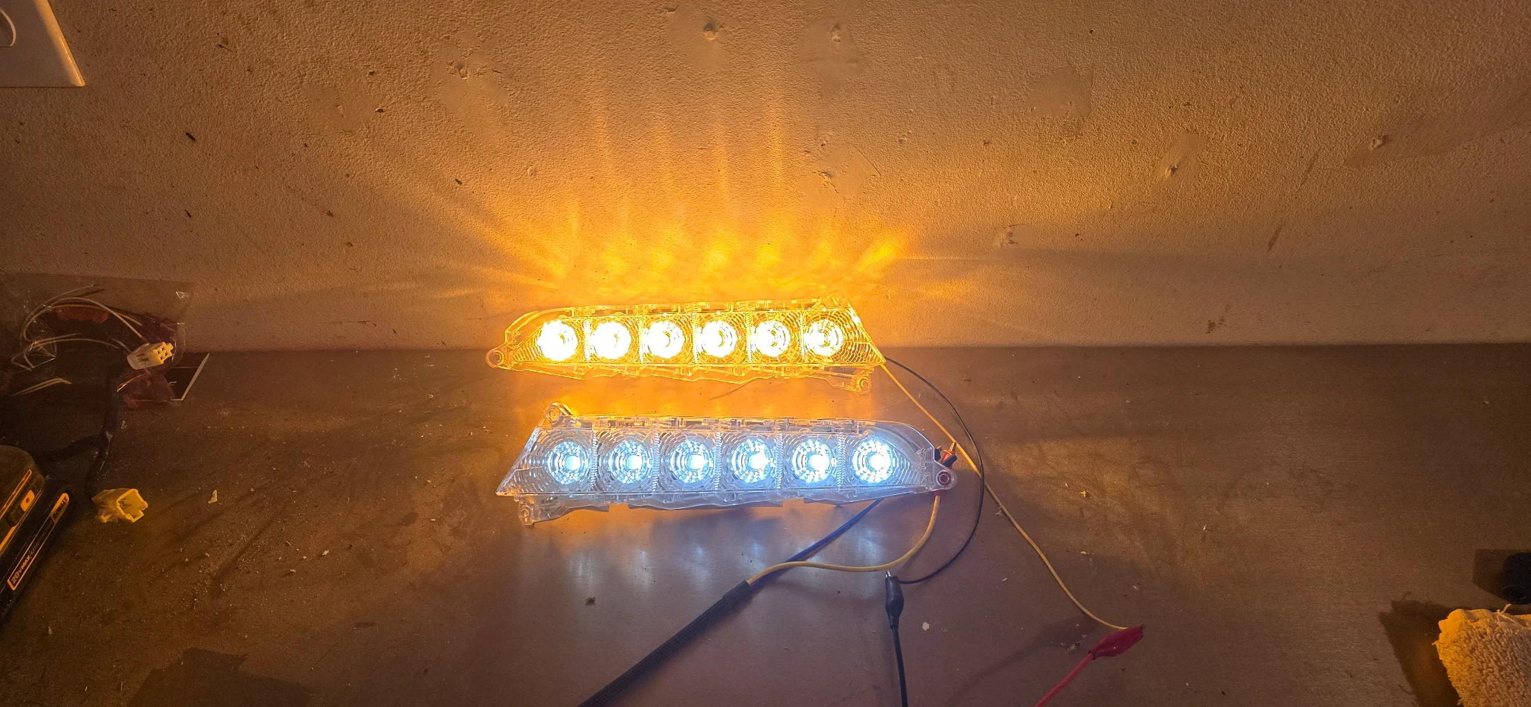

I can, been messing with quite a few LCs lately, have an extra set of 13-15 waiting to be built so I javent modeled up the drl replacements just yet but similar idea to the LCs. You could choose from white or amber if you had them replaced.
Unfortunately I dont know of anybody else messing with lexus/200 series drls. IG @rigid_retrofits_llc
whats the down time and what do you charge?
Ill need to get my extra set open to properly gauge that first. Sometimes I need to design and print an adapter to hold the led chips and sometimes I dont. Shoot me a DM so I dont lose ya but ill get you more info when I get my 13-15s opened up.
