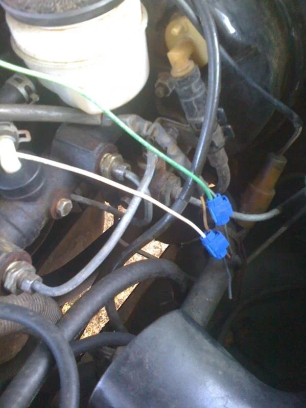

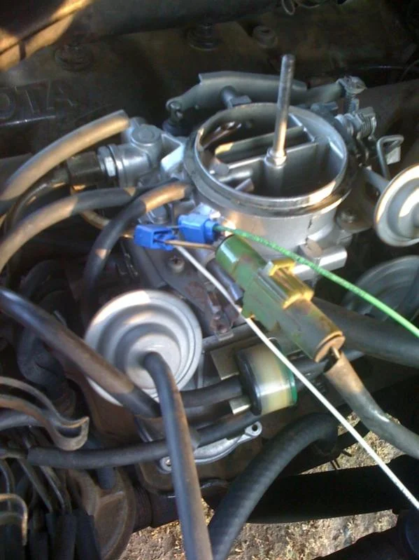

Is your truck completely de-smogged ? If so, jim told me that with a de-smogged system that the ground from the selenoid plug should be put to a constent ground... the way it is wired from the factory the ground goes to the computer and it gets a pulse ground... i don't remember wire colors, but if remember when i get home from work tonight i will post a pic of how i grounded mine...
This fixed the ruff idle and a tendency to studder at about 2200 rpm on my 60...
on a side note... You will probably not get a response from jim till next week sometime... he is part of a rally car team also and i know they have a race this weekend...
:cheers:
