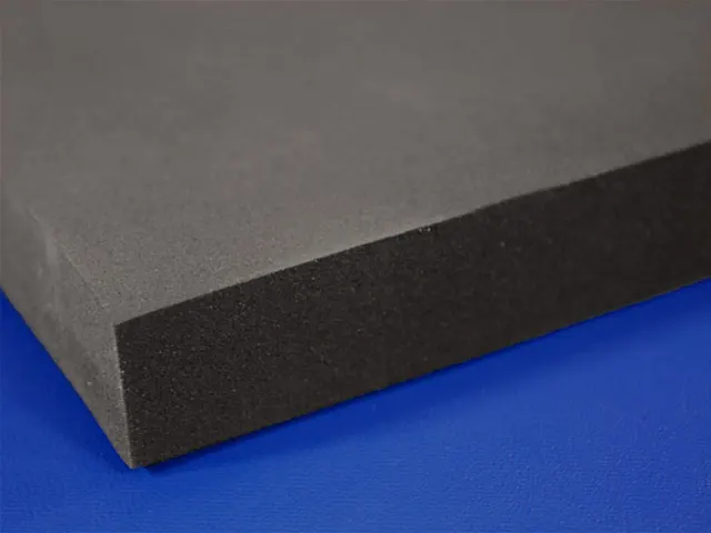

For ceiling under headliner it's only two items needed:
1. CDl tiles like this Sound Deadener Showdown | Your Vehicle Quiet
can order equiv from here Kno Knoise - Kolossus Edition Sound Deadener
Lots of other options just to deaden the metal.
2. then Hydrophobic Melamine Foam adhered with hot glue gun. Products | Sound Deadener Showdown
equiv product here Amazon product ASIN B01N2497HN
That's it.

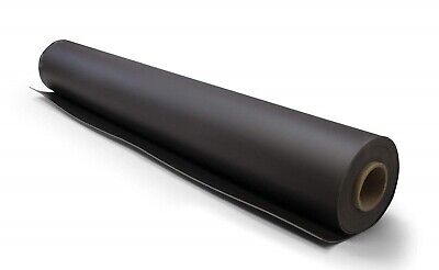

I've thought about trying this but it's heavy and won't be easy to adhere. My son used it as an underlaying in 89 pickup and was effective with MLV.
Amazon product ASIN B008NF84J8
As far as MLV - I'd only use that for floors and doors and get one that doesn't offgas. It's heavy so not sure it would work well in ceiling. Most of the sound comes from below, firewall, doors and windshield
