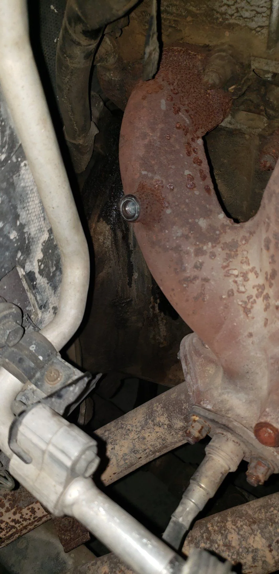

Head gasket leaking, decision time.
Here is a pic of the coolant leaking down the bell housing

I have already replaced every hose. And the only other line in the picture is the rear heater line which is bypassed. I really hope you guys are right but it doesn't appear to be a hose or line. It's dry from the bottom of the head up and wet from the bottom of the head down with red coolant. It's directly behind the block running down the top of the transmission. Either way I will mess with it more over the next few weeks. I do still have one silicone line going to the heater valve. Doesn't look to be leaking but it's worth replacing to see if it is the culprit. Might get a scope back there or a mirror.
Have seen that leak, was the rear of the head gasket, leaking externally. Pressure tester and small inspection mirror, scope found/confirmed it. Not a great place to access, see!
The head gasket on my '95 had leaked externally by 75K miles when I bought it. The good news is that it never leaked again or got any worse by 250K miles.

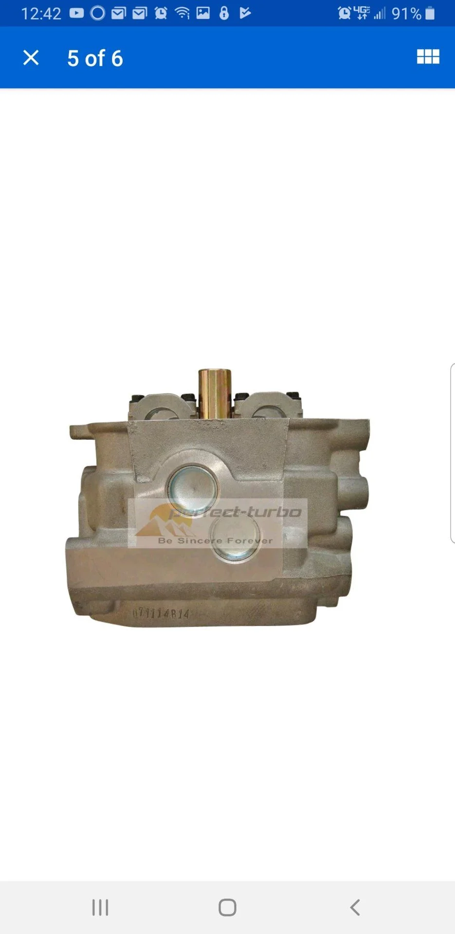

There is a freeze plug at the rear of the head that leaks and drips all over the tranny so you might be in the clear. If you search under my name, you'll see a pic of my '97 leaking. If you find it, please post up here for others to see. I'm just too lazy!
Can't find your photo but it looks like this. Gotta pull the head either way.
Yup, that's it and yup, it sucks balls to get to it any other way. Mine was seeping for years and had toyota red dried up goop all over it. I believe this part is NLA so I just used some sort of loctite liquid and pressed it back in after the head returned from the valve job.
