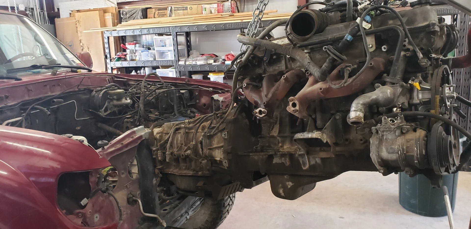

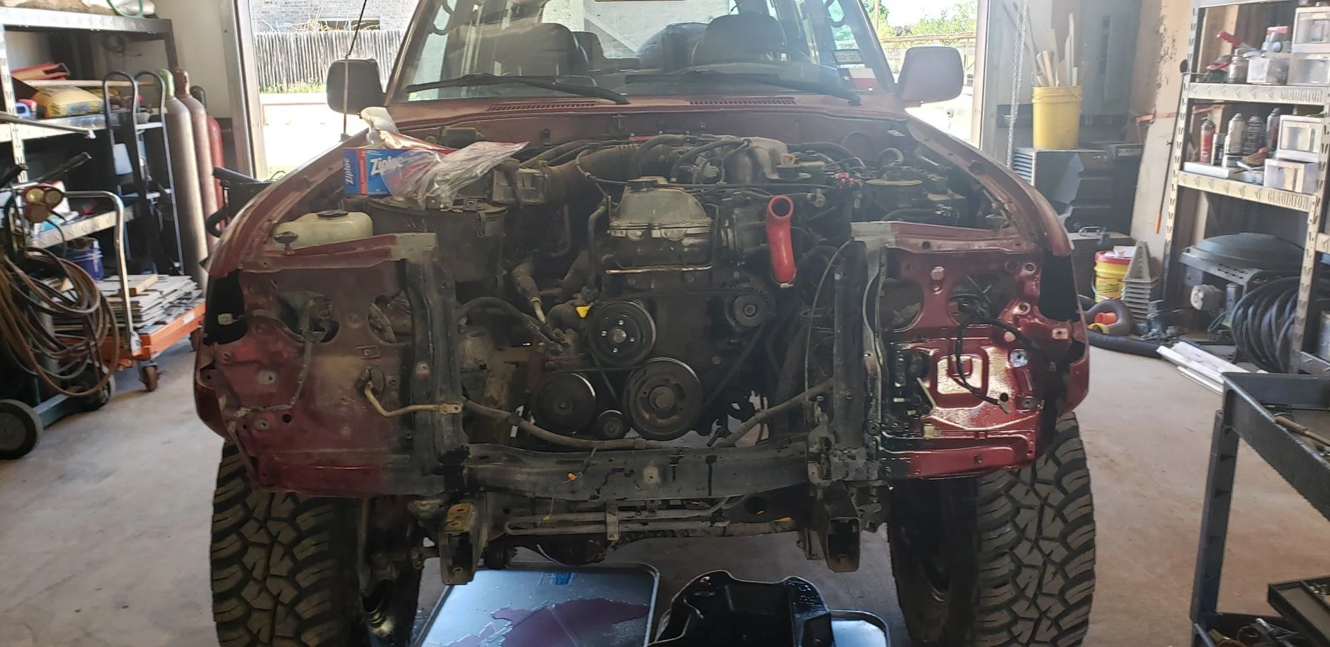

Gonna pull the engine anyways and at minimum machine the head and replace all seals and gaskets. May do full rebuild depending what I find.

Local machine shop quoted me 2750 for full rebuild. I purchased the ishino stone head gasket kit and Toyota head bolts. Machine shop will source the rest. I will get prices on the transmission tomorrow. I'm sure I could just get a head job done and save a ton of money but I plan on keeping this thing forever so I might as well just do it right once and be done.
